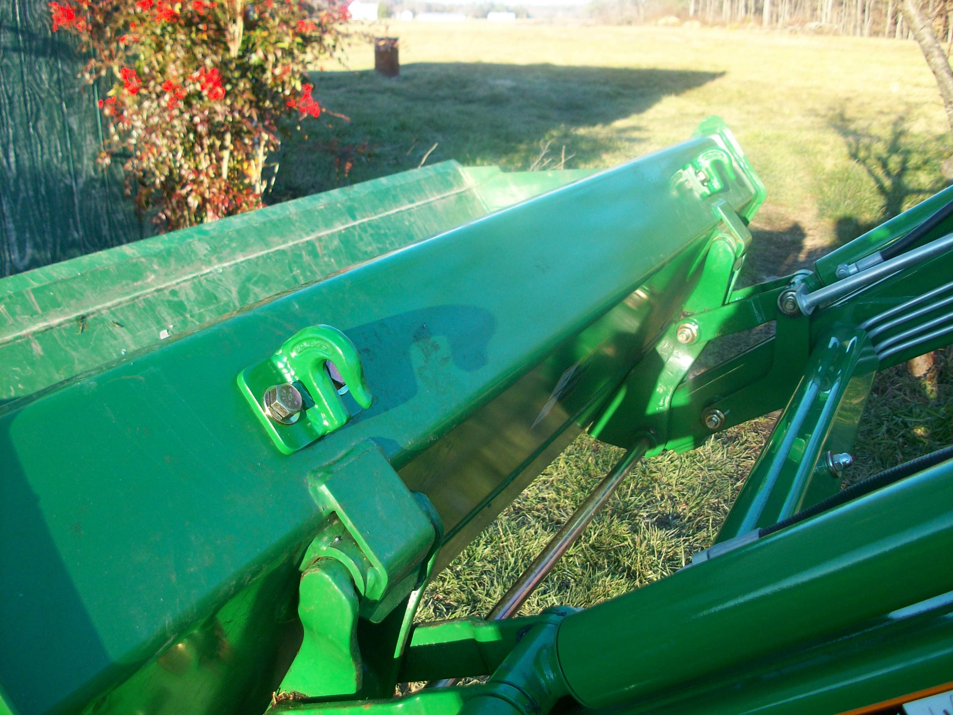

I got Ken's Bolt on Hooks last week and installed them. They really are a great product, glad I got them.
Now I'm ready for some chains for lifting.
I know a lot of variables go into it as far as the job you're doing but I'm just checking to see what is a good average length you guys are using.
I plan on getting 5/16 grade 43 chain with a slip hook on one end at Lowes this week.

I use chains with grab hooks. That way I can make it as short or as long as I need. No need for a slew of short chains. Just a few long ones.
And it looks like (I could be wrong) those are 1/2" grab hooks on your bucket.
Grab hooks only work well if you use the size chain they are made for or up one size or down one size.
If those are indeed 1/2" hooks, 5/16 chain you plan on buying is down 2 sizes. And I wouldnt tust a 1/2" grab hook on 5/16 chain. But thats just me. If it were mine, I'd buy 3/8 chain. Overkill....yes, but better than a 5/16" chain slipping or getting messed up.
If I am wrong and those are 3/8 hooks, then 5/16 chain will work just fine.

5/16 Grade 70 from Ken's Bolt on Grab Hooks

LHS Inc - Did you drill holes in your FEL to mount the hooks? If so, how did you go about drilling them? Thanks.
Yes drilled the holes with a cordless drill on one charge. Clamped them down marked the holes and removed them. Drilled with a 1/4 inch bit for the pilot hole then 1/2 inch bit to finish.
I took my time so it probably took me about 30 minutes to get it done start to finish, the great instructions made it very easy.
