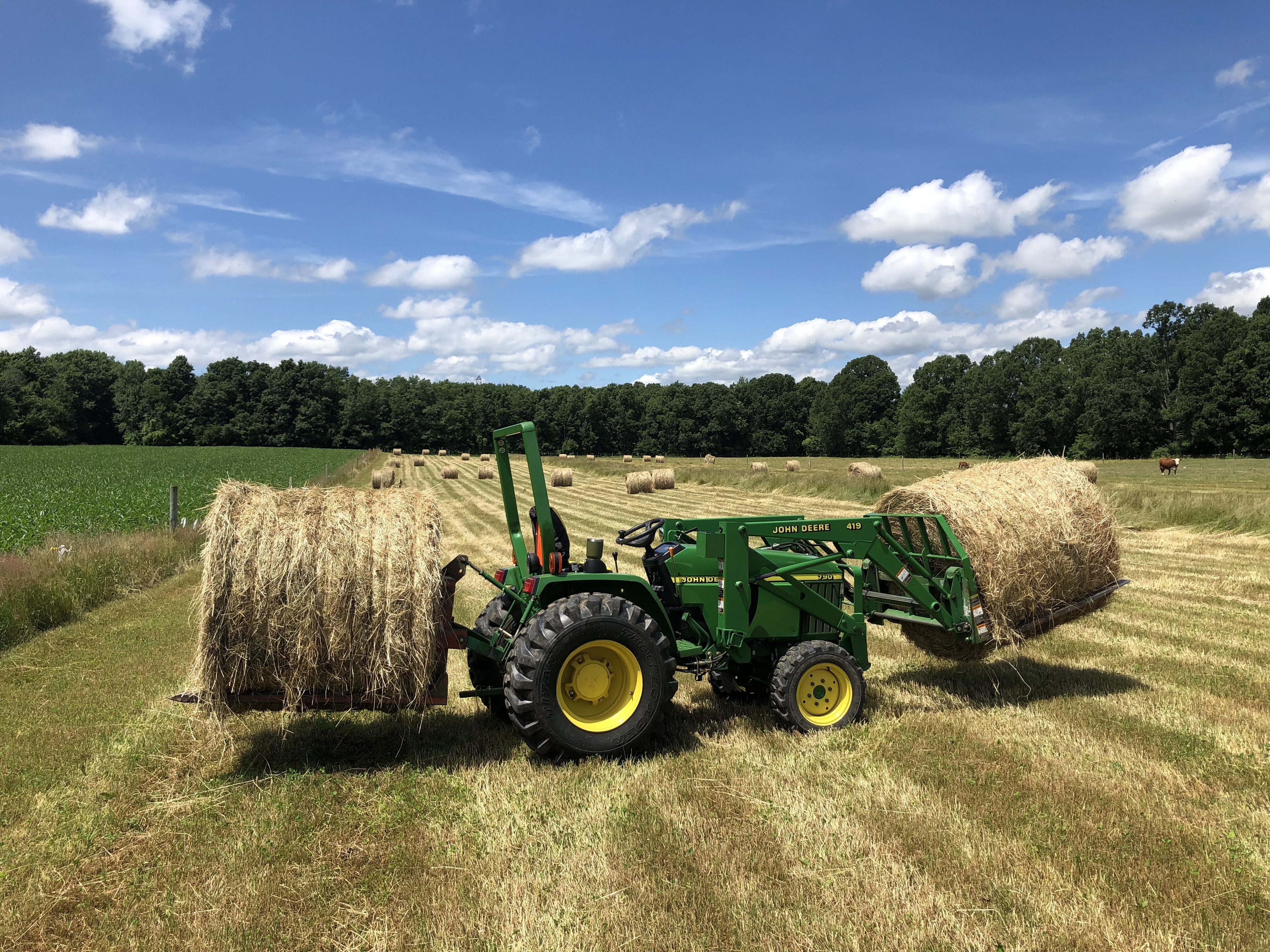

Forks or Bale spear is what you will need to life them. Bale spear is my preferred so you don't not break Twine or net wrap. 3032 should life them with proper ballast as stated above.
I am able to lift them with my 790 if I have to.
