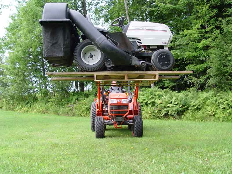

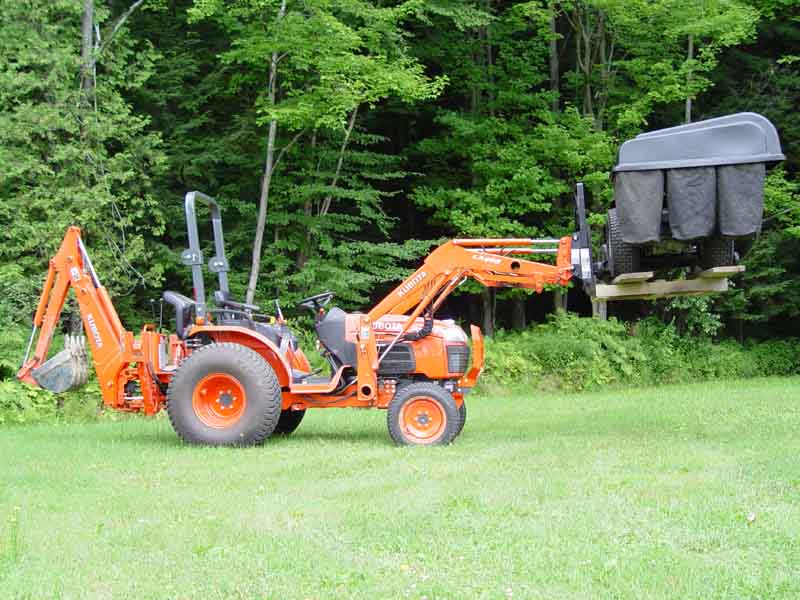

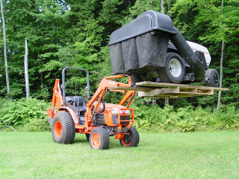

/ Lifting 900lb. generators - attachments? #6
To give you a good idea of what a B3030 can do I have 3 pics for you. The tractor in the air weighs around 810 lbs and my B3030 couldn't lift it more than that (as you can see on the last pic, the weight is far ahead from the pivot pins).
So... a B3030 couldn't able to do the job. Probably a L3130 with "turf tires". This is very important because of the weight on the front axle. With R1 or R4 you'll damage the lawn for sure.

/ Lifting 900lb. generators - attachments? #7
pic #2

/ Lifting 900lb. generators - attachments? #8
The last one
