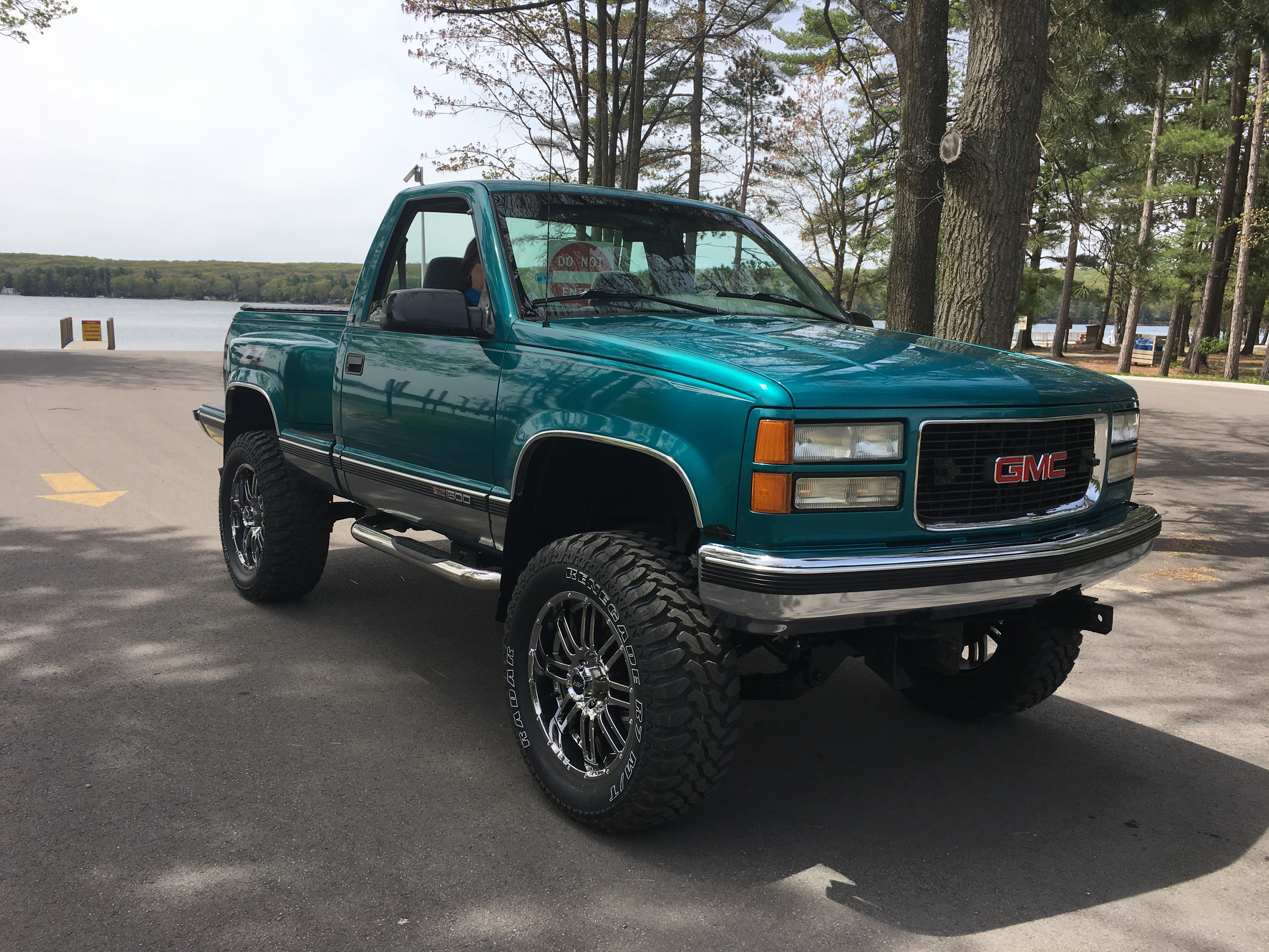

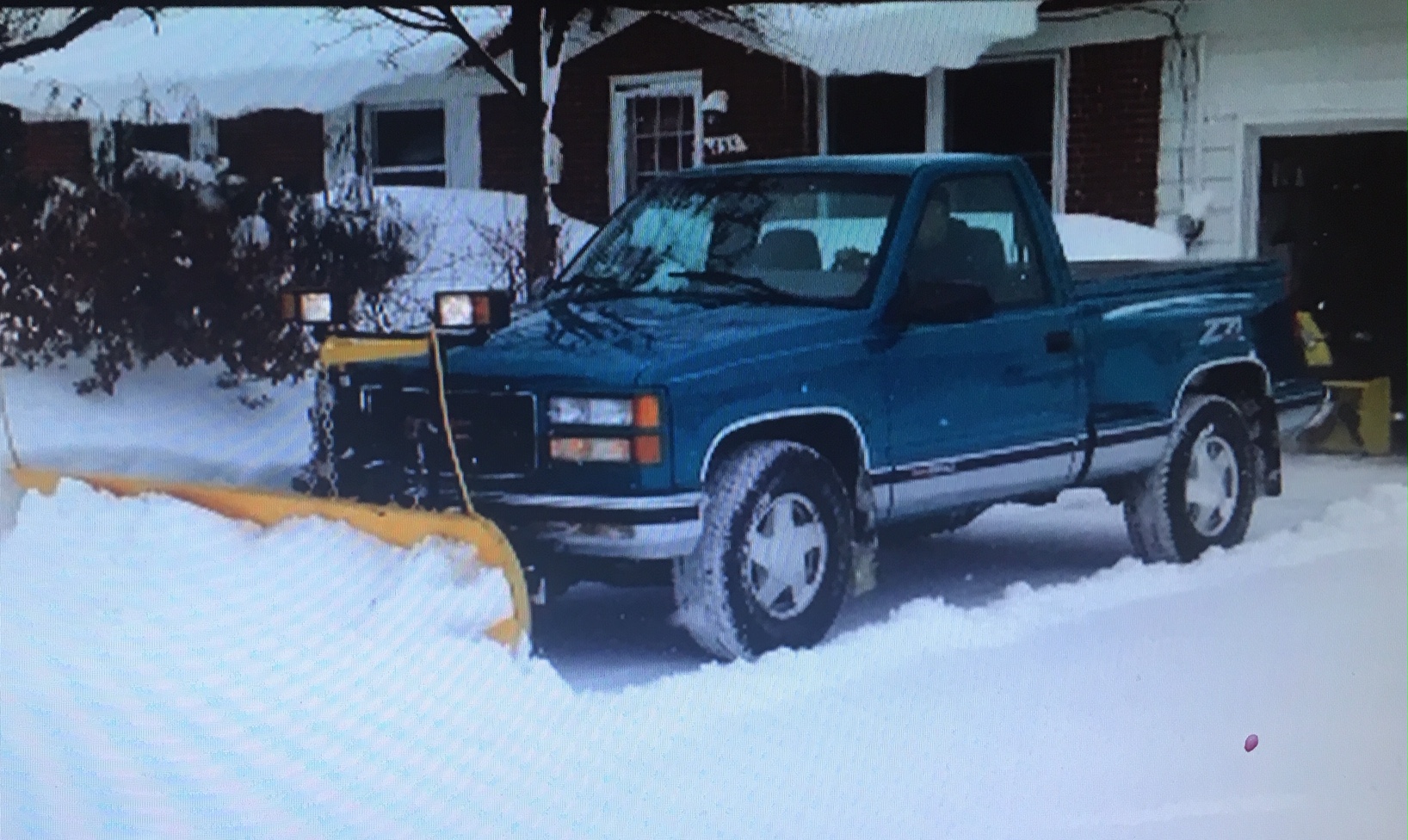

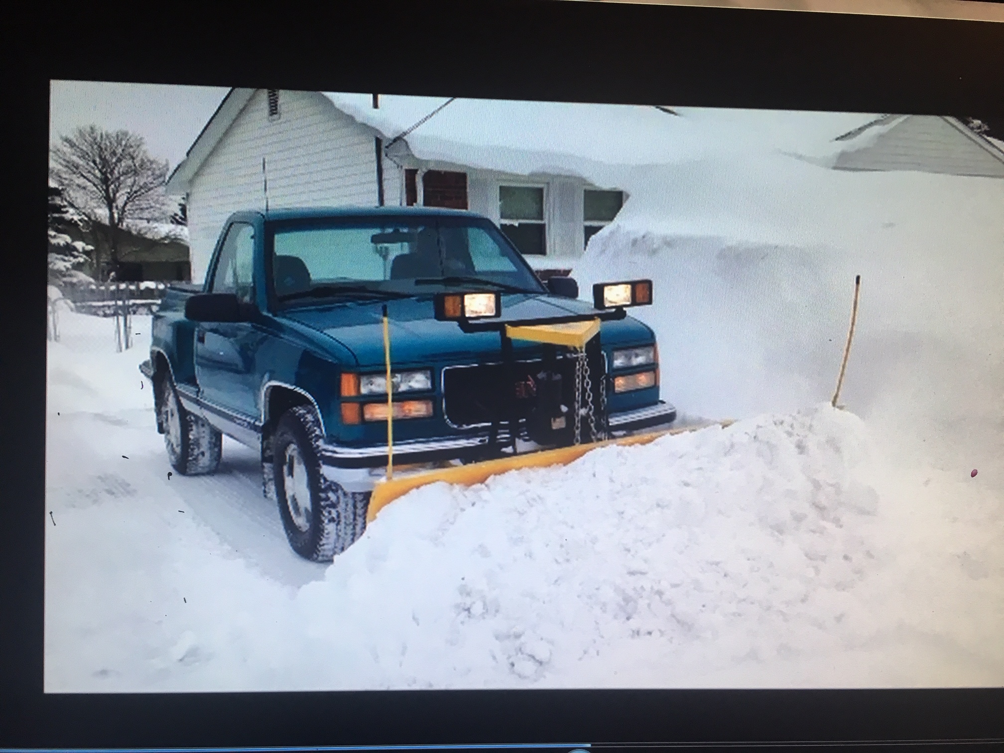

One of my first 2019 welding projects will be adaptors for my old 1996 GMC pickup. I bought it new and it only has 34,000 miles. I store it winters but feel it is time to enjoy it year round. I store my new gmc truck to keep it salt free. As I age those below zero blizzard days on the tractor with no cab get not so nice, lol. So how nice it would be to have the truck to hop in and pull out to clean the driveway with. Just doing my driveway it would work just fine. The mini loader has a cab and most times the little tractor is fine. But this would be a fun project and practical at the same time. truck1.JPGtruck2.JPGtruck3.jpg

We have many lifted trucks running around our town with big mud tires. The guys say they do fine. Two of them have plows and say they work fine. My plan is to keep the blade frame level and build lowering brackets like several people are selling now . I would rather build my own than pay double for them . Just to plow my own driveway it will work great.
