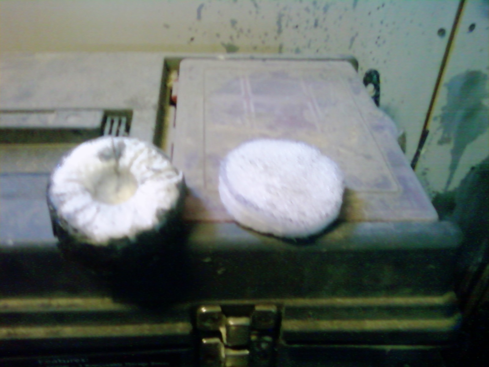

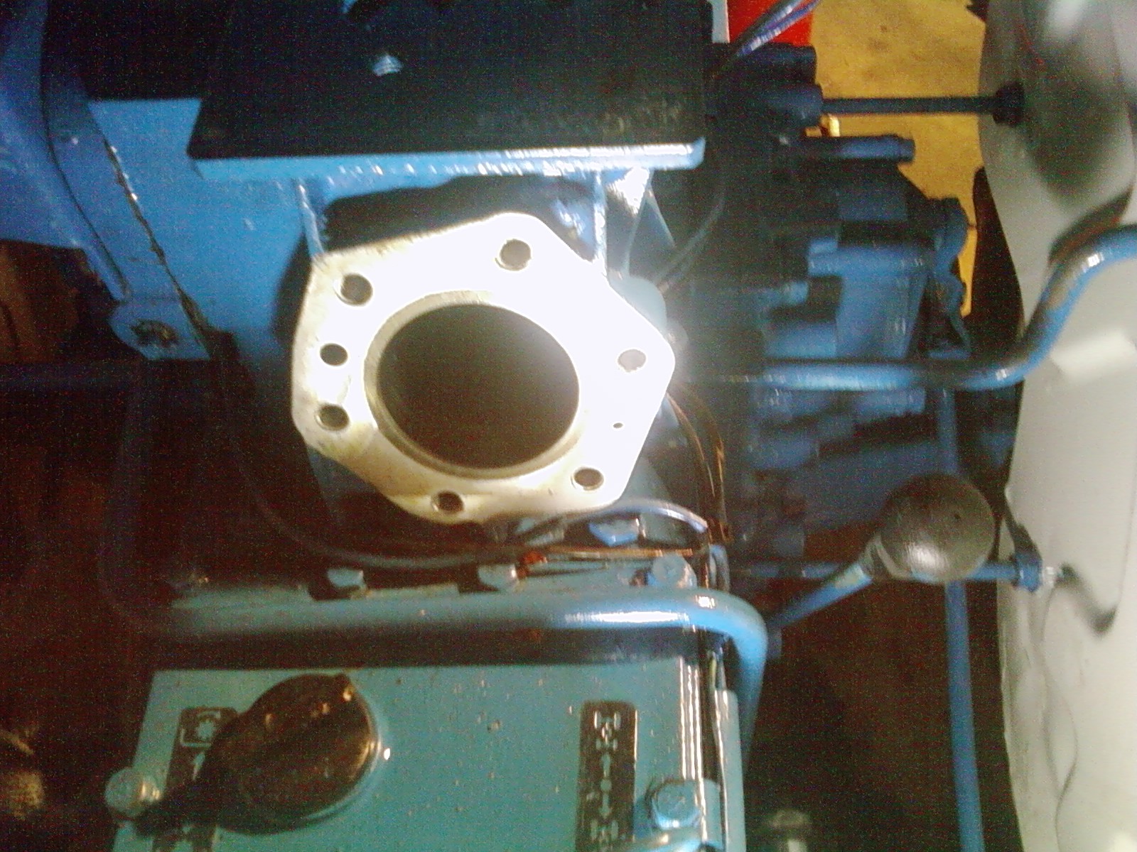

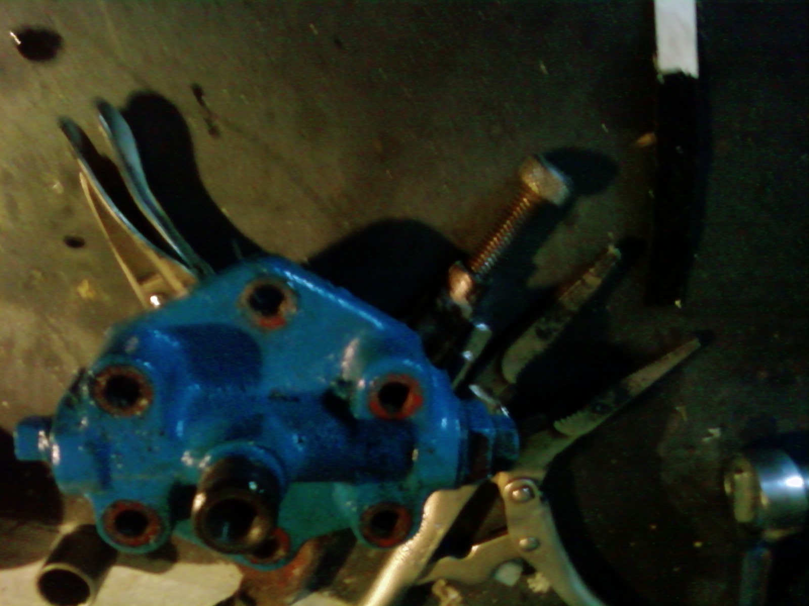

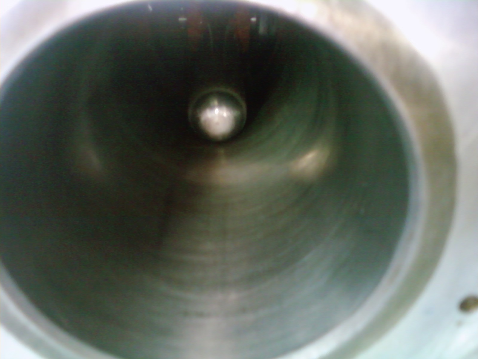

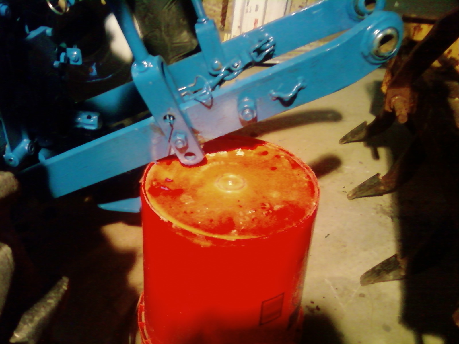

I did the seal on my 1100 about 3 years ago. Very, very similar machine. Easy job the parachute seal was ~$40 at NH. You just remove the plate that the speed control valve (knob) is attached to and the piston will come right out. It is a floating ball joint- no wrist pin. I stuffed some foam blocks in the cylinder so I could clean and hone it. Pics: This photo shows the lift flow control valve removed
Cylinder view from above
Cylinder before honing
cylinder after honing
Foam plugs. they should fit tight. Top one sides coated with moly. Bottom one coated with mineral oil
Prop arms up to keep push rod down out of way for honing
