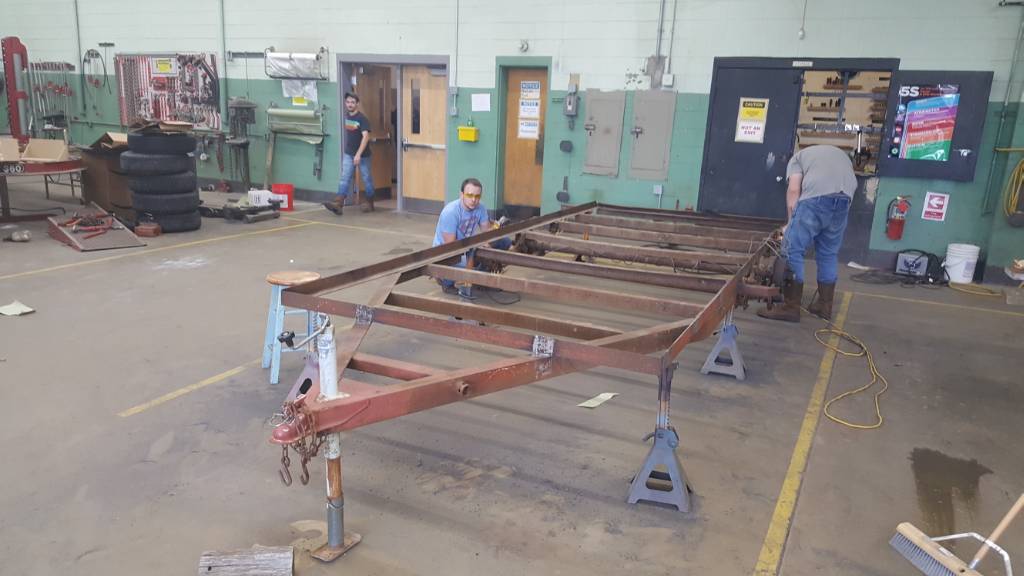

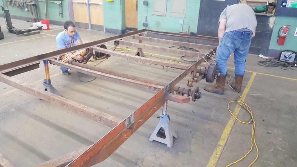

I'm I the planning stage of a trailer rebuild but have already started. I want to design a lift off fender for clearance when I put a car on it I am rebuilding the floor with Box Tubing so I'm only interested in ideas relating to lift off fender designs. Thanks. 20170928_141053.jpg20170928_141046.jpg

I had (since sold) a trailer made by H&H that had lift off fenders. There were tracks or 1/2" flat stock welded front and rear that the fender would slide down over. They were welded about 30* off vertical and stuck out about 1/8" from the trailer frame. The fenders had two handles welded on top and the fender slid down into the 1/8" slot made by the flat steel. Once the fender was on they were held down by a small version of the rubber hold downs used on a tractor trailer hood. Sorry I never took pics of the way they mounted but it was a simple system.

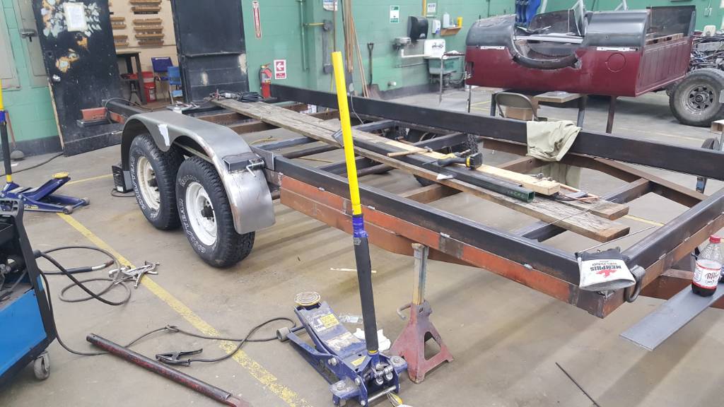

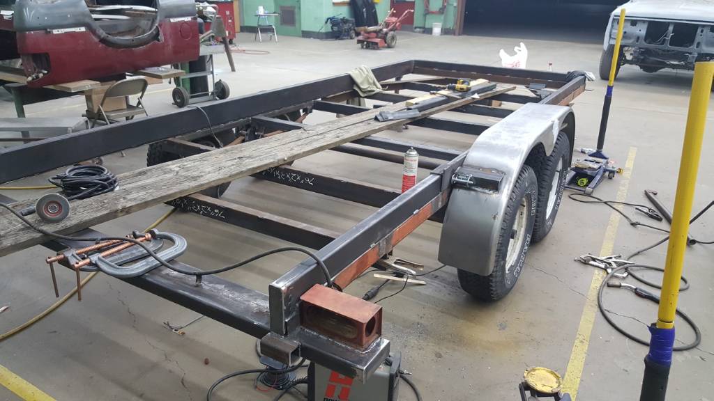

Update. Had some time to finish fabbing one fender and I like the result. Need to clean up some welds and paint but what do you think? 20171013_191215.jpg20171013_191154.jpg20171013_191819.jpg20171013_191835.jpg
   / Lift off tandem fenders #9
Are you able to unpin one end and set the pin up on top of your beam, then go to the other end and unpin? Otherwise, might require two people??
Unless there is some other means of support that I can't see, they are going to rattle really bad.
Thanks for posting this thread and pics!!!
Never thought of that. But if I'm going after something that needs to have the fenders removed I will have someone with me. The boards were never fastened down and I never noticed any noise in the truck. We will see how they work. It's definatly a work in progress! Thanks for the input.
