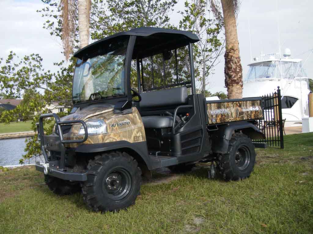

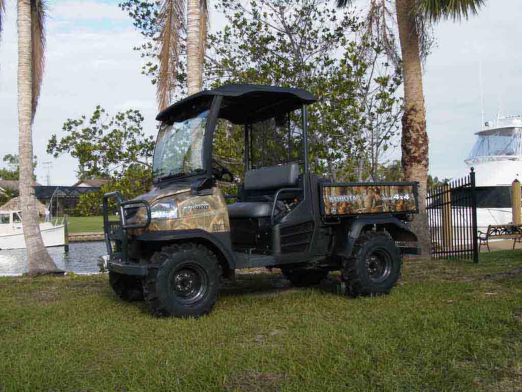

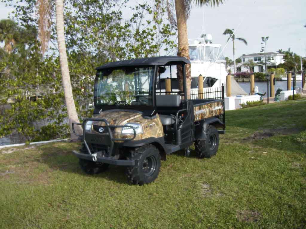

I got the pictures of the RTV with 27" 589's & Essex lift kit. It really looks good, even better in person then the pictures show. Drove it today down a long flat road and the speedo topped out at 22.5 mph. Considering the tires are 13% taller I would say my actual land speed stayed about the same. I will try it with GPS in the next few days. 589's handled real well and are 26.5" tall with 12psi in all four tires. Can't wait to try it out in some deep mud. I will be in GA for New Years and will have the time to really give it a good test. Jan. 16th I'm going hog hunting in central Florida and the swamp there will be a great test. I'll report my findings later.

Too sweet!!!! /forums/images/graemlins/grin.gif /forums/images/graemlins/grin.gif
I want, I want!
-Mike Z. /forums/images/graemlins/grin.gif
