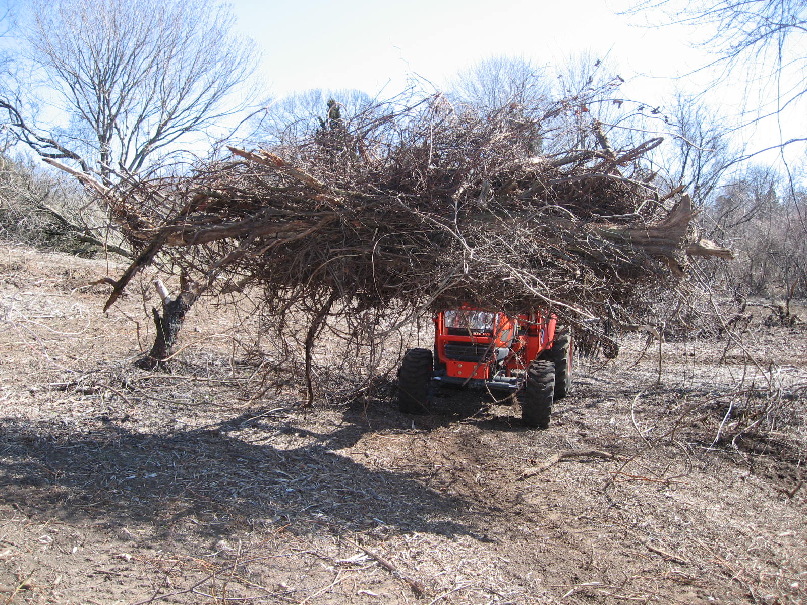

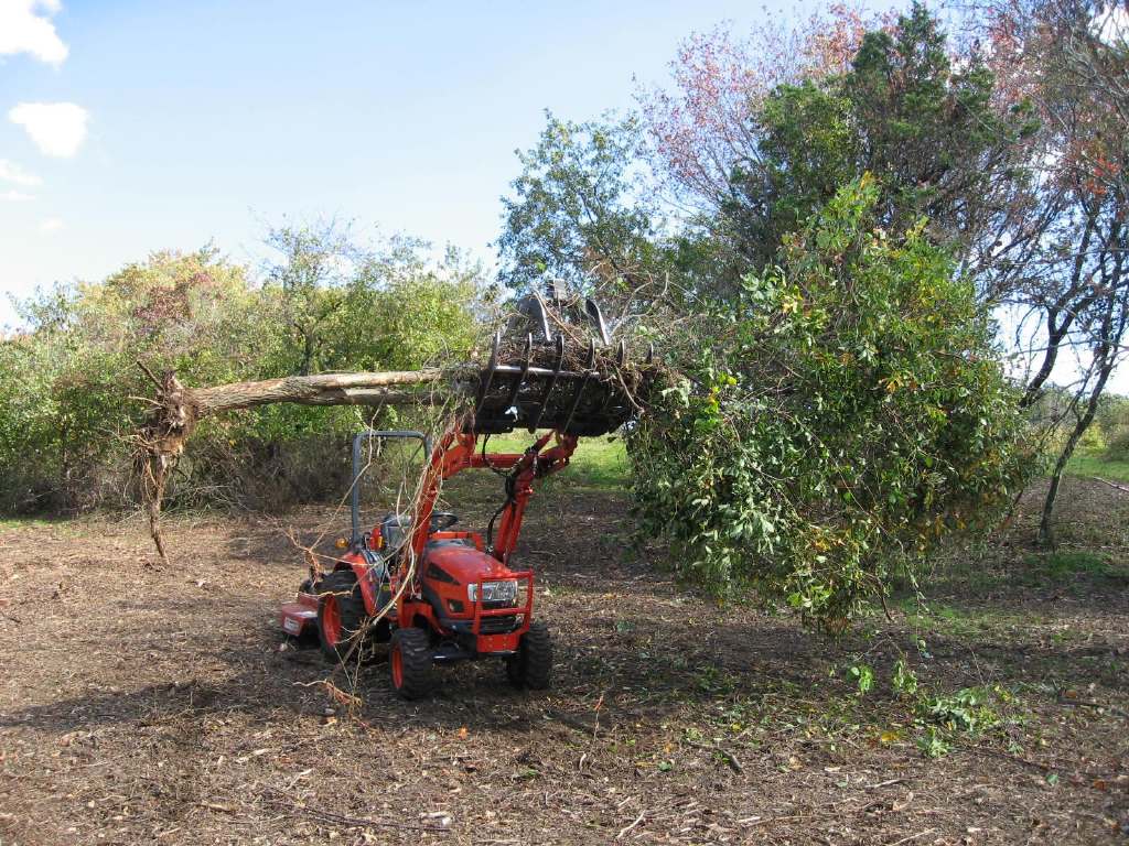

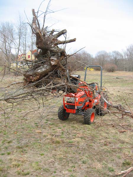

I never had trouble lifting things with my CK20/KL120. The place where I found a much bigger difference once I upgraded to the DK40se/KL401 was in breakout power. I can now just pop out bushes and trees with a single "grunt" rather than spend many minutes pushing and shoving and pushing and shoving to loosen up a bush enough to get it out with the CK20. Except for large rocks however, the CK did just fine in carting off any amount of brush I could cram into the grapple. Got some pretty big stumps with the CK too. Photos of the CK at work:
