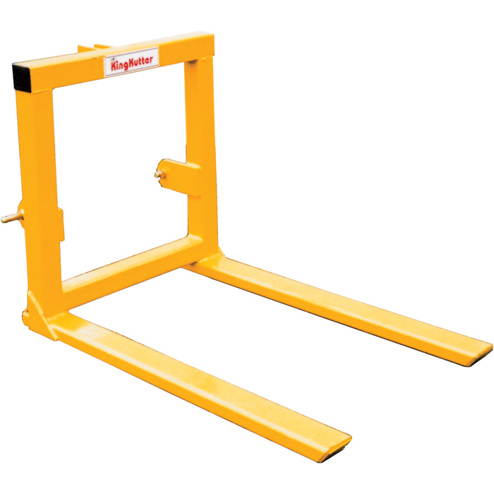

I appreciate starting another thread on this subject. (Steel strength thread kinda got hijacked).
But kenny is right. This is not a simple thing to solve. Simple toplink adjustment will change how much it can lift.
Easiest solution if you want to get close (and all you need is a tape measure):
Hook up your forks and place them flat on the ground. Measure how high the lift pin is. (for this example, lets say 10")
Now raise the 3PH all the way. Measure the lift pin again. (lets say it is now 20")
Now measure the point at what you want to know the load capacity. IT can be whatever. Pallet center, fork tip, etc. Lets use the mid-point of a pallet. Lets say it raised up 15"
So........For 10" of movement at the ball ends, the pallet COG raised 15". Now its just a simple ratio. If you are rated to lift 1500# at the ball ends, you will be able to lift 1000# at the pallet COG. (less the weight of the forks and frame).
Playing with the toplink, for the same 10" of travel of the pins, you may be able to get MORE travel out of the forks which would be LESS lift capacity. You may also be able to get LESS travel from the forks, which would be MORE capacity.
Same methods can be applied to anything. Like a boom pole.
My bushhog tailwheel hangs about 8' behind my tractor. I can set my toplink so that when fully raised, the tailwheel only comes to about knee high. Or I can use the bottom hole and make the tailwheel raise to beyond waist high. (nice for loading onto trailer). Setting up like that with the TL in the bottom hole of the tractor gives the least capacity. Cause it will cause the tips of the forks, or tip of the boom pole to raise ALOT higher in relationship to the hitch.
Interesting thread.
This early post by LD1 is right -- I may not know much about tractors, but in my day job I am a physicist and have studied mechanics (which is the name of this subject). This post is fairly simple, and there is no simpler principle for predicting the lift capacity that is correct. And we are not talking about being fussy and insisting on perfect precision -- in fact if you have a TL hole high enough and an implement whose pin vertical separation is small enough and whose frame is long enough, you can actually create a NEGATIVE result; that is, you can hang weight on the end and find that your 3pt hitch goes up all by itself without the tractor lifting it. This isn't a precision issue, it's an issue of getting the wrong answer.
If you want things simpler, you can create a parallelogram by getting the TL geometry right, and use tractor specs for the ball ends. The point of parallelograms is that they make the ball end spec applicable everywhere else.
Or you can configure your whole setup and use a crane scale to see what force corresponds to going into relief. Which is great, if you already have the setup plus a crane scale. If you are trying to predict new equipment behavior, or if you don't happen to have a spare crane scale, this doesn't work.
It's hard for me to imagine a way of calculating the correct answer that is simpler than LD1's tape measure check while not requiring a parallelogram. And the whole point of asking whether something would work is to know without trying it. There are all kinds of possible reasons not to just try things -- it could require stuff that doesn't exist yet, you could be planning a job for which it's expensive to bring in other equipment if Plan A fails, it could even be dangerous.
