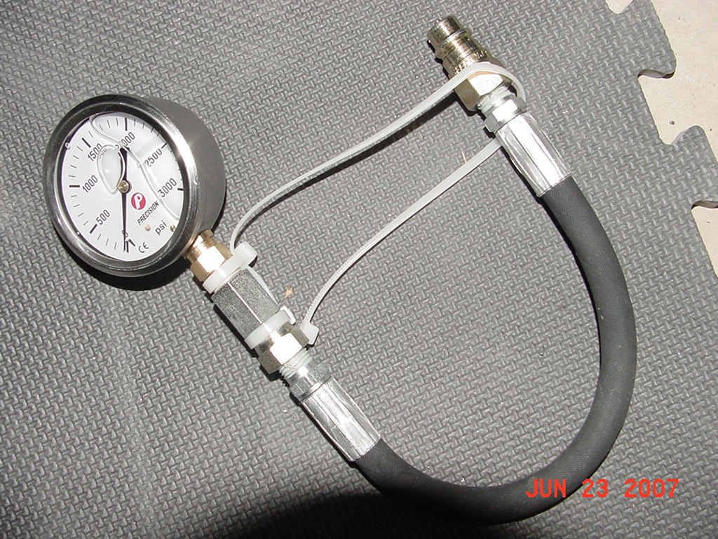

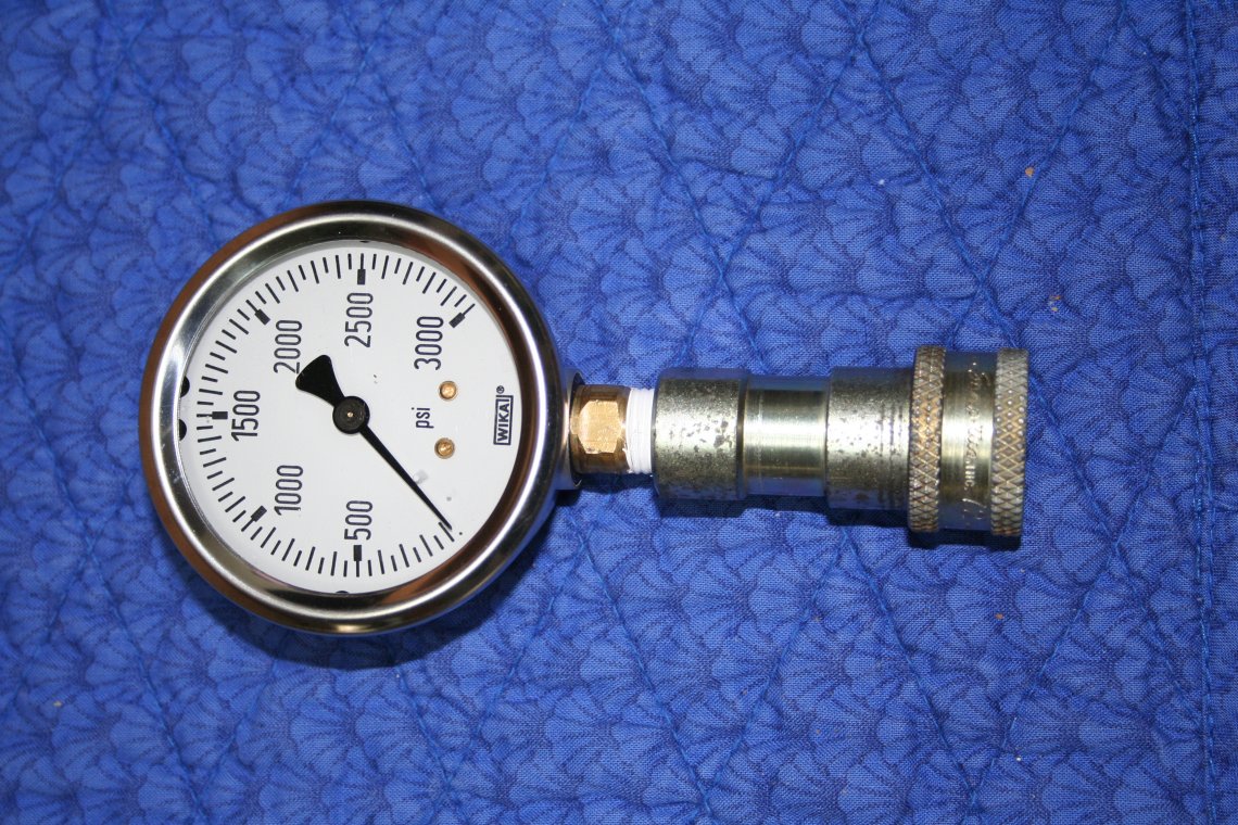

Install a hyd pressure gage in the FEL IN port using a tee and use it to monitor and trouble shoot the hyd system.
If you have no curl, but have pressure, then the QD is loose.
The uncoupled QD will generate the pressure.
If the nut is off the rod that holds the piston on is off, fluid will just flow back and forth through the cyl with no or very little pressure.
