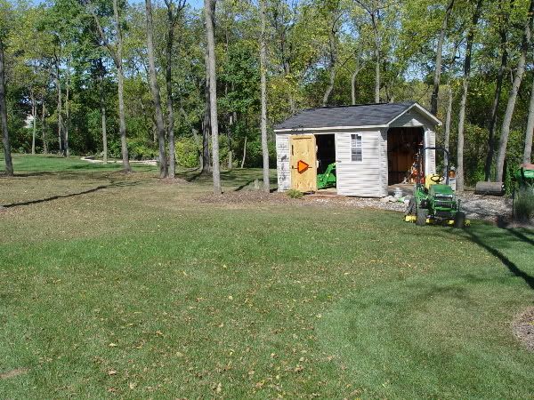

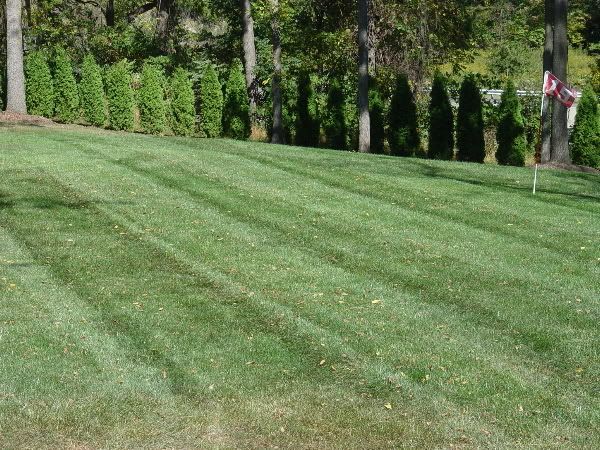

   / Lift Blades For Fall Clean-Up? #7
Took a few shots today when I was cutting the grass.
