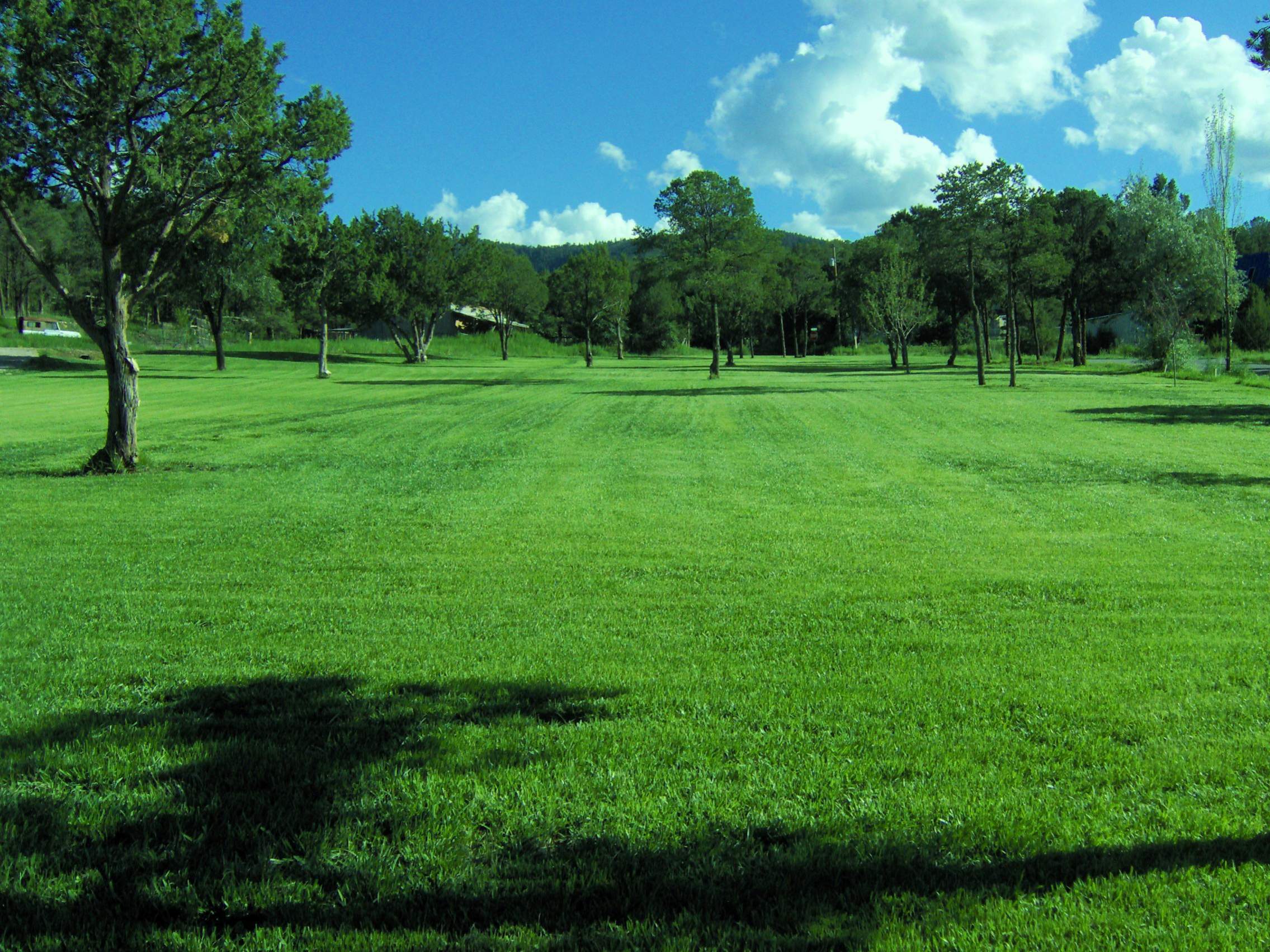

Pictures of the land would be a good starting point, much easier to offer advice if we can see what it looks like. What implements do you have now would also help. In the picture below I built the spike tooth harrow for $250 with some stuff I had on hand. Depending on your starting point that may be all you need.
When I cleared my rear lots that were over grown with trees and brush I stumped the whole thing as you have done. To smooth and grade it I used a box blade and built both a land plane grader scraper and a 3 point spike tooth harrow. Mine was rough when I started the finish work, holes and erosion ditches from a 100 years of neglect. This required the box blade to correct lots of problems. The land plane worked well for basic smoothing behind the box blade and really made the ground smooth and flat. When I was satisfied with the grade work I tilled it about 6 inches deep. Several passes with the spike tooth harrow and I had a very smooth seed bed ready to plant. I broadcast the Fescue seed followed by a pass with the harrow and packed with a small water filled roller.
Pictures of the harrow, land plane and lawn.
