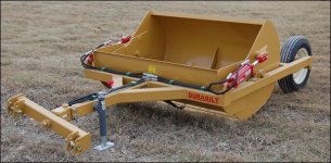

   / Leveling land #9
Buy a dirt pan if you really want to do it yourself.
Something like a small durabuilt would work good for your size tractor.
