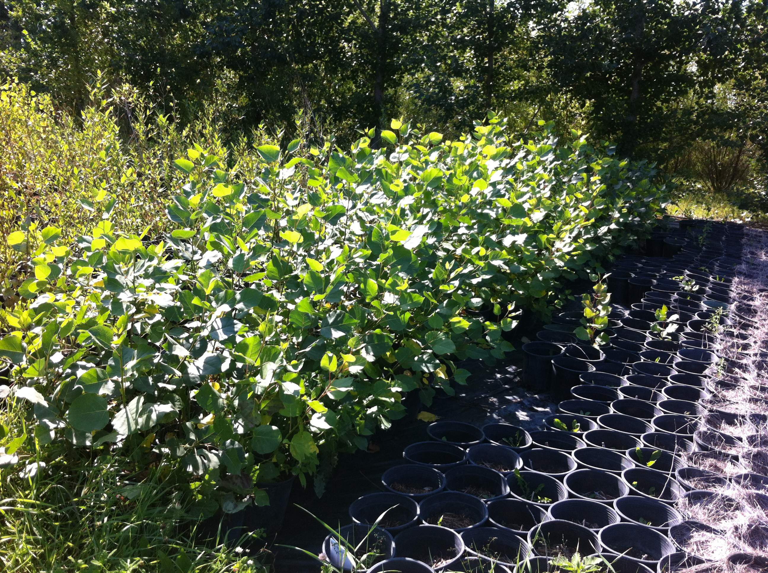

This is a one man farm.
I do use dripline with larger pots. But the small pots have to be herded together into a mass for winter anyway (they cool too fast). It's best to keep them that way to start with, and transplant them when they get crowded.
Even with the larger trees, I have close to 10,000 feet of dripline. It takes 5 seconds a dripper to verify that they work. 15 seconds to clean a clogged one.
First pic are larger trees. They can tolerate winter like that.
Second pic is a block of 300 willows, 7 rows wide by 44 pots long. I want you to imagine stringing 300 drippers through that.
Now imagine weeding it. Imagine checking for clogged drippers. And these are #2 pots -- 8" across. I want to move to #1 pots, 5.5" across. Smaller pot has half the volume, requires twice the watering frequency for the same size plant.
At present I have about 16,000 trees. Anything that takes 30 seconds a tree takes 480,000 seconds -- about 18 days of 8 hour days.
