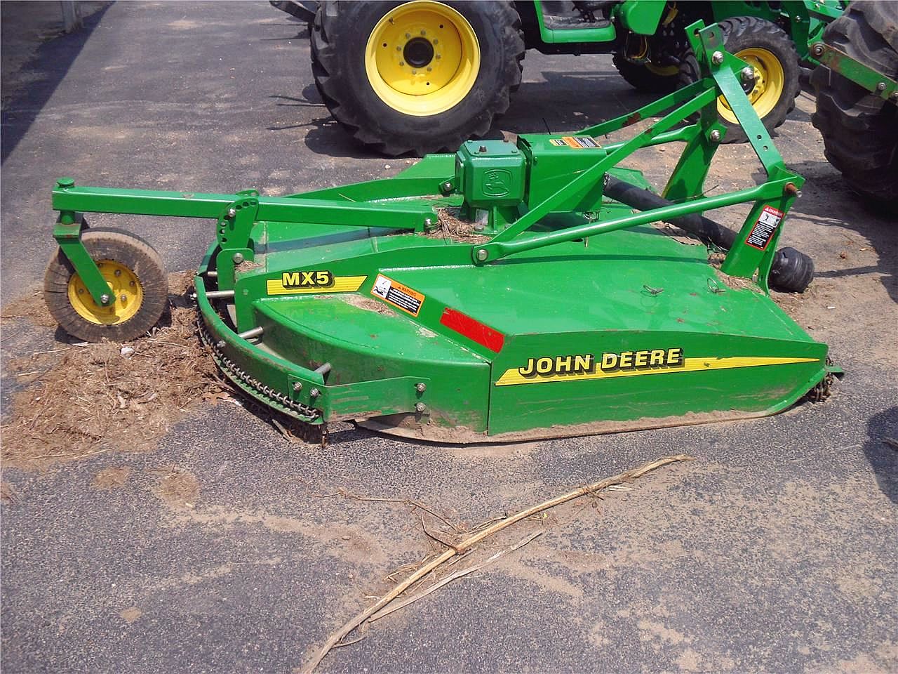

Has anyone that you guys have seen, fabricated some sort of 'bumper' for the back of a brush hog?
I know they aren't designed to be pushing things over in reverse, but that doesn't mean people don't try :D
The closest I have seen to a "bumper" on a bush hog is the MX series of bush hogs from JD. I wish more of the BH manufacturers would start doing that, or at least make it an option. Obviously that's going to add to the cost though.
