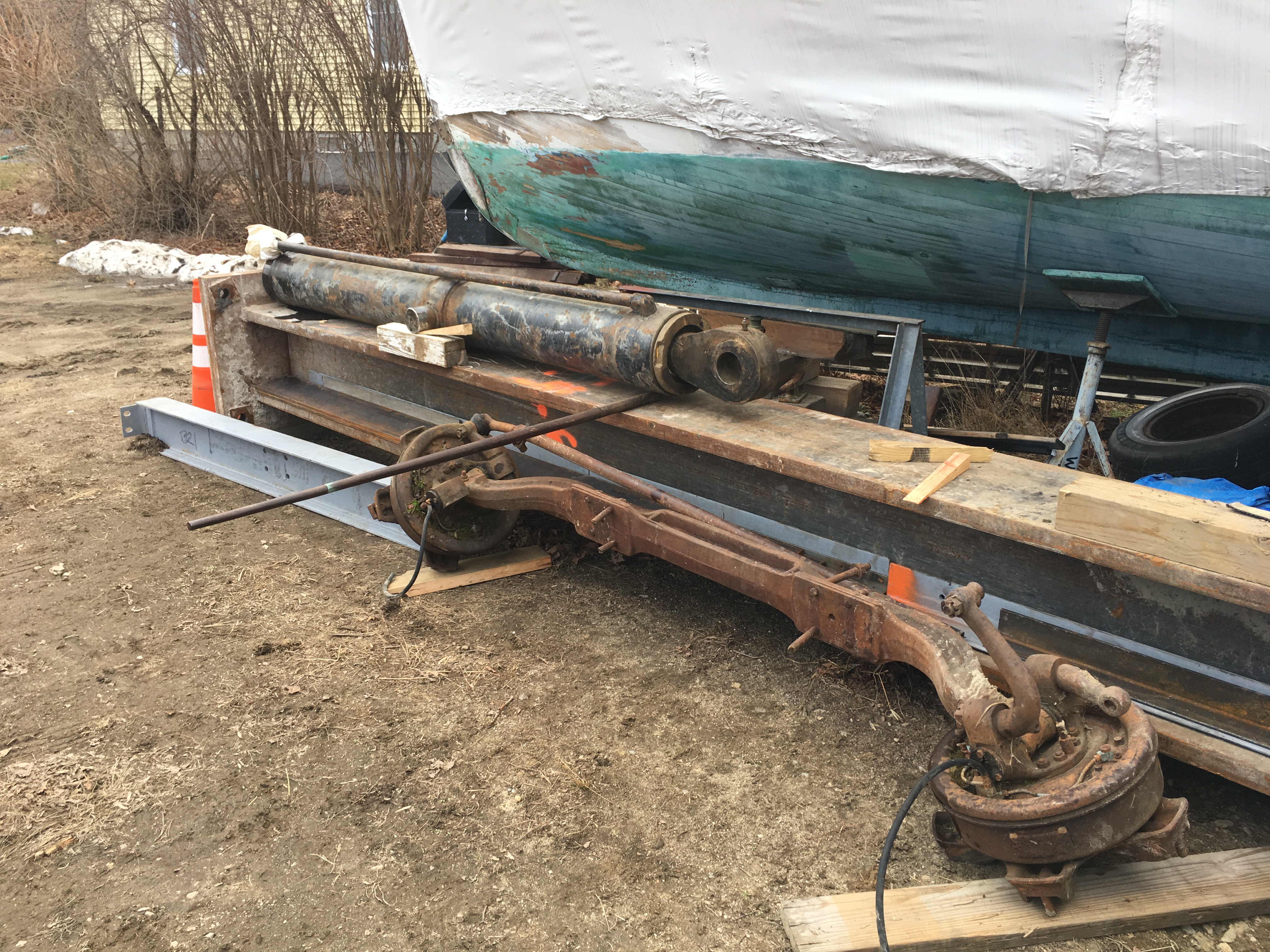

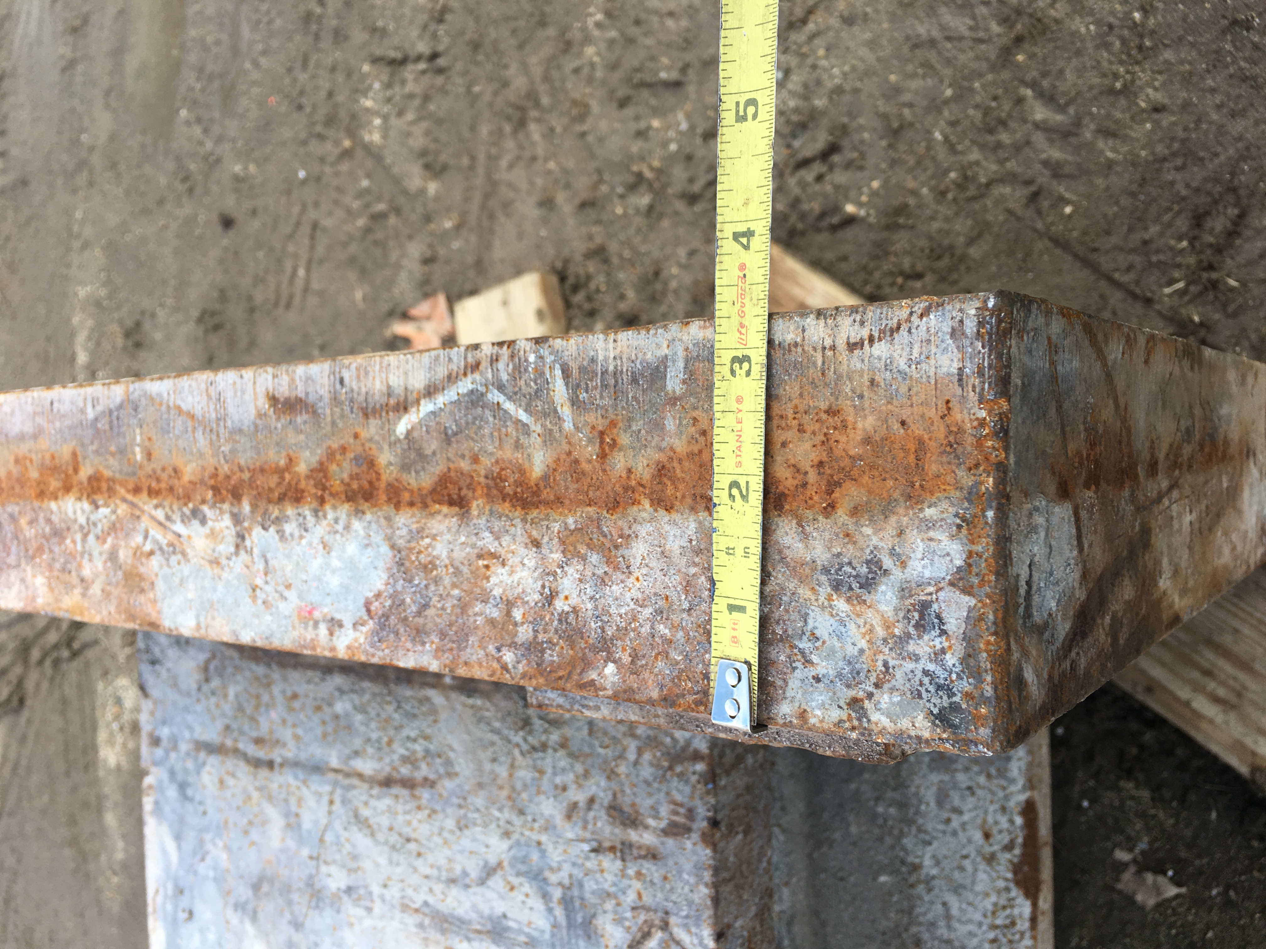

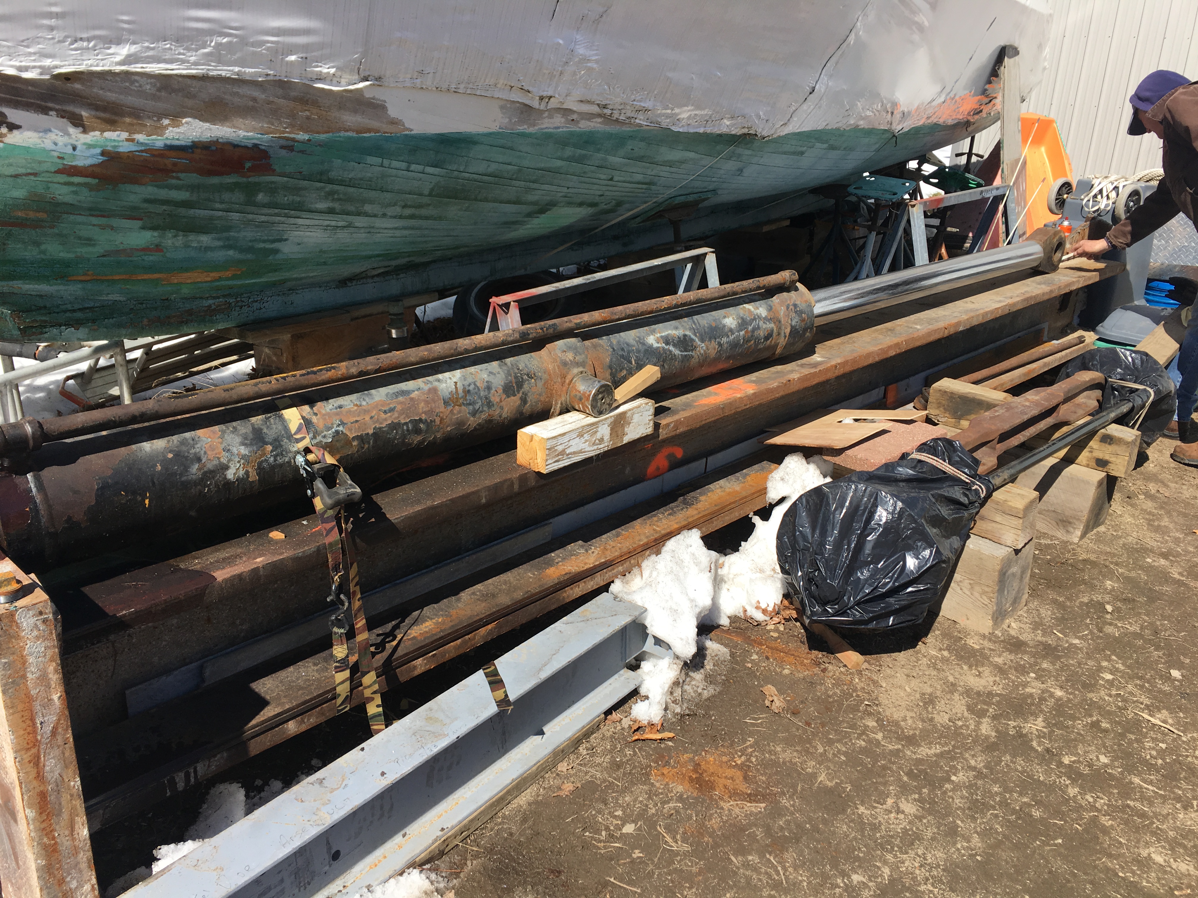

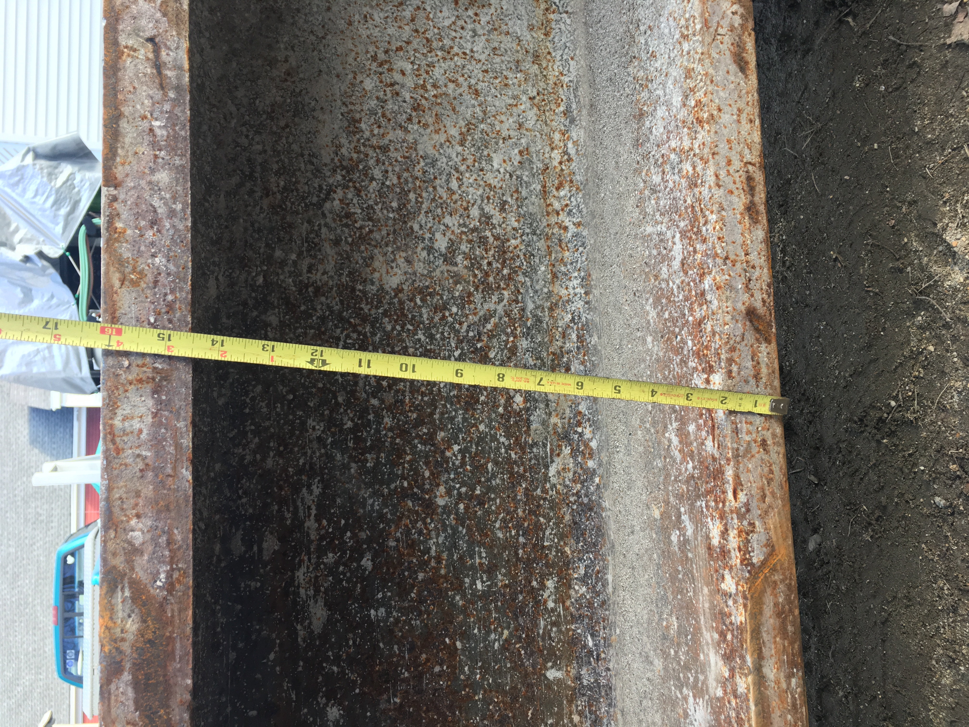

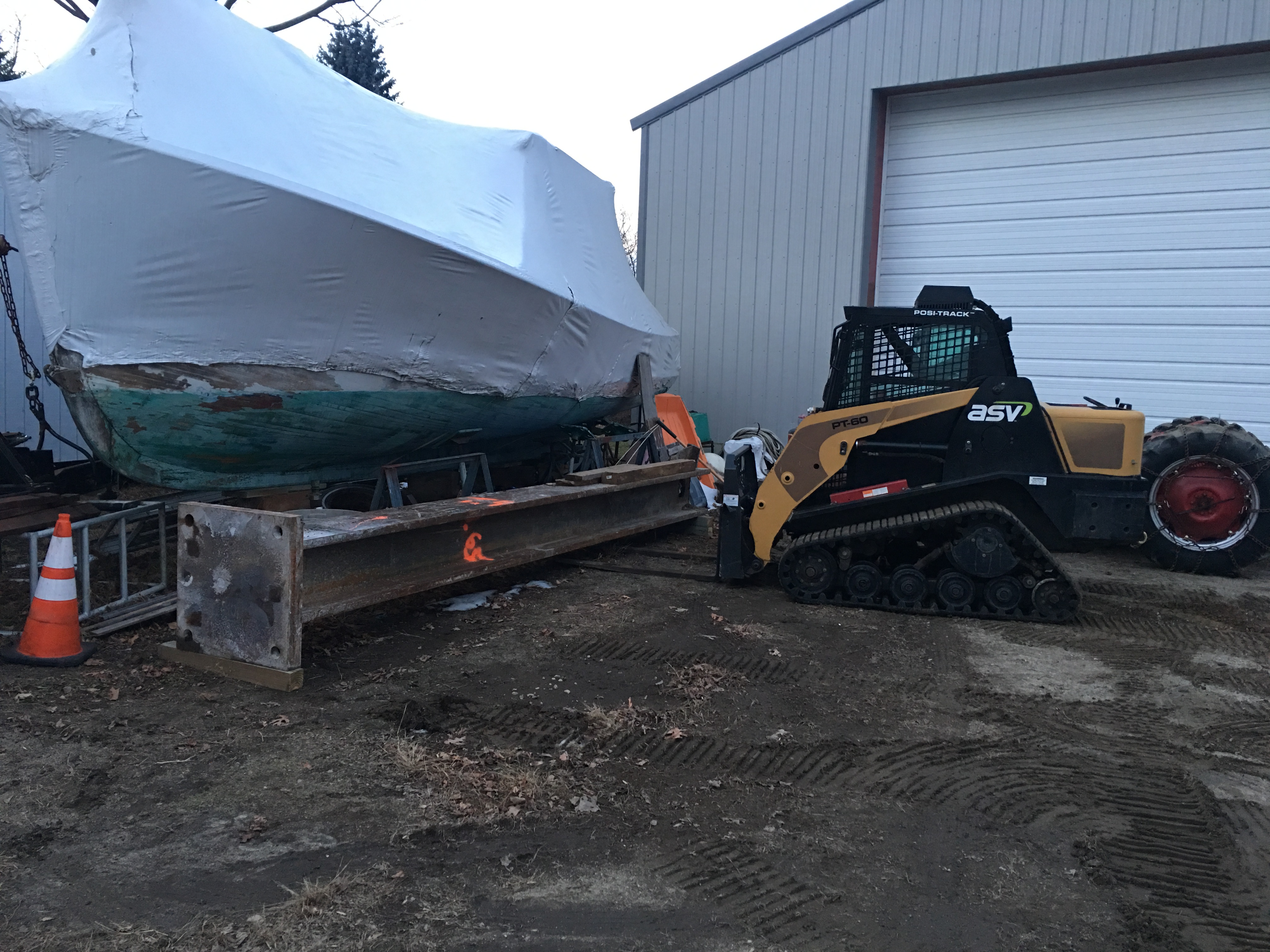

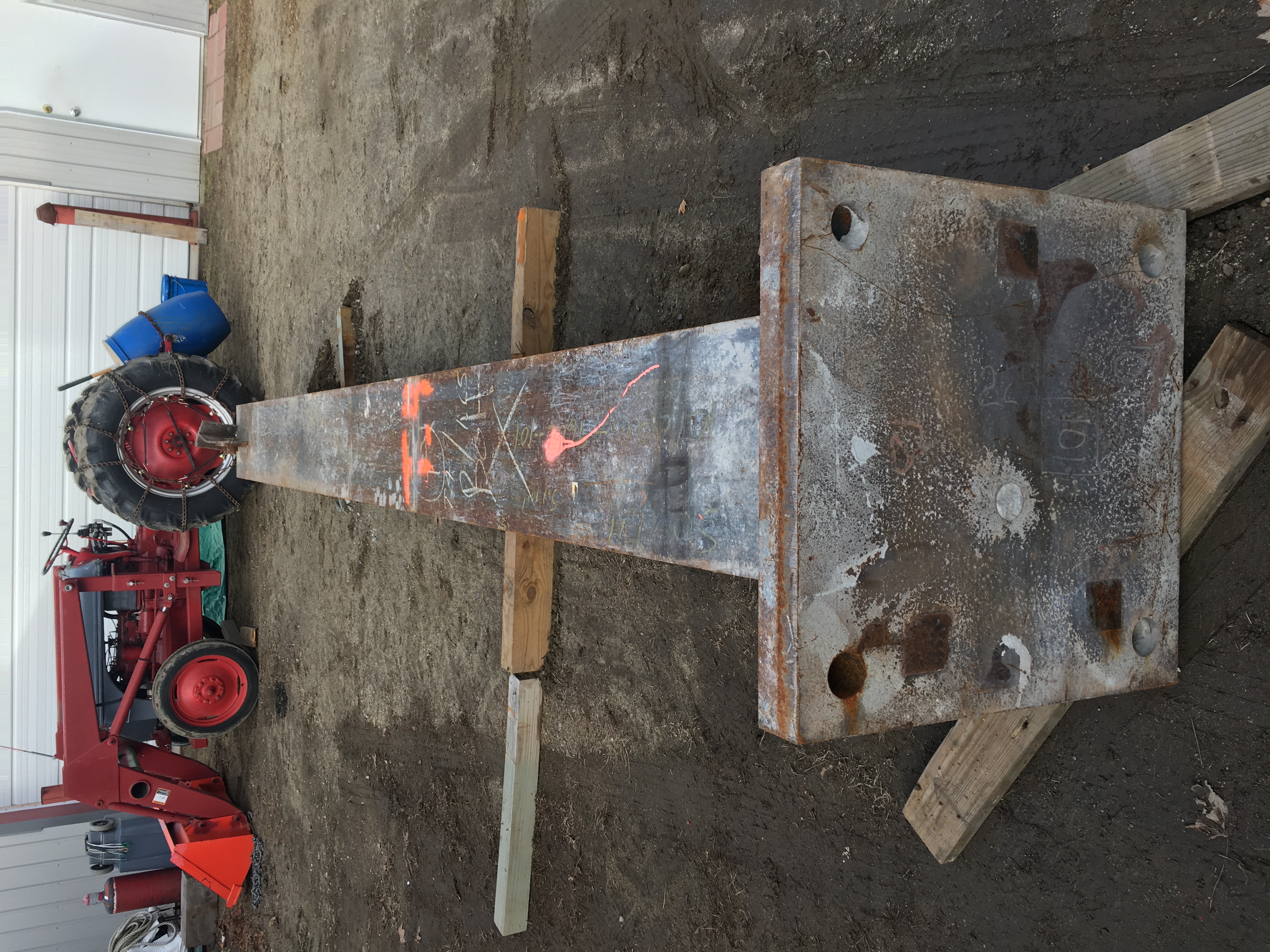

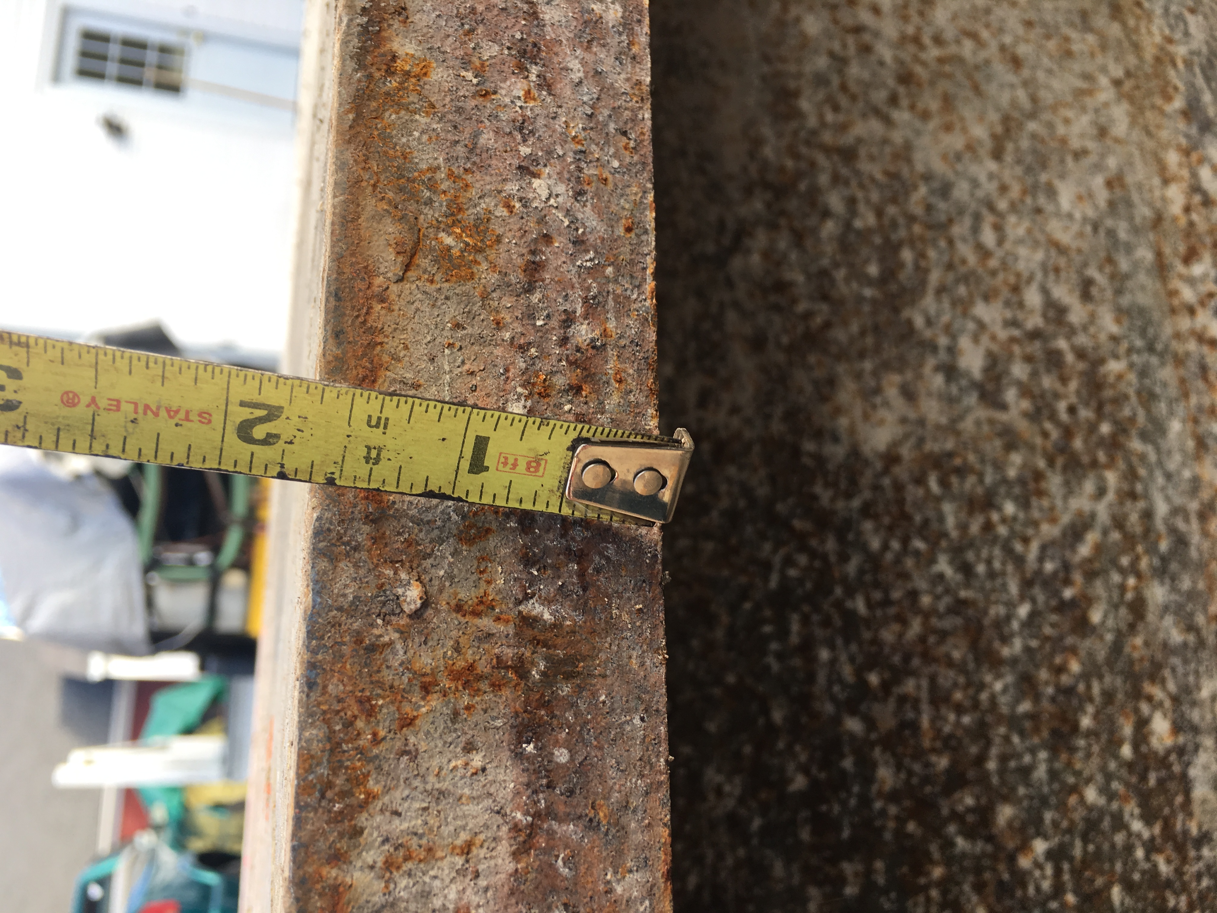

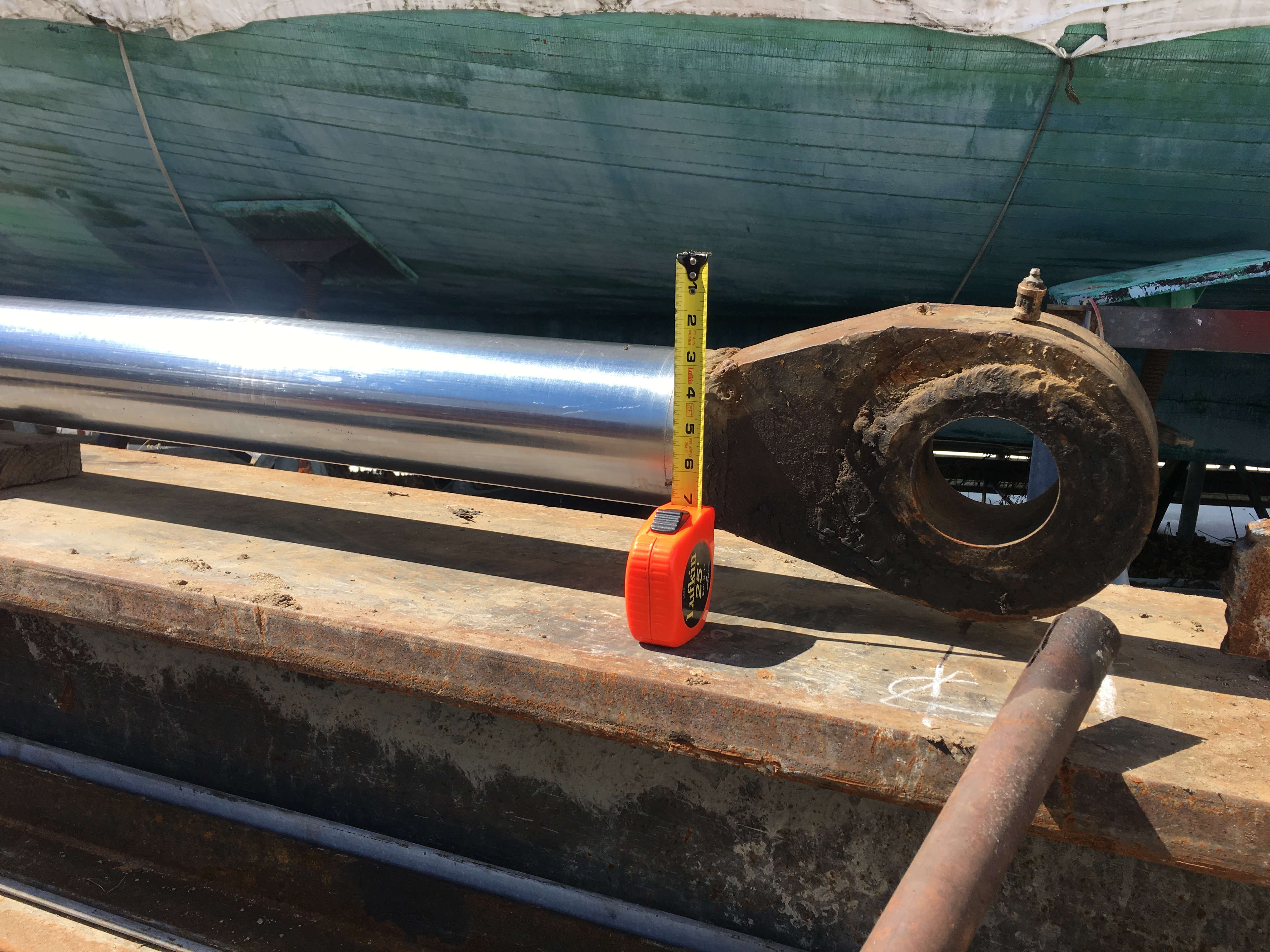

Hi everyone, I have recently acquired a monster beam to build a log splitter with. I will post some pics so everyone can get on board with the size of this thing. It's 16" x 16" x 17' and 1-5/8 thick. I have a 10" bore cylinder ~8' long with a 5-1/2" rod dia. A 165 hp straight 6 gas motor and front end from an International truck that will take 10.00x20 tires and should make a good axle. I'm looking for this to be a community project and would welcome any and all ideas going forward. I'm looking at a 60 gpm pump and a six or eight way wedge.
Stand by for some photos, away we go.
Thanks Mike

Any plans for how many gallon reservoir?

We're splitting what ever we want!!! 75-100 gal reservoir should cover it. I don't think I'll be splitting 7' long logs too often. Could run a cooler to offset a smaller tank.
   / Let's build the biggest non commercial splitter ever! #8
Wow! What sort of pressure are you thinking? 2000 psi would give you about 80 tons...
#9
2000-2500 should be more than enough.
