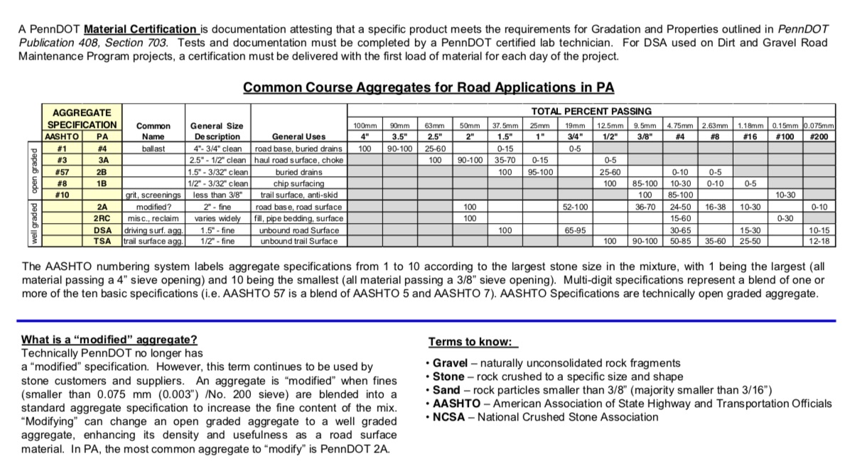

This may help.

This may help.
Sure does. Thanks.
I m from Pa so this fits my area. I also work for PennDOT (computers - not roads). I should have looked for their documentation.

Looks like what we're talking about is their #10 or smaller. Others mentioned 1/4 crusher rock, or crusher run.
   / Let s Talk About Crushed Stone #9
Your stone will be similar to what we have here. I'd suggest 57's for the drainage. They are all similar size and no dust. For the drive topping, it depends what you're trying to do. We have what's called 411 size, which is approximately 3/4" down to fines and dust. It packs well and it's what I use for general repair, fill, and topping. If you want a clean small thin top coat, then go for 8's or 9's which provide a nice quiet and clean surface. But they don't pack so they stay loose... use as a thin coat only.
