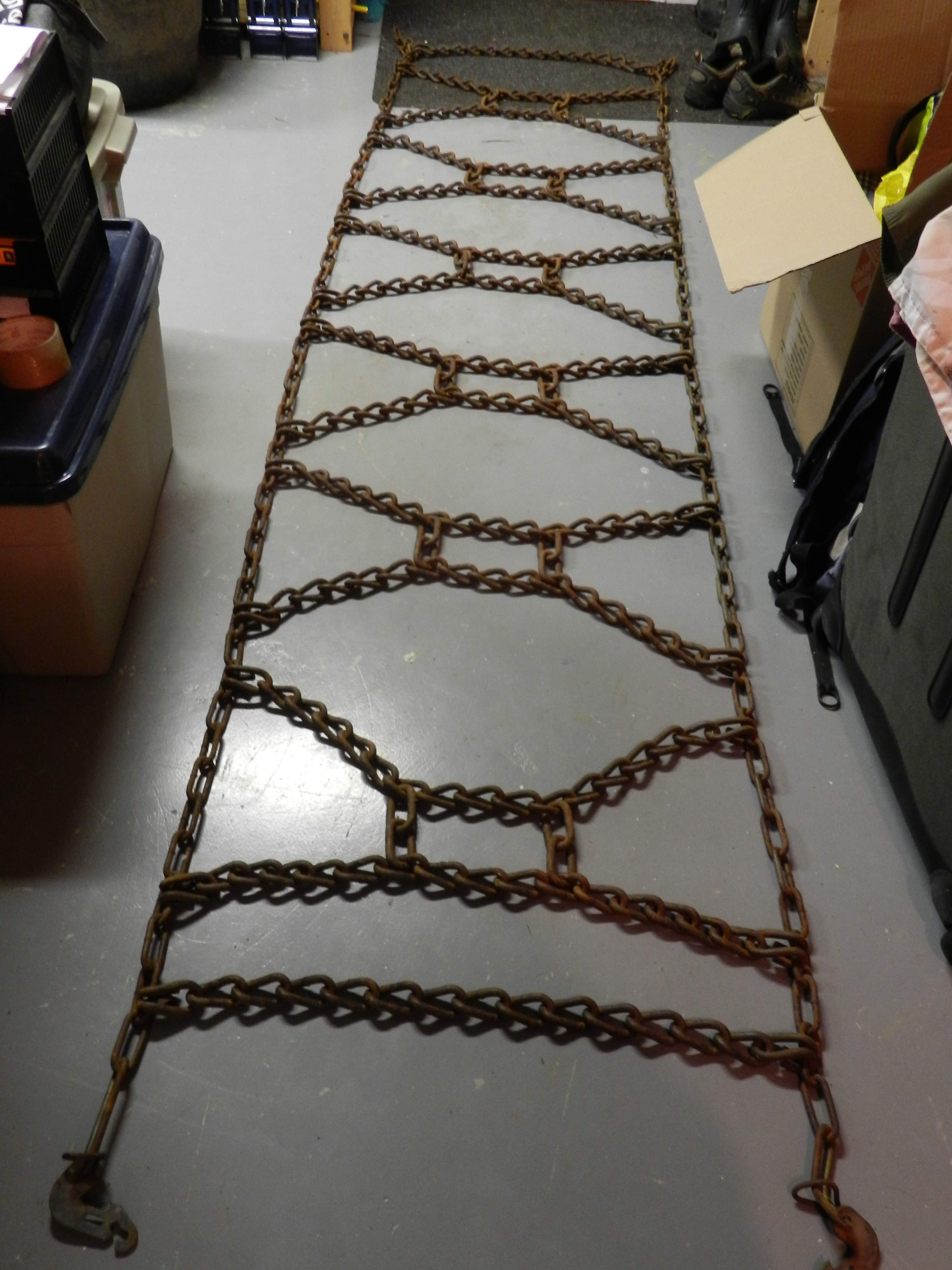

I just got a set of tire chains off of a MF 165 and want to put them on my MF 65 Industrial. The guy I bought them from wasnt sure what size the tires were on is tractor. Mine are 16.9x28. What should the length and width be for a chain to fit this tire?

Yea I guess I'll just have to see when i get out there to test fit them. They are a H pattern with joiner links, and a straight cross chain at each end. Since they most likely came off a 16.9x 34 or 38 then cutting one or two of those links that are straight across might work good.

Here's a pic, they seem to be in great shape, some surface rust, but next to no wear as far as i can see, and at 1/6th the cost of new
   / Length & Width of Tire Chains? #7
Good for you for scoring a nice set of "gently used" chains. Hope you can make them fit your tires. They're duo-grip style. There are a bunch of places online that sell chain to extend them if needed, or to add cross chains. Or a local auto parts store.

I checked the Laclede and Quality Chains catalogues for 16.9 x 28 tires. They both suggest DUO262 having 10 DUO297 patterns, which have 14 links in the cross chain. Yours have 15 links so they are a bit wider. CanadianChains sell Quality Chain products. A set of DUO262 is $510 including shipping. Tirechains.com in the USA's price is $490.54 but shipping will be expensive to Canada.
Since your chains have 6 patterns you may need another 4 for each chain. CanadianChains' price for cross chains is very expensive. They quoted around $40 each (including shipping) for 8 patterns of my 13-link DUOs. I was able to get them as bulk DUO chain from the local supplier (Western Equipment in Prince George) for $20.90 per pattern. They shipped them free to their Vernon office for me.
If you need extra patterns you may want to check with local chain/cable suppliers and see if they sell bulk DUO chain.
My DUO's were very rough due to a small diameter tire which increases the gap between patterns. I modified them to close the gap as shown in this thread:
http://www.tractorbynet.com/forums/attachments/268885-duo-chains-planned-modifications.html
Your tires are larger and the inter-pattern gap may not be as noticeable. And mine worked OK before I modified them, the ride was just very rough.

Thanks for the help. I've come to find out that there is a possibility that the chains came off a MF165 with 14.9x28 and if that is the case no modification will be needed. I keep my fingers crossed for that outcome.
Thanks
Well got to try the chains today and luckily they fit with NO modification!!! Plus they helped so so much. I could actually make it up the hill on the driveway with the snow and ice.
