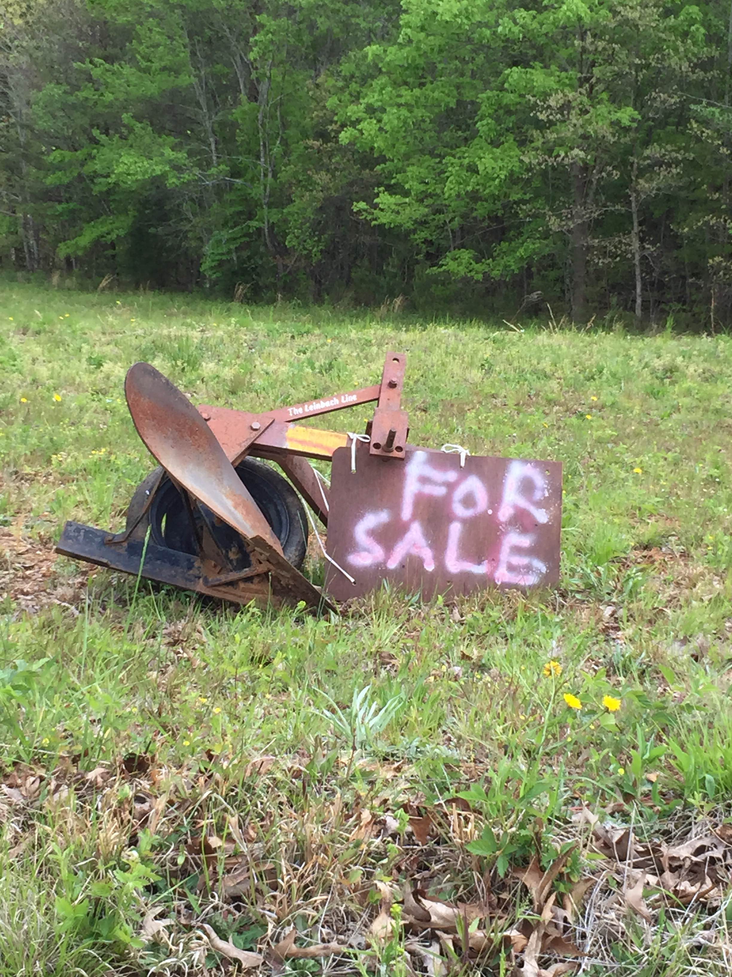

Would anyone have an idea what this might be worth and whether or not a Massey GC1705 could pull it?

TractorData.com specs GC1705 ground clearance at 6.7". Is this correct? If 6.7" is correct, you cannot use a moldboard plow, as the furrows in which the right tires run will vary between 5" and 7" with a 12" plow, so you will be plowing with the front of the tractor as well as the plow, impacting with hard earth everything part of the tractor undercarriage.
Also, you need rear tires no wider than 12", preferably no wider than 11", to fit in the plow furrow. Turf tires, usually 16" wide, will not work with a 12" plow.
Your better alternative would be a 48" PTO powered roto-tiller.

If that Massy GC 1705 being a subcompact it definitely would much be too low.

Yea, I've run into that problem with other attachments...:thumbdown:
As for the value of it, the Leinbach 14" plow sells for $299 new at Agrisupply. Figure about 50% depreciation (typical for older, used attachments) and that would put the value around $150. If you can get it for that or less, it's a decent deal, assuming your tractor is capable of pulling it.

How does one measure the size of the moldboard? Thank you.

Measure the share (bolt on cutting edge across across the bottom). 12", 14", or 16" are most common.
