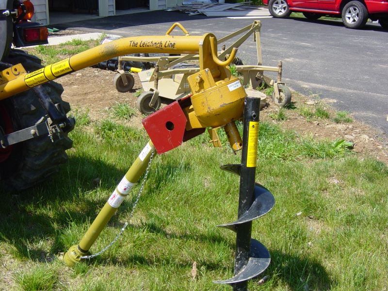

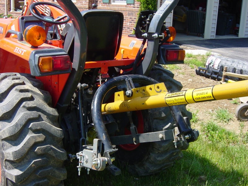

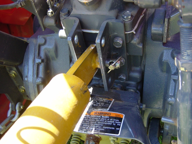

Ok...here are some pictures.
The first one shows how high the boom is when the 3pt is raised all the way up. The second one shows the rear end of the tractor. The third one shows what happens when you use the lowest pin setting on a L3400. Basically, I need to find a way to raise the boom..... I can either mod the U or raise the 3pt lower arms on the tractor. Suggestions would be greatly appreciated.

In the third picture, it looks like there is another lower hole in the toplink bracket. Am I seeing it correctly?
Another thought, does the Pats links push the lower arm attachment point out a little? If so, removing them would straighten out the support and possibly gain some height. It may also allow moving the support rearward into another hole closer to the tractor.

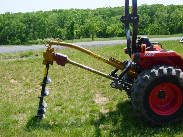

Here's a picture with the toplink in the lowest hole. Because Pat's lifts the lower arms up, I would think that it helps if anything....
