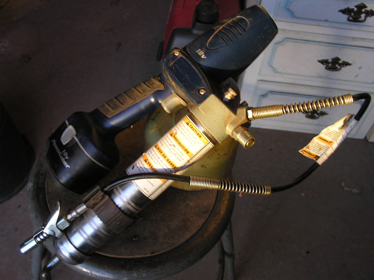

After all, how you going to lode it if it's locked! It's ok I get it, they aren't selling tennis rackets.
Seems like a great feature and I went for it because of the 10k lbs pressure since I was having some trouble with a zerk on the front knuckle. The company is great about sending replacement parts but if you can't make the end [ I don't know the correct nomenclature here, the thing on the gun that mates w/the zerk] stay on the zerk. You own an expensive paper weight.
This is the second new `thing' they sent. It has four jaws count `em. It's on a long flexible hose if you don't hold it in place with one hand and position the gun so you can work the handle against your body the grease goes everywhere but in the zerk. `Nuther call to TS and got told `you have to unscrew the thing some put in on the zerk and tighten it so it locks in place.` Put it on the zerk twisted tight and let go to pump the grease. Before my hand got to the handle the `thing' was bobbing on the end of the hose like a starving carp.
Has anyone had good experience with this gun. I have the 50 dollar version, which will soon be heading back to Legacy if I can't discover what I'm doing wrong.
I'm aware this could very well be user error I've been there enough to allow for that. But I'm of at least average intelligence and am not too bad at following directions. I don't see how this thing is supposed to loosen or tighten it's jaws because I turn it on it's mounting threads. There is the feeling of the two pieces mating then the feeling of the bobbing thingus on the hose. Hope some one can wise me up to using the thing.
Many thanks,
Ron

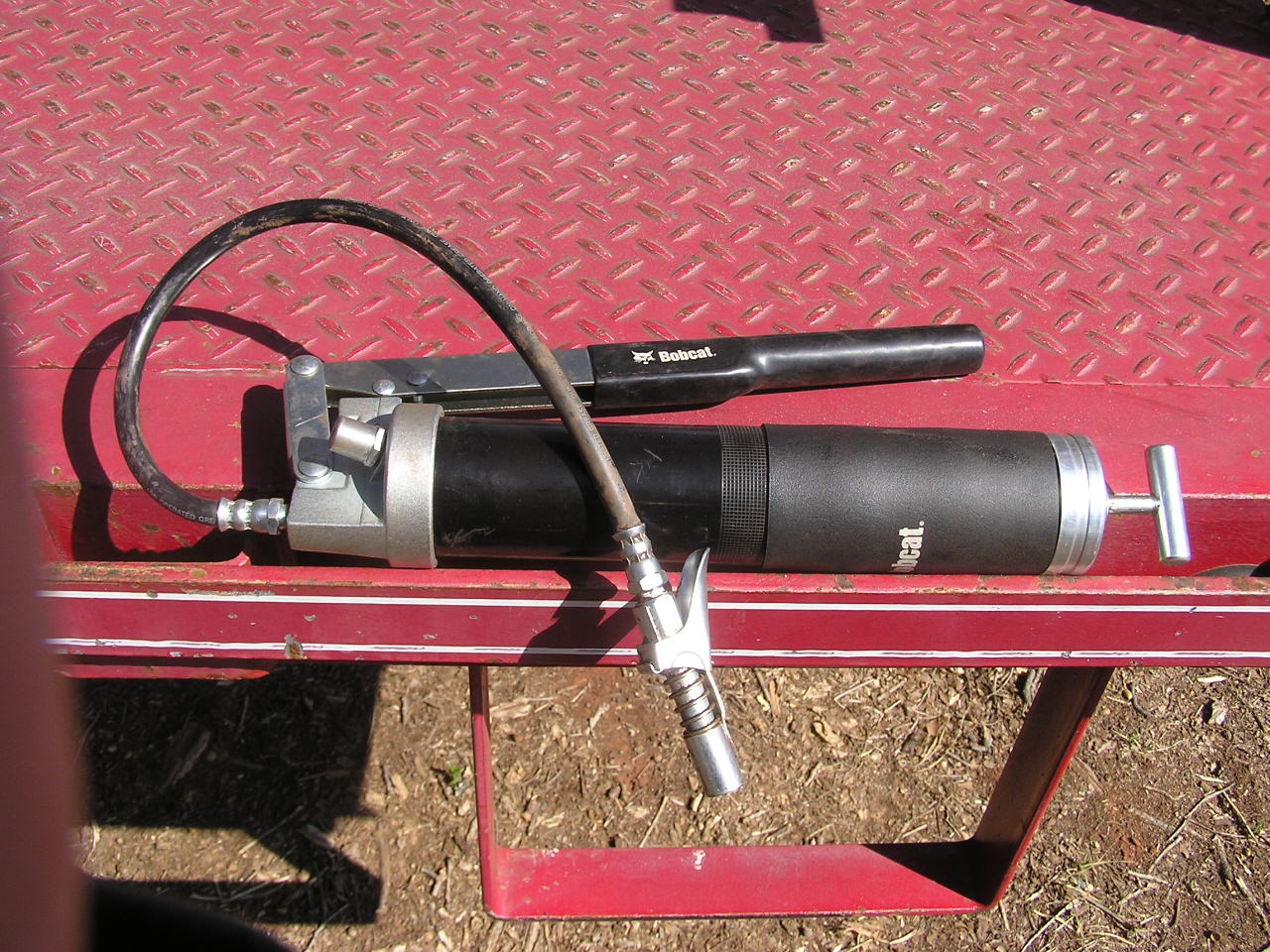

I prefer the 10,000 psi lever gun with the LockNLube coupler, only need two hands and no grease leaks around the zerk. http://www.tractorbynet.com/forums/oil-fuel-lubricants/304889-locknlube-cupler-grease-gun.html
425238-legacy-grease-gun-load-lock-p4220003-jpg
Even have one on the electric gun :thumbsup:
attachment.php

Bite the bullet and buy a quality battery gun, like the Lincoln, add the lockNlube and you can grease away. Remember that even the best guns won't push through a damaged zerk...Mike.

The tip piece on the end of either a solid pipe extending from any type gun or a flex hose is made of TWO parts. See this example: LINCOLN Coupler, Grease 5852 - G3008573 at Zoro
The left end has flats for a wrench. the tip has knurled grip for gripping to UNscrew and or tighten the tip for fitment onto the zerk, then one snugs the tip by tightening it onto itself.
They unscrew without being attached to the flex hose or pipe, regardless if using a lever or pistol type gun. Once unscrewed enough to be able to loosen or tighten the nozzle end with your fingers THEN screw it onto the flex hose or rigid pipe. Then press the end onto the zerk and snug it up by hand. Then pull the trigger or pump the lever. When done, loosen the end of the nozzle closest to the zerk and it should then be able to remove the gun/nozzle from the zerk
Don't force lots of grease into the center knuckle of the axle unless you want to blow out the seal.
Using a Lock-N-Lube tip on flex or rigid pipe grease guns will make keeping the tip locked on the zerk that much easier.
There is no need for three hands with this attachment.
