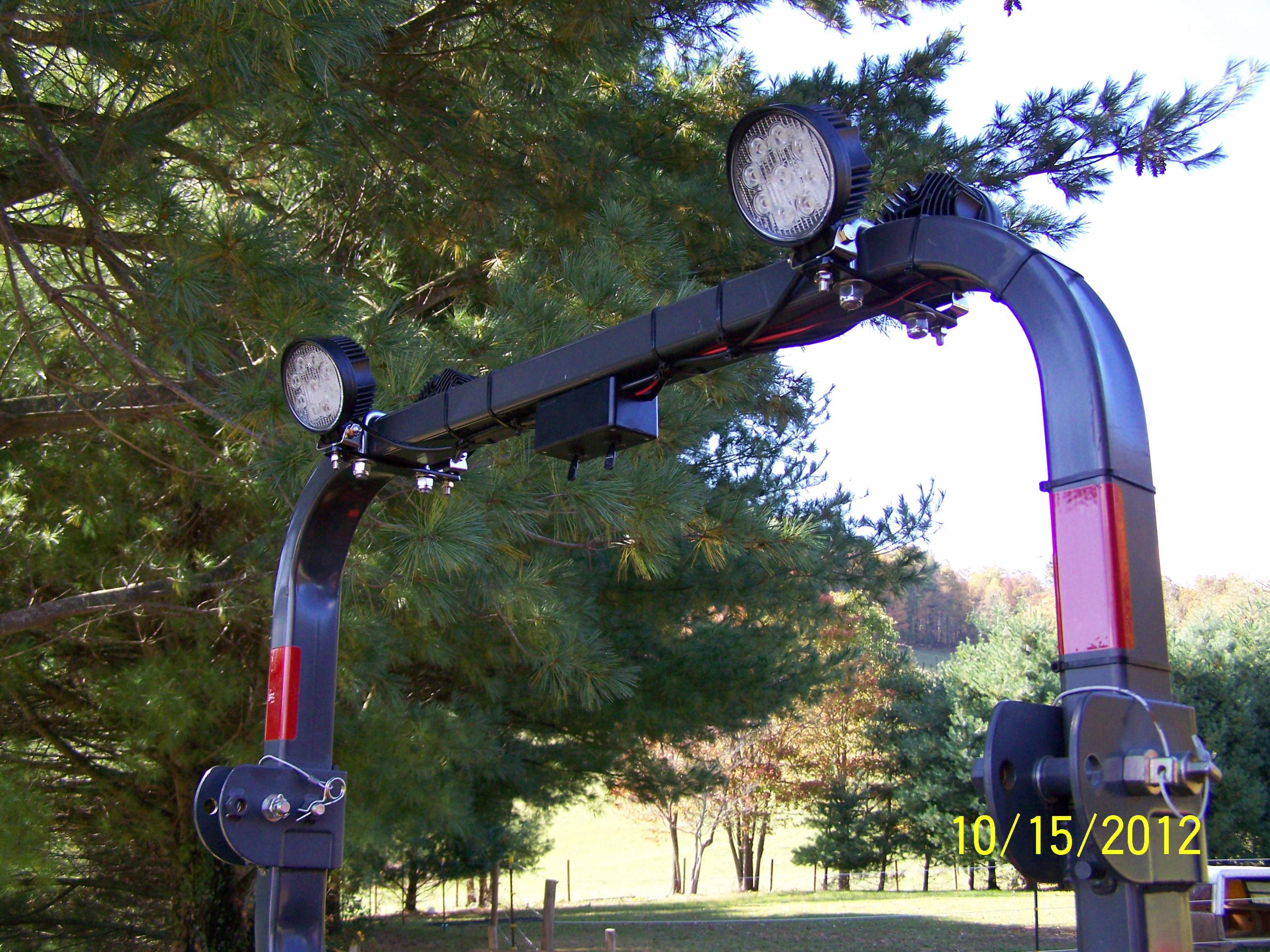

tractor stuff 002.jpgtractor stuff 003.jpgI don't know what the setup for the rear work light is on a 9540. My L3240 had a 10Amp feed for the work light which was enough to power the 4 27W LED floods I installed on the ROPS.
Bill

Plastic toggle switches are never better than the quality metal ones. IMO ... and always use these on your toggle switches to make them last... Apm Hexseal Waterproof Bat Toggle Switch Boot USA 1 PC Best Quality | eBay
The switch box, (the box in which i mounted the switches) is plastic. The box was cheap, won't rust, and plenty strong enough to support the switches and wires. I attached it to the ROPS w/ GE silicone, rather than drill holes in the ROPS
You are only switching a 4.5 amp load if you use two lamps like I did. I didn't use the best switches. Do I think plastic switches are better than others? Probably not, but they do work. If you feel that a metal, 20a rated switch is a good way to go, be my guest, it certainly won't hurt.
I had plenty of light. It was an easy installation, and it cost about $150. If you want to upgrade it wouldn't be hard, it just costs more money.:D
I know I will never have any problems with the switches. :thumbsup:I sold the tractor.

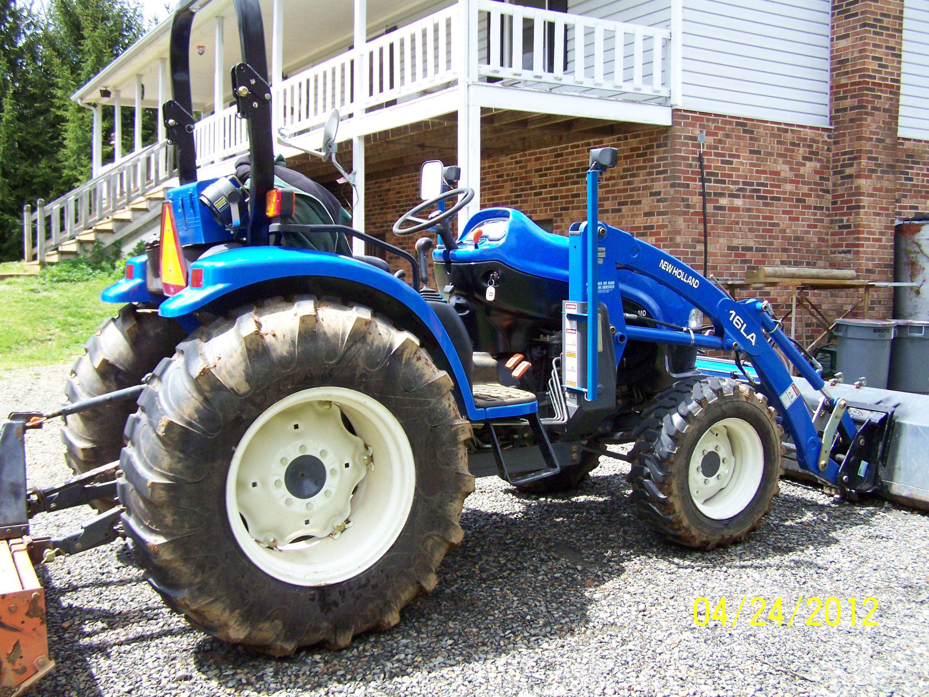

One thing I didn't like about the forward looking lights on the ROPS was that they cause some glare on my glasses. If I still had the tractor I would be thinking about another light mount off the loader mounts like these , on my TC40D. Since the regular lights were useless with the loader, I disconected them and fed the work lights off the headlight circuit.TC40D 004.jpg
For as often as I work at night, I don't know if it would have been worth the trouble.
Good luck, Bill
