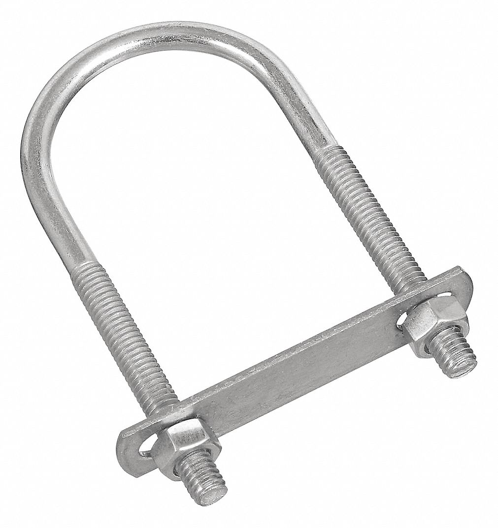

In the picture it looks like you used regular U -bolts
38XD74_AS01
Have you thought of flat (or square) -U-bolts?
I found the square ones hold better on many things that are not round.
My Tupelo, MS TSC carries them, at Home Depot I have to order them.
/ LED worklights added to 3038e
I used square u bolts on the 1025R, I used regular U bolts because I happened to be in Lowes the day after the bar came in and they did not have any square. Figured I could make a trip to TSC for the square ones if they didn't work out. May still do so if vibration becomes an issue (plus go to the larger angle stock I used previously as well...).
