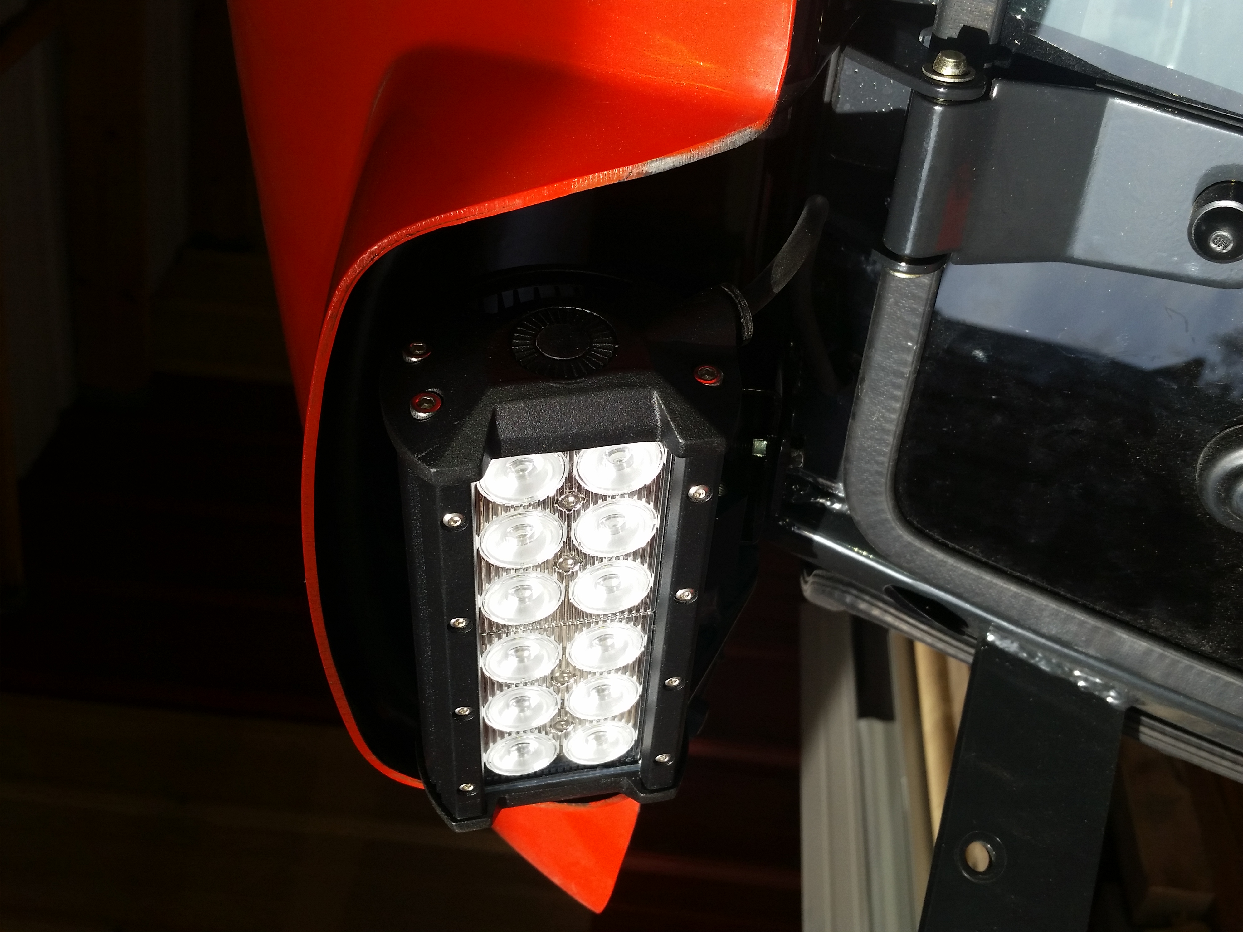

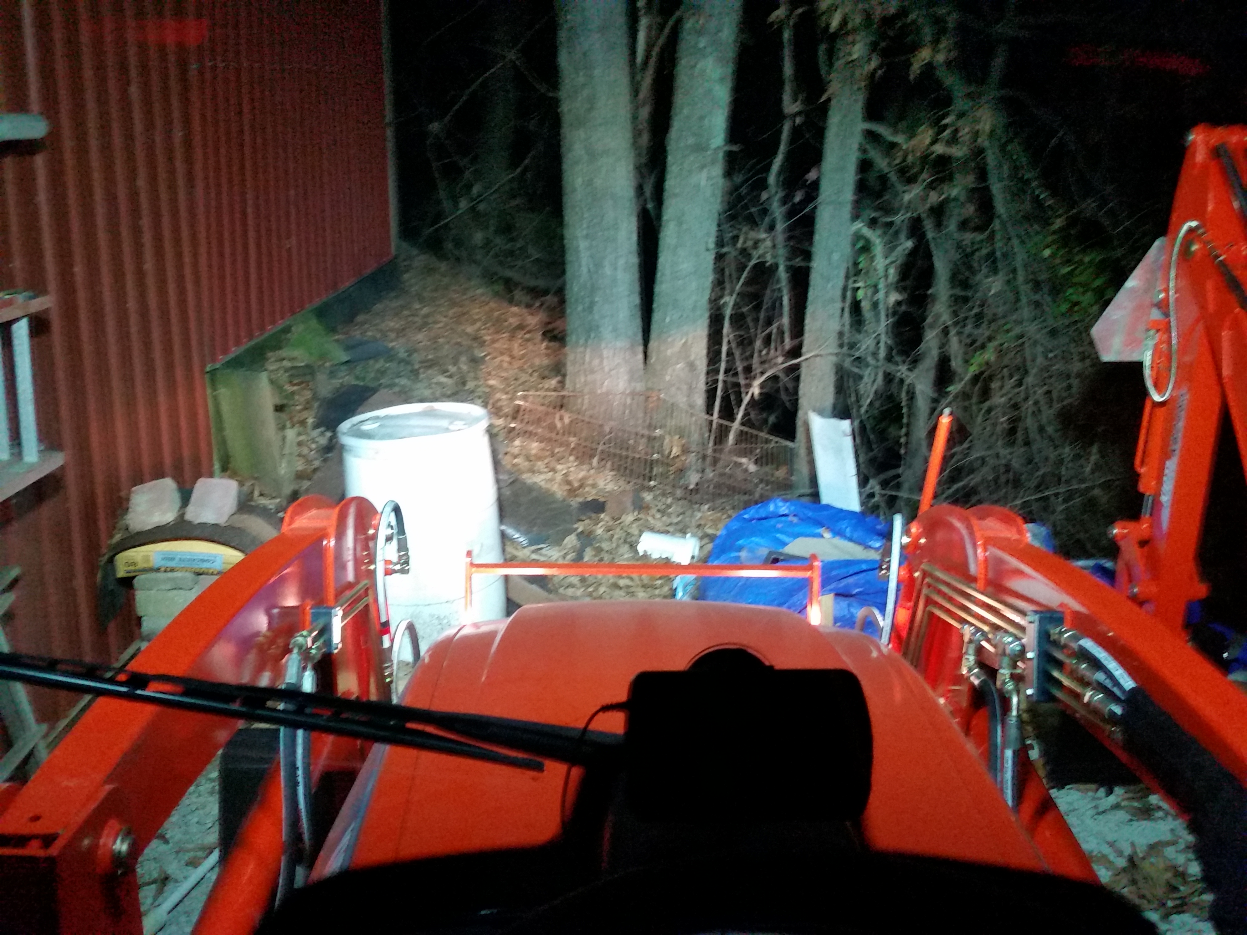

I have 6 CREE LED lights - 4 - 36W (3600 Lumens each) LEDs on the cab, 2 forward and 2 rear with 2 - 26W on each side. Lights up like daylight and current draw is less than the lights I replaced so it is a direct replacement. (Side lights were off a different circuit).
Light output dwarfs OEM lights. With headlights on and when I turn on the LEDS it's like the headlights go off...they are that bright.

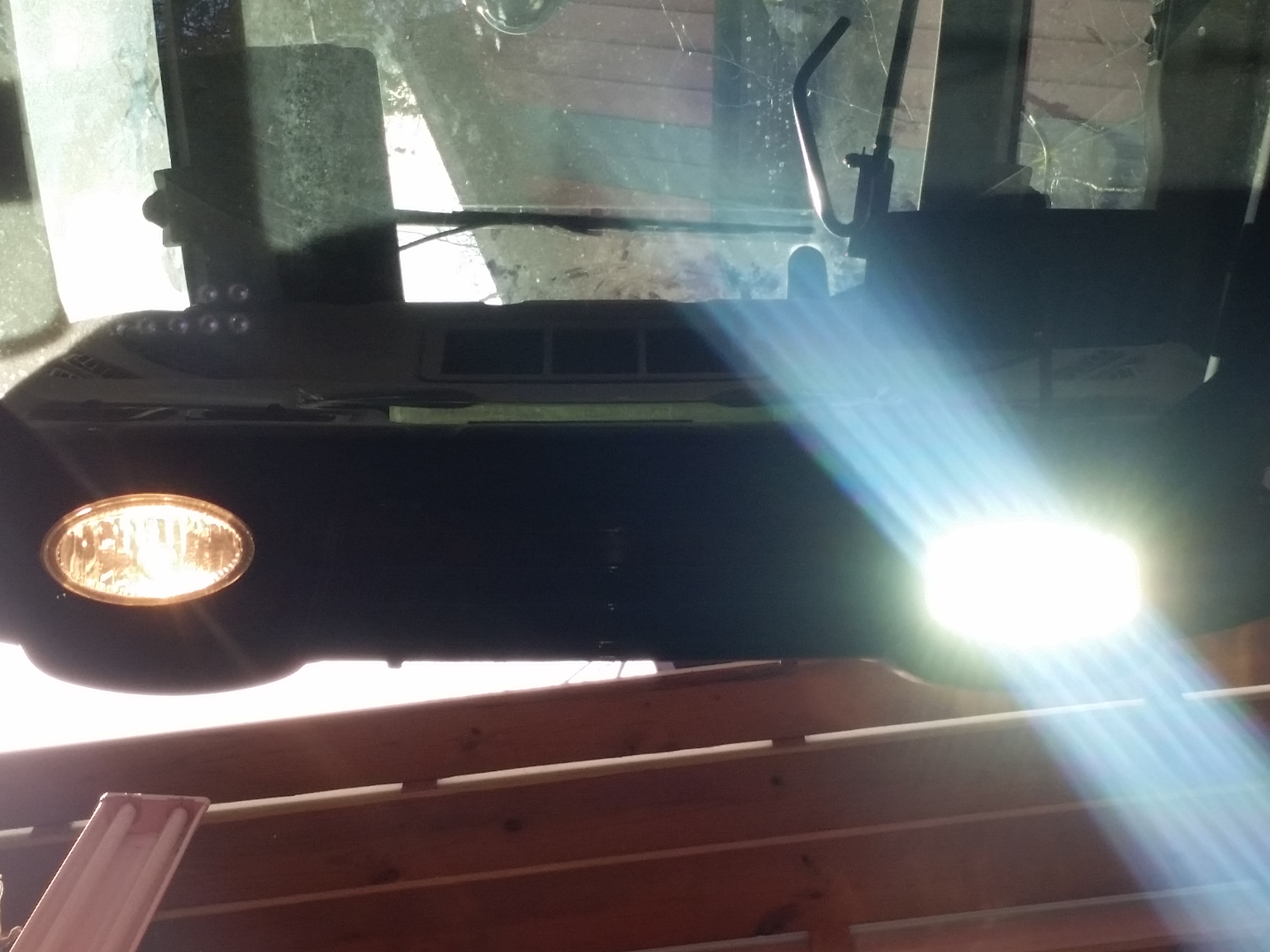

LED vs Halogen
Cab LED (3600 lumens)
Kioti NX headlights only
Headlights on and LEDS on.
Posted from my phone so hope pics aren't upside down
