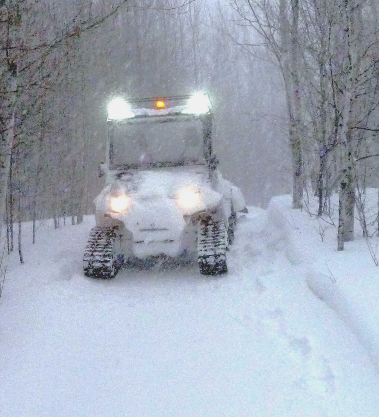

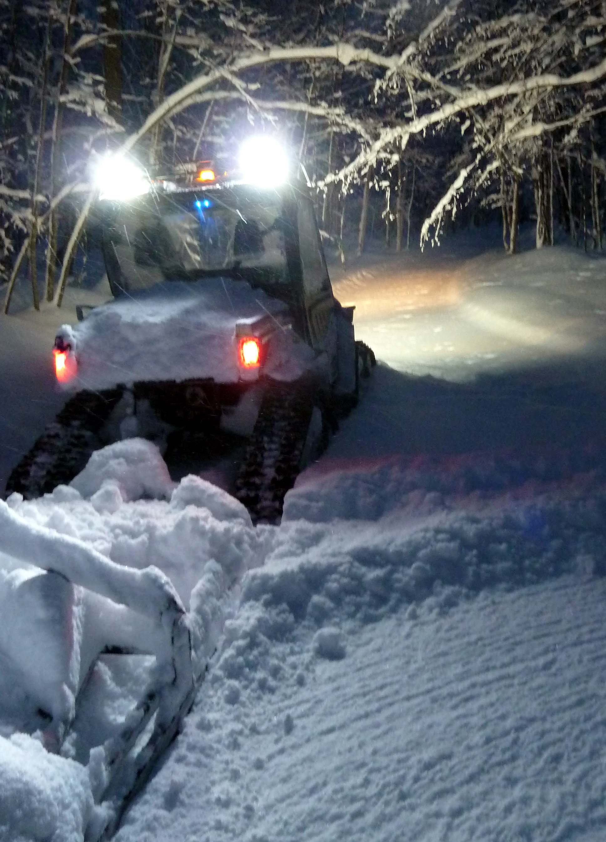

We work in snow lots and following is some points that we've learned. Spots are better than floods and they are our preferred lights. Nonetheless, snow has such high reflective characteristics, it seems to make little difference which we use. LED's do become warm and snow will stick to the lenses, but much of the light still passes through it. I'll attach a couple of photos with lights. Hope that helps.
