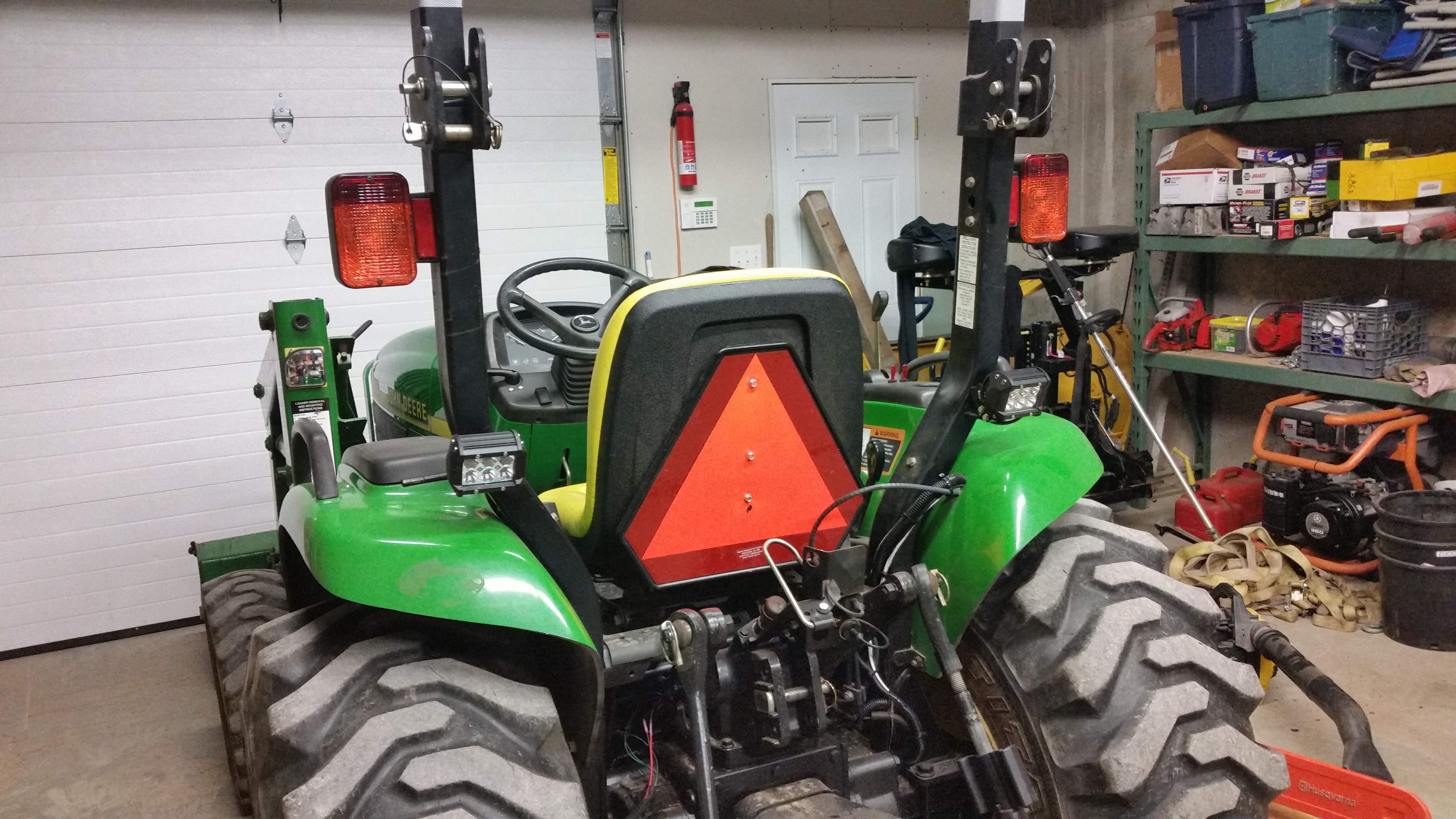

Hello again everyone!
Well, Since I have put some "Extra" lighting on my tractor "JD4300" I want to upgrade the standard headlamp GE-885 with LED or HID. I bought some LED lights online, plugged them in and they look nice in color to match the rest of the tractor but are about as bright as some people at the place I used to work, meaning "they suck". I have a 30 inch Rigid mounted to my ROPS, and that eliminates the need for headlights anyway. Sometimes too bright!!! I'll get some pics up soon. Any suggestions would be appreciated!

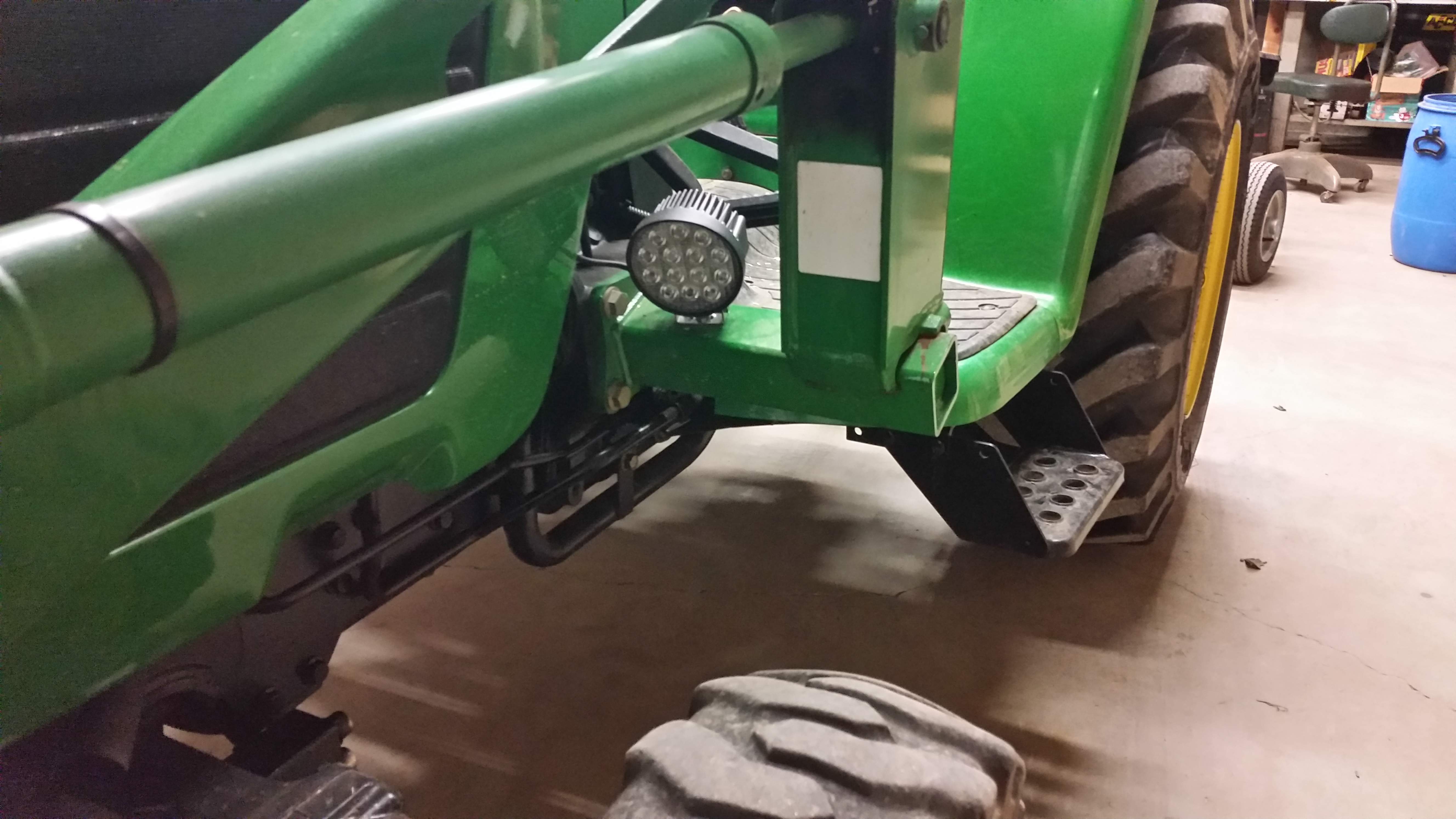

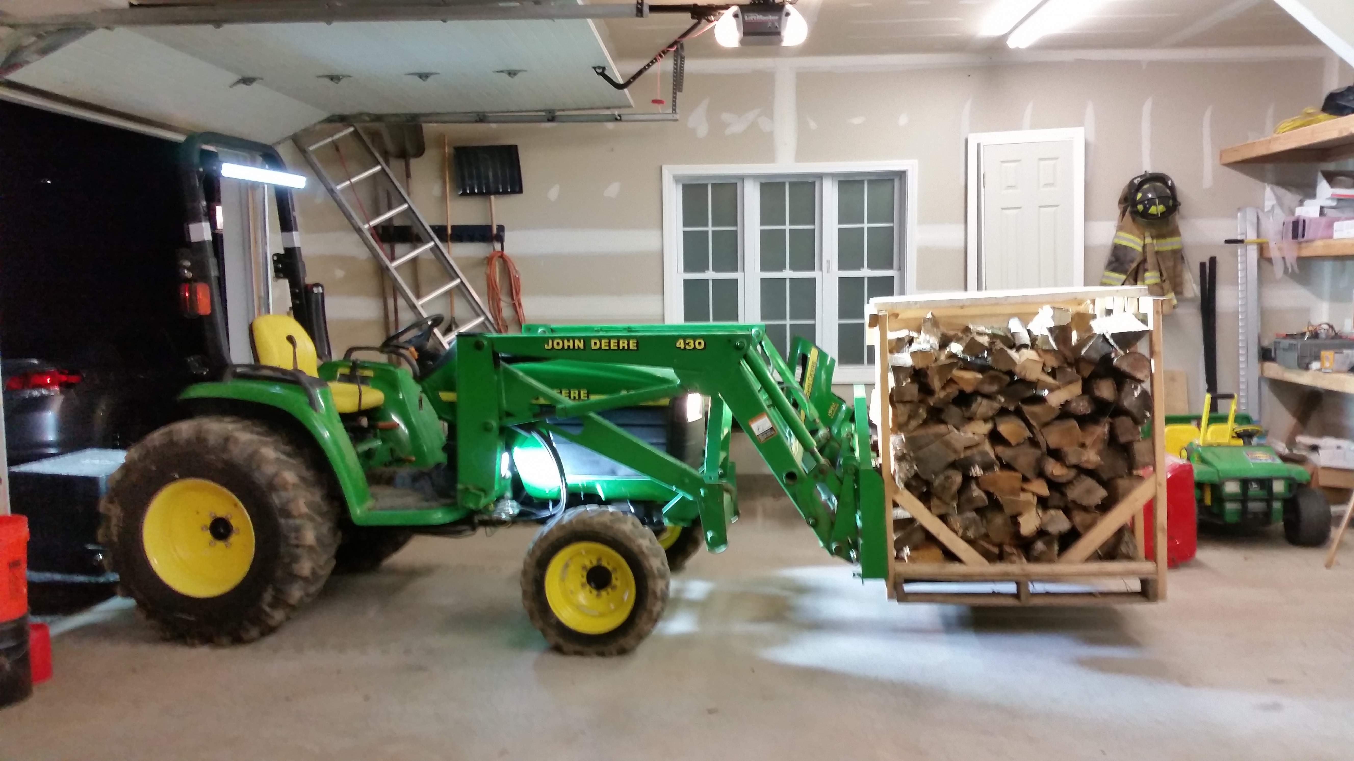

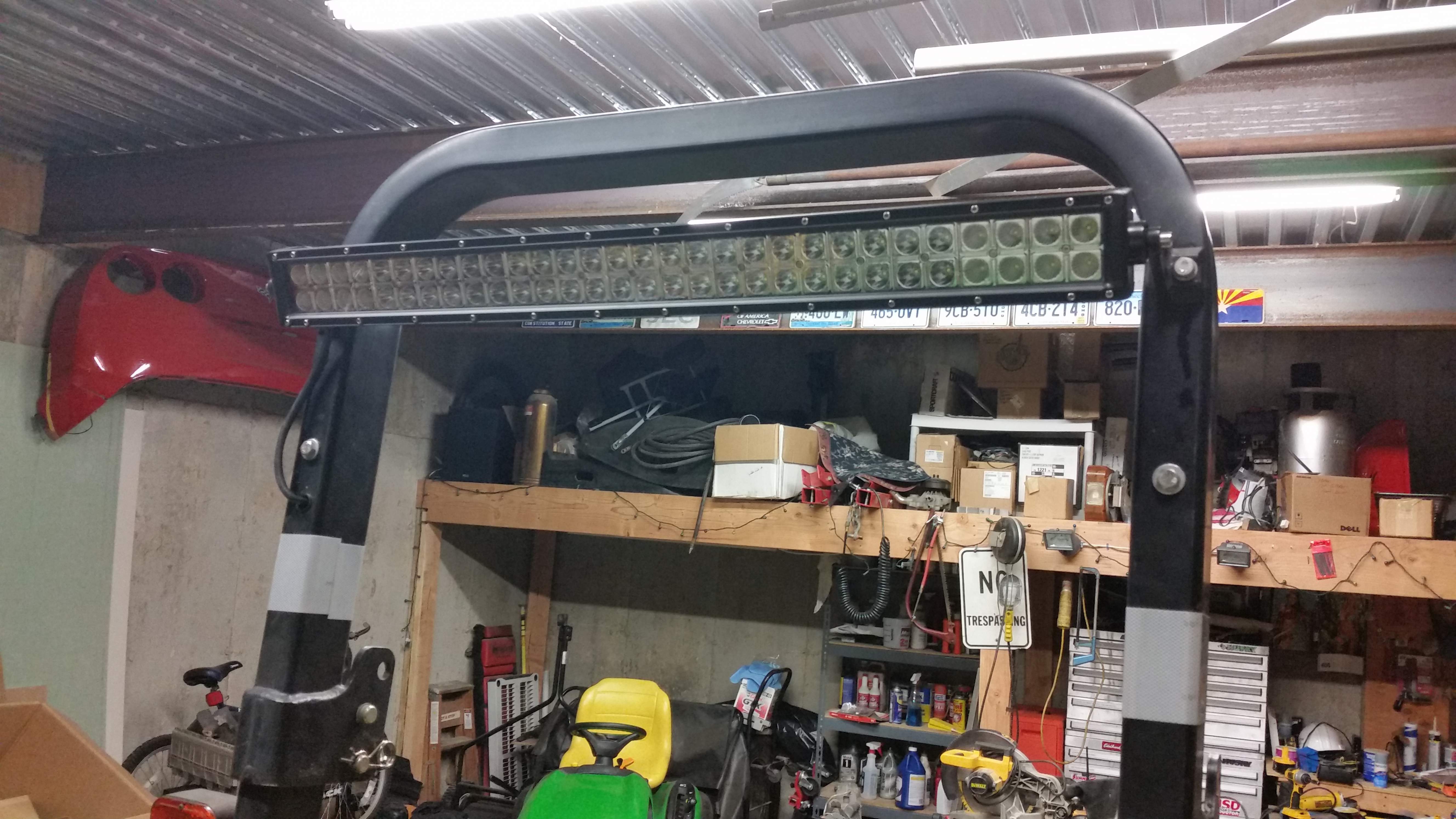

Here are some of the pics

paulcapasso, the led light bar looks great.

You added extra LED's to rear..happy with those
You added extra LED's to front, happy with those
You added a long LED light bar to ROPS, happy with that, if anything, too much light

I guess you are solving a cosmetic concern for your weak headlights which are blocked by the FEL load of wood, as shown in your photo.
