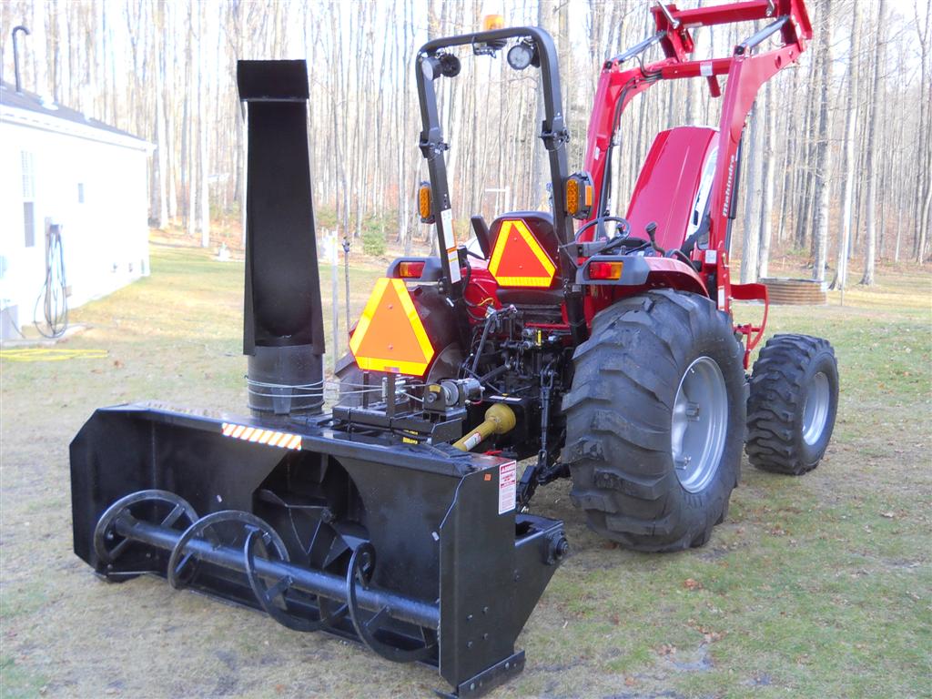

Last nite at TSC I saw a led lite bar for $130. It was 3000 lumens at 980'. I think it said 30 watts but I could be wrong. Does this sound good or junk. It was on the Christmas specials shelf.
I don't use the tractor at nite much like some do to push snow. Maybe putting out round bales or getting back to the house. The push bar blocks my hi beams and cast shadows on low beams. I thought about cutting. And changing the push bar but can't seem to find a design I like.

Ok thanks. I'm not sure a light bar will work anyway. I want to put it inside the rops. The look too narrow to do that with.
   / Led lite advice #5
I put four 27 watt round LED lamps on my ROPS several years ago. I don't really use my tractor at night... but the bright LED's [ along with flashers and a rotating beacon ] make me feel safer when I work out by the road moving snow in the winter.... especially when the snow is blowing hard. Maybe help some idiot blasting down the road to see me. They also help when I am changing attachments in my barn, light up the area real good. There are lots of brighter ones on the market, but a 27 watt LED flood puts out about the same amount of light as a 50 watt halogen flood, and don't use much current. The best prices I usually find are on EBAY. They are mostly based on a 3 watt CREE LED, which the 27 watt have 9 of. The 48 watts have 12, etc. Four of the 27 watt use about the same current as one 50 watt halogen flood at 13.8 volts. I took the factory 50 watt halogen work lamp off the rear of my Mahindra and used that circuit to hot up the four LED's.. You can get four of the 27 watt lamps for way less than that $130 TSC light bar...
I did the same except on our RTV900 which is used for snow removal. I put two LED spots facing straight out and outboard of the spots I added an LED flood at a slight angle. The work lights in your eBay link look just like the ones I added a few years ago. Still working, water tight and vibration resistance. The stop/flood combination provides a great deal of light with nearly 140 degrees of coverage. I also added two floods to light up the back.
