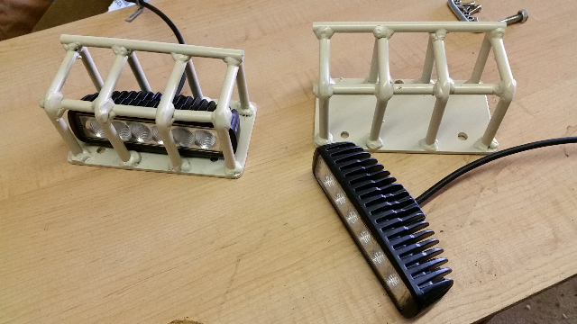

They are the same to hook up,I would switch everything you can to LED..they are pretty much impervious to vibration and like was said use a fraction of the power for 2x the light output. I replaced my pair of 55 watt halogen lights on my Ventrac with a pair of 18 watt LEDS and the output is 2-3x more powerful and the light is whiter an so much brighter and it uses 36 watts as opposed to 110..also LED lights work the same from 10 volts to 30 volts ..I built these guards for my amazon lights 18.00 a pair .
