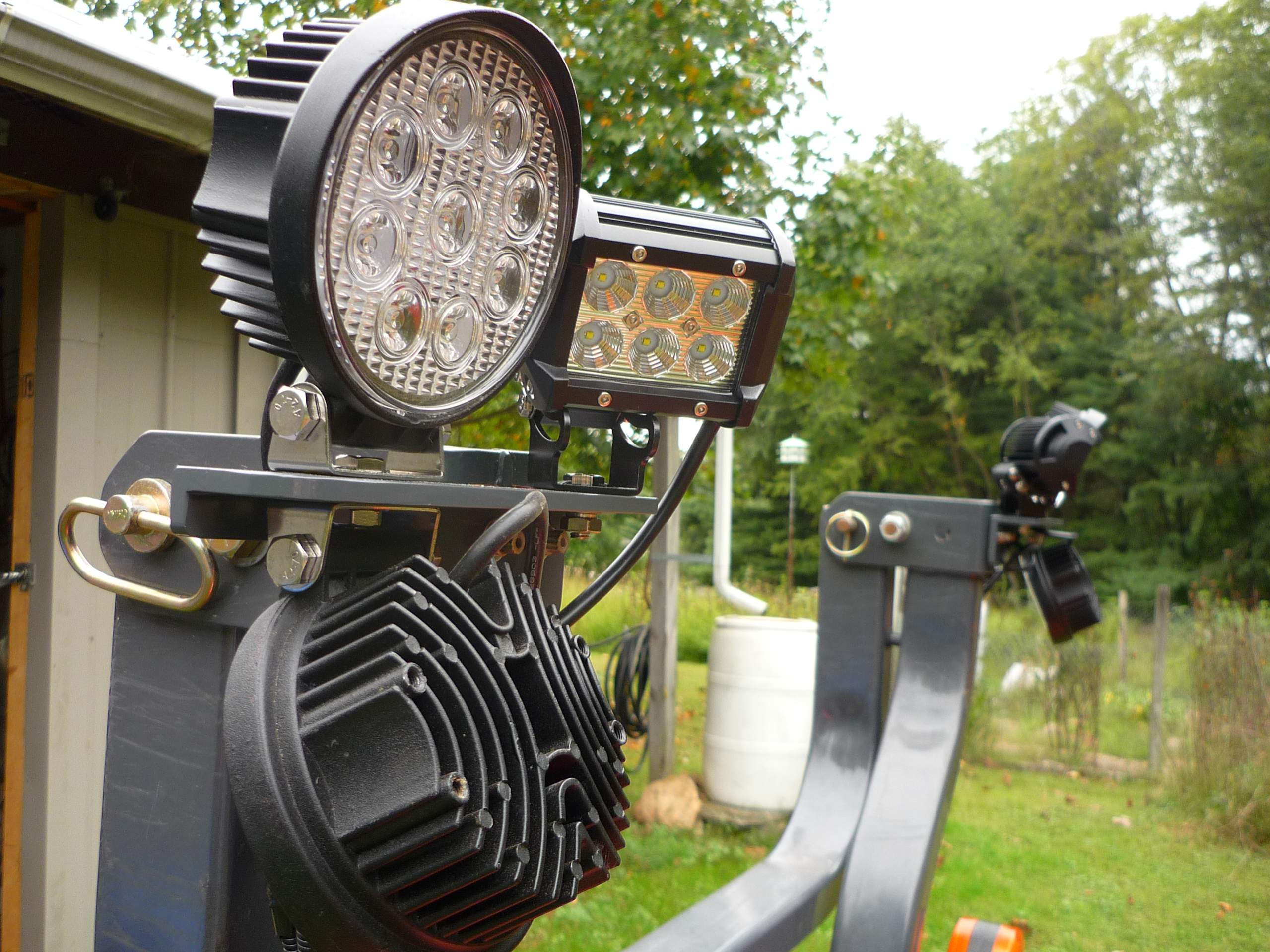

I think floods are generally the way to go, since you aren't going down a road at high speeds, but moving thru who knows what at lower speeds- you want to see as much as possible. To that end, I just added some 18W flood "side" lights to my front and rear 27W lights. I had to make some new aluminum mounts to locate them all where I wanted them for best aiming. I like them up fairly high, so a loader or plow doesn't simply block the light. The price of these various LED lights has come down to the point of ridiculously cheap... the 18W can now be had for under $9 each delivered!
