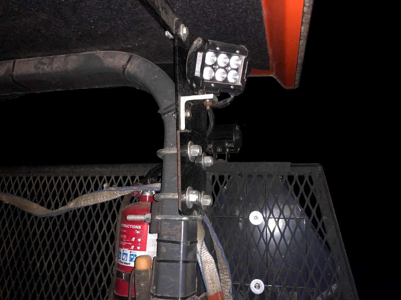

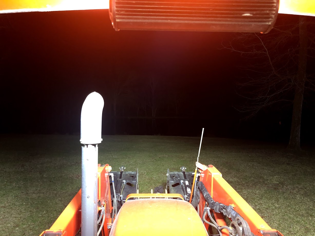

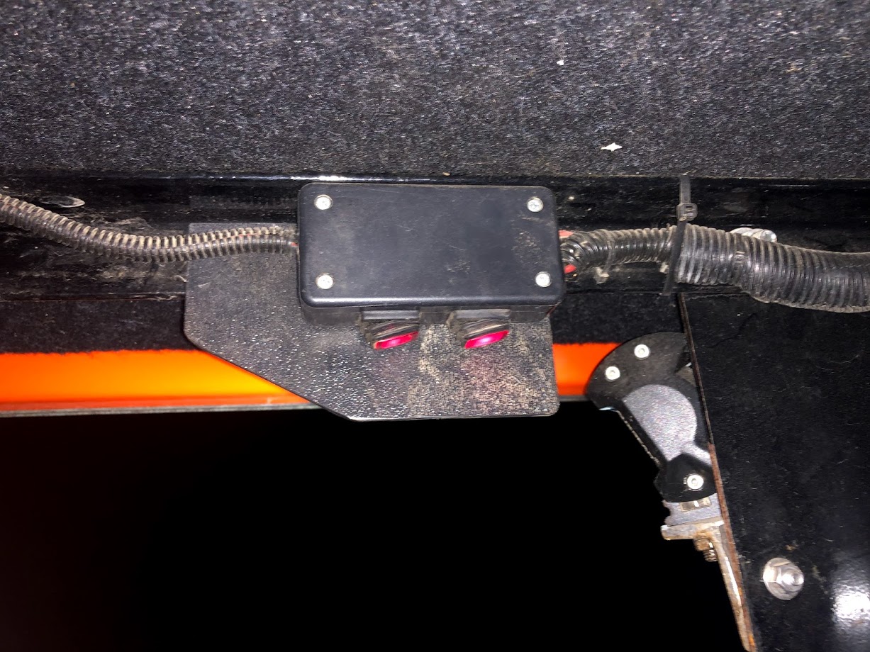

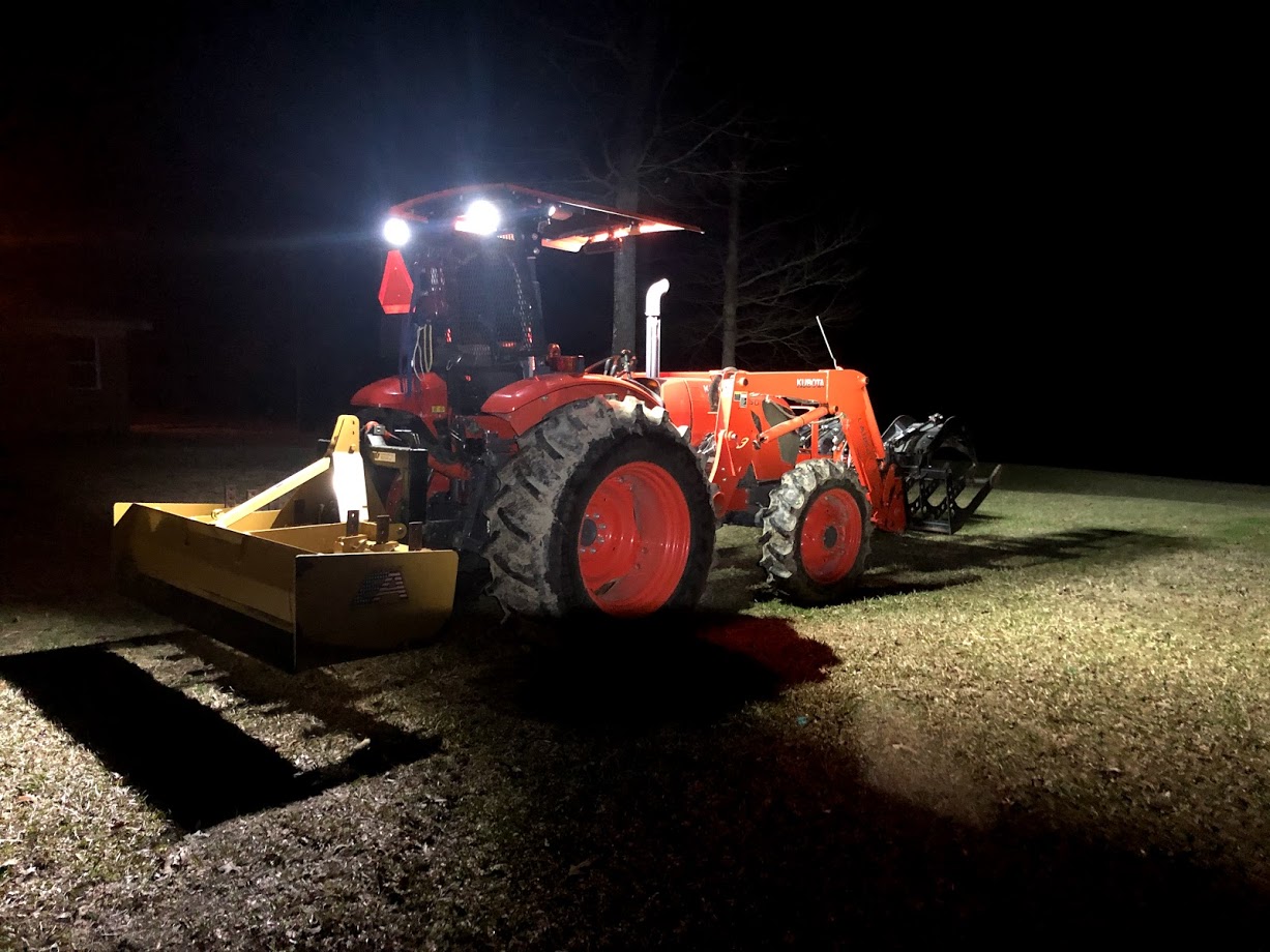

This is how I set mine up. Used the canopy and canopy mounts for mounting the front and side lights. I used my home made headache rack for mounting my rear lights. I tied in the factor power in the back for auxiliary lighting and ran it to a box I got at radio shack and mounted water proof rocker stitches in it. The front switch for the front light and the rear for the sides and rear lights.
