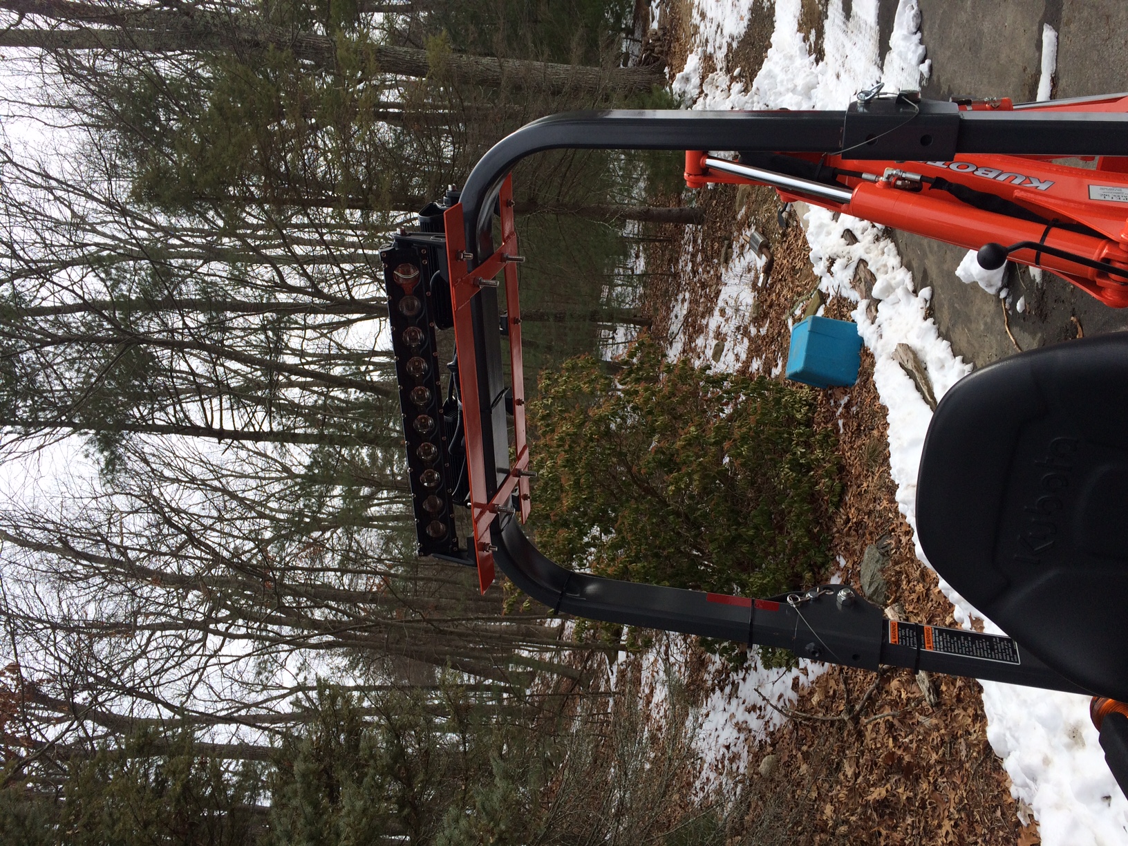

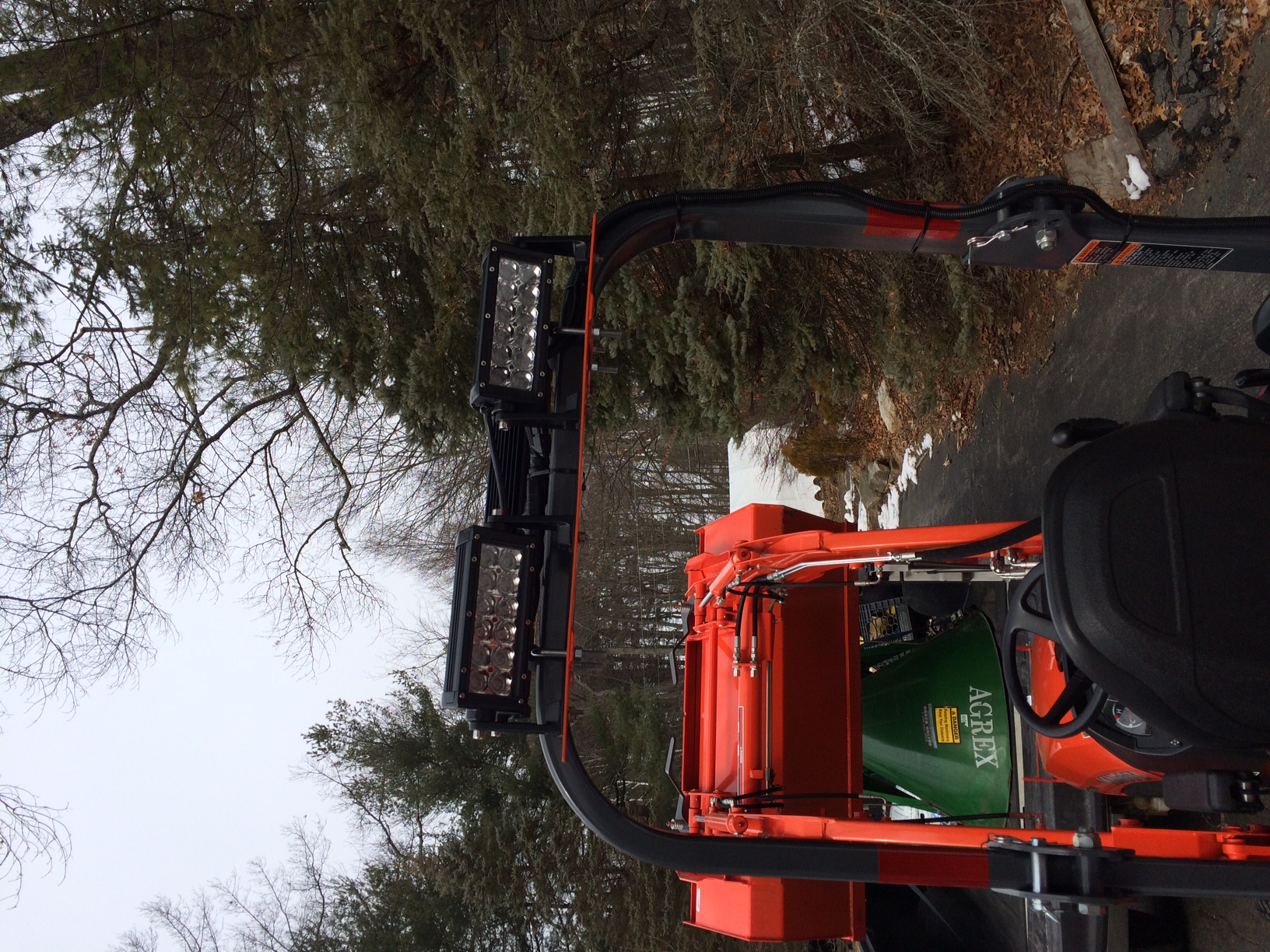

Could do as I did, I found it saves a large hassle of getting switched power to the rear.
Replace the fender mounted work light with a small LED. Route power up the ROPS from there and hook in the additional lighting. All will come on with the factory work light switch. If you're smart, you got the smaller pods that can be pointed where needed rather than a the light bars that are bracketed on both ends and not adjustable.
I made that mistake at first, put one on top facing forward and on me on bottom facing rear. They worked and made a lot of light, but put a lot of light in places it wasn't needed and attracted a great many bugs. I've since switched to a pair of smaller lights that can be rotated or tilted so they can be used front or rear, right or left, up or down. A much better solution for real work. The only thing the bars excelled at was parking at the corner of the garden on cool evenings to do some night time hand-pick harvesting, to light up the garden and attract the bugs over to the tractor and away from me. The new lights should do fine at that too.

Thanks that's what I was looking for. Mostly need it for the back special during the winter.

Mines a 7" so it mounts on both ends but I an make a base for it so I can use the magnet
