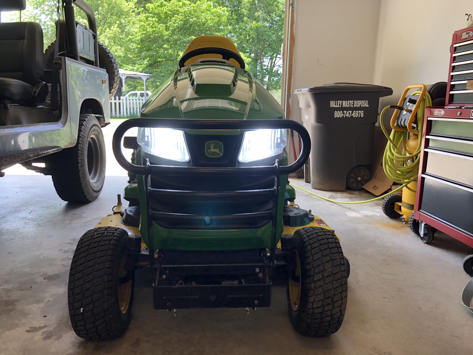

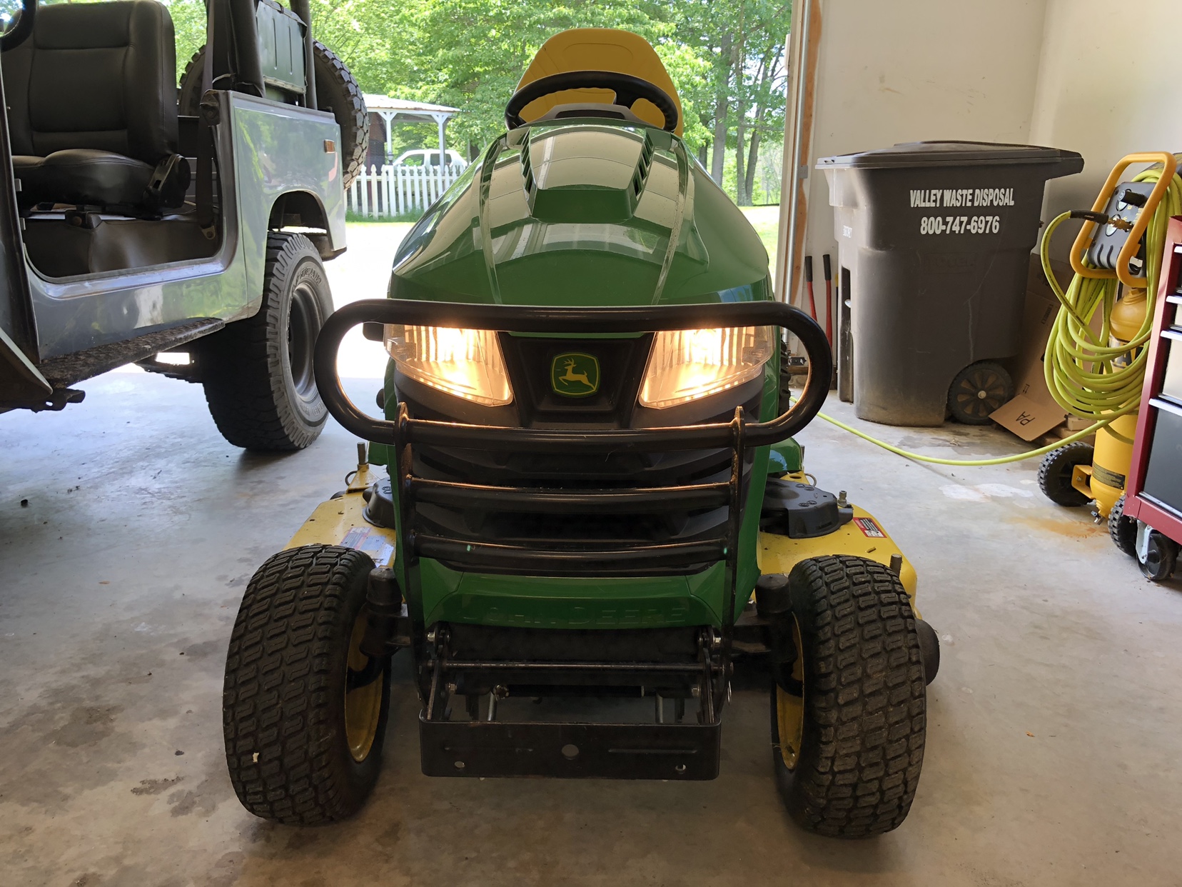

I replaced the halogens on my X590 with these. Worked great, night vision is much improved:
LUYED 2 X 1700 Lumens Extremely Bright 1156 4014 102-EX Chipsets 1156 1141 1003 7506 LED Bulbs Used For Backup Reverse Lights,Xenon White(Brightest LED in market) https://www.amazon.com/dp/B01H54SP6O/ref=cm_sw_r_cp_api_i_CszpDb1V9NM5K
