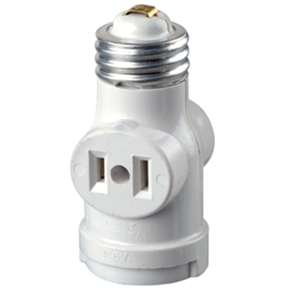

I use my 2 GDOs as "path lights" so that I don't have to switch on all of the 16 or so fluorescent fixtures just to navigate through the basement. I even added a LED 4ft shop light (Costco) on each one on about a 10ft extension cord with one of these
The combined length of the bulb and "adapter" was so long that I needed to leave the lamp cover off. No problem. Since I often leave these on for extended periods (overnight), I wanted the low power consumption of LED bulbs in the GDOs also. I think I used the cheapest available at Lowes (Utilitech).
This setup has worked perfectly for several years now. The GDOs are Liftmaster.
