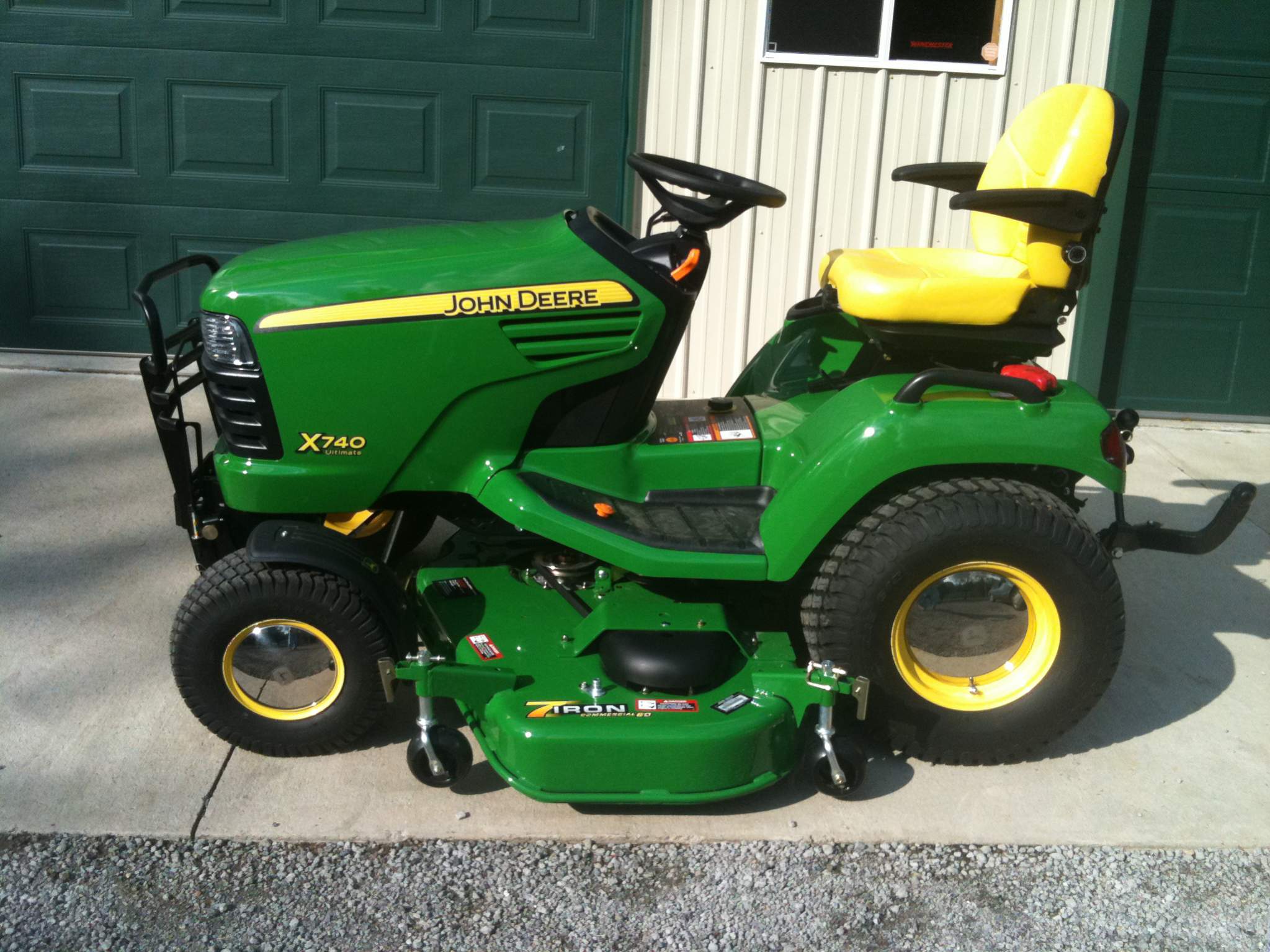

Had the same problem with my kubota pro 326 ZTR 60 inch deck with 25HP diesel.Ended buying a 2011 john deere(diesel) X740 lawn tractor 60 inch 7 iron deck (filled back tires with rim guard).Its turns very sharp and does not cut in like the ZTR did.IMHO best darn lawn tractor on the market today.coobie.
