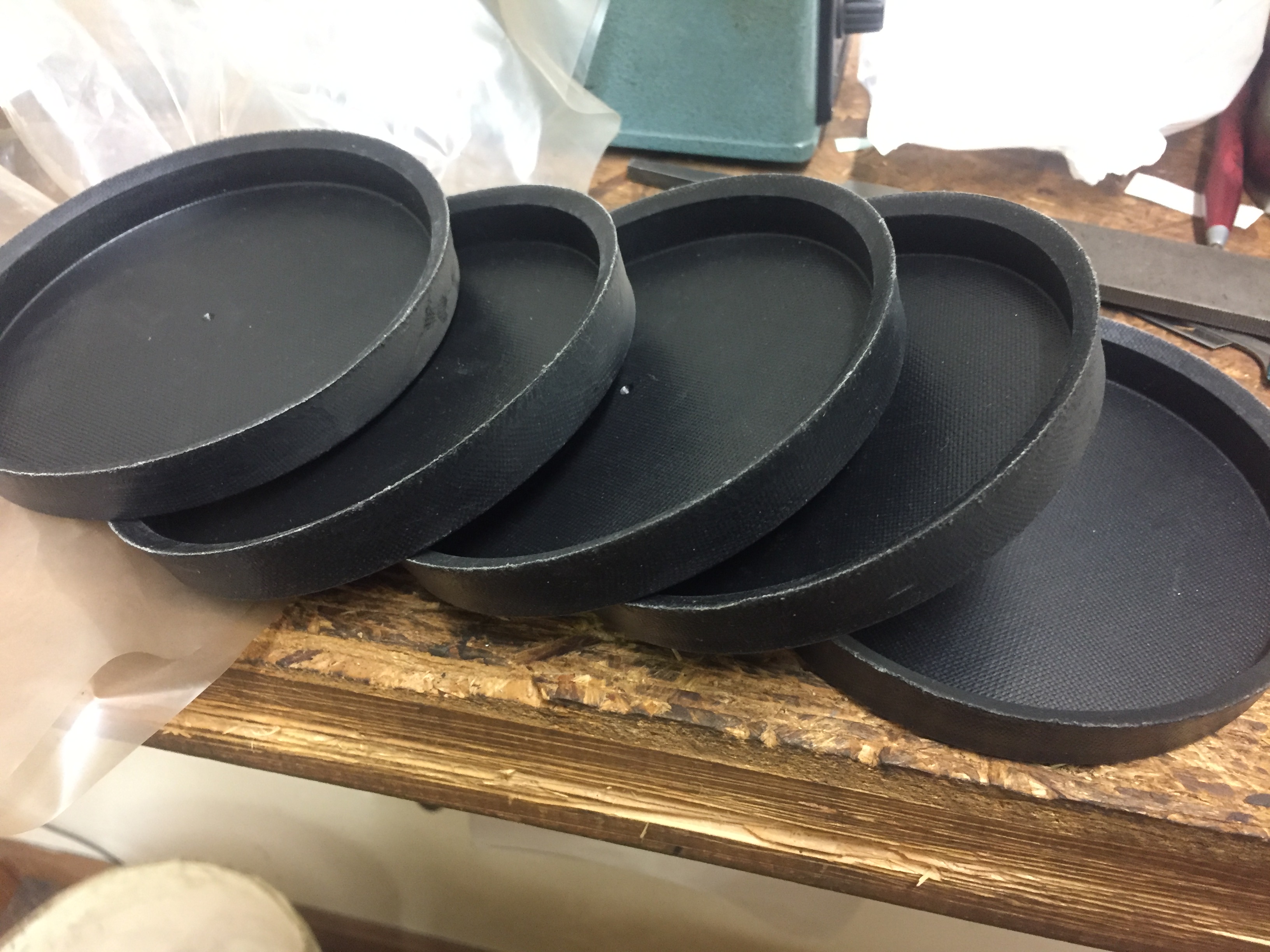

Hi everyone,
Sprung some leaks and so I will have to get into repairs now, rather than later.
In the parts book for my Davis 185 backhoe cylinders, it mentions leather cup. How do you go about figuring out what kind, size etc.
Thanks,
Don
   / Leather cup? #2
I think you will have to take it apart and measure the cups...McMaster-Carr
   / Leather cup? #3
Your local well stocked hyd shop will have these in stock usually without the center holes. They will cut the holes to your dimensions. EZ PeeZee.
   / Leather cup?
Thanks for the tips.
   / Leather cup? #5
Here’s what they look like without hole
