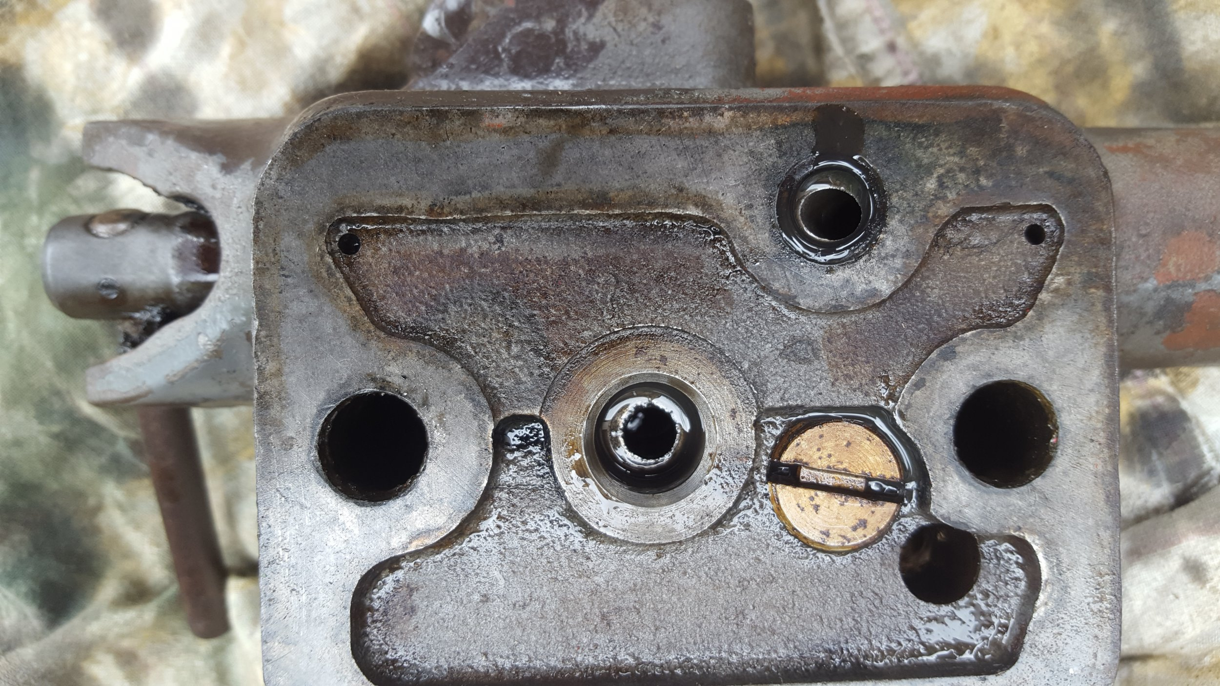

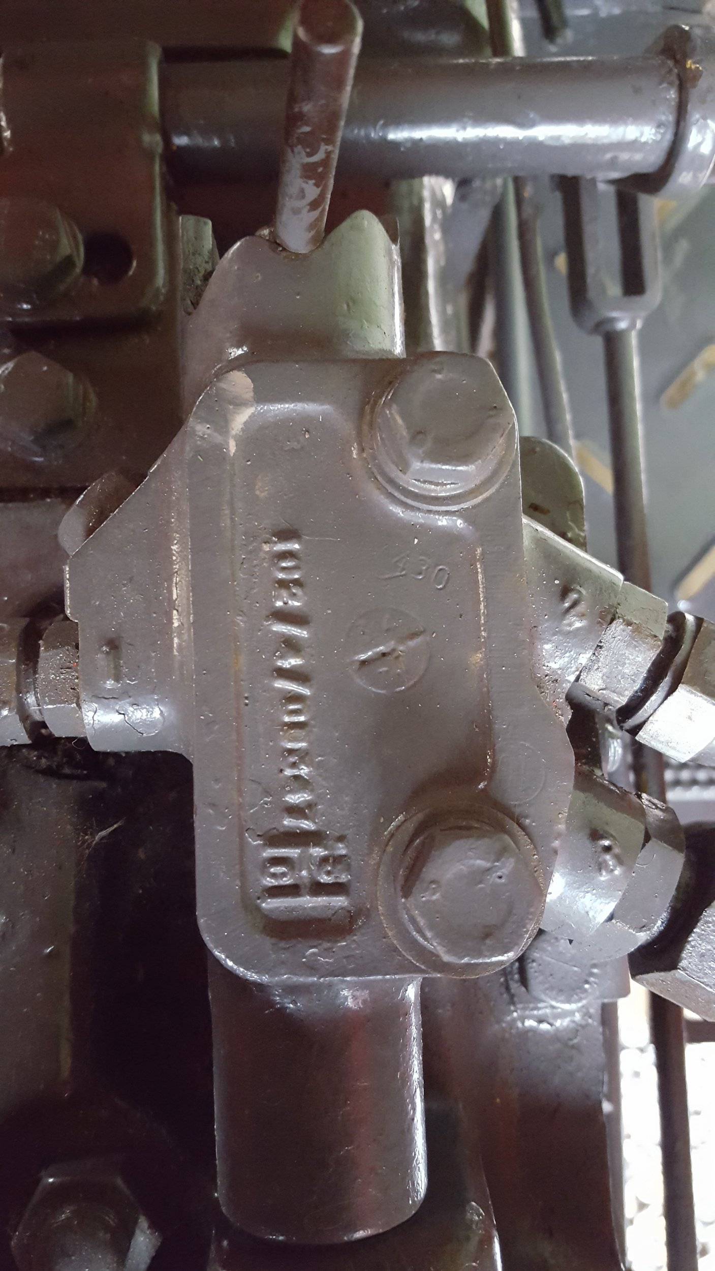

I have a 1970's MF 135 Industrial with a leaking hydraulic diverter valve. Oil is seeping out around the control lever shaft when in the front loader position.
Just wondering if anyone has any experience of dismantling this type of valve? (see photo attachments). I assume there must be '0' rings inside but cannot work out how to dismantle. On the underside there is a large brass slotted screw head but not sure what function this has.
Any help/experience on this would be greatly appreciated.

Does the round can opposite the control lever come off? Probably springs and/or a snapring in there. Pull the spool out and there are probably o-rings that seal the spool to the casting
