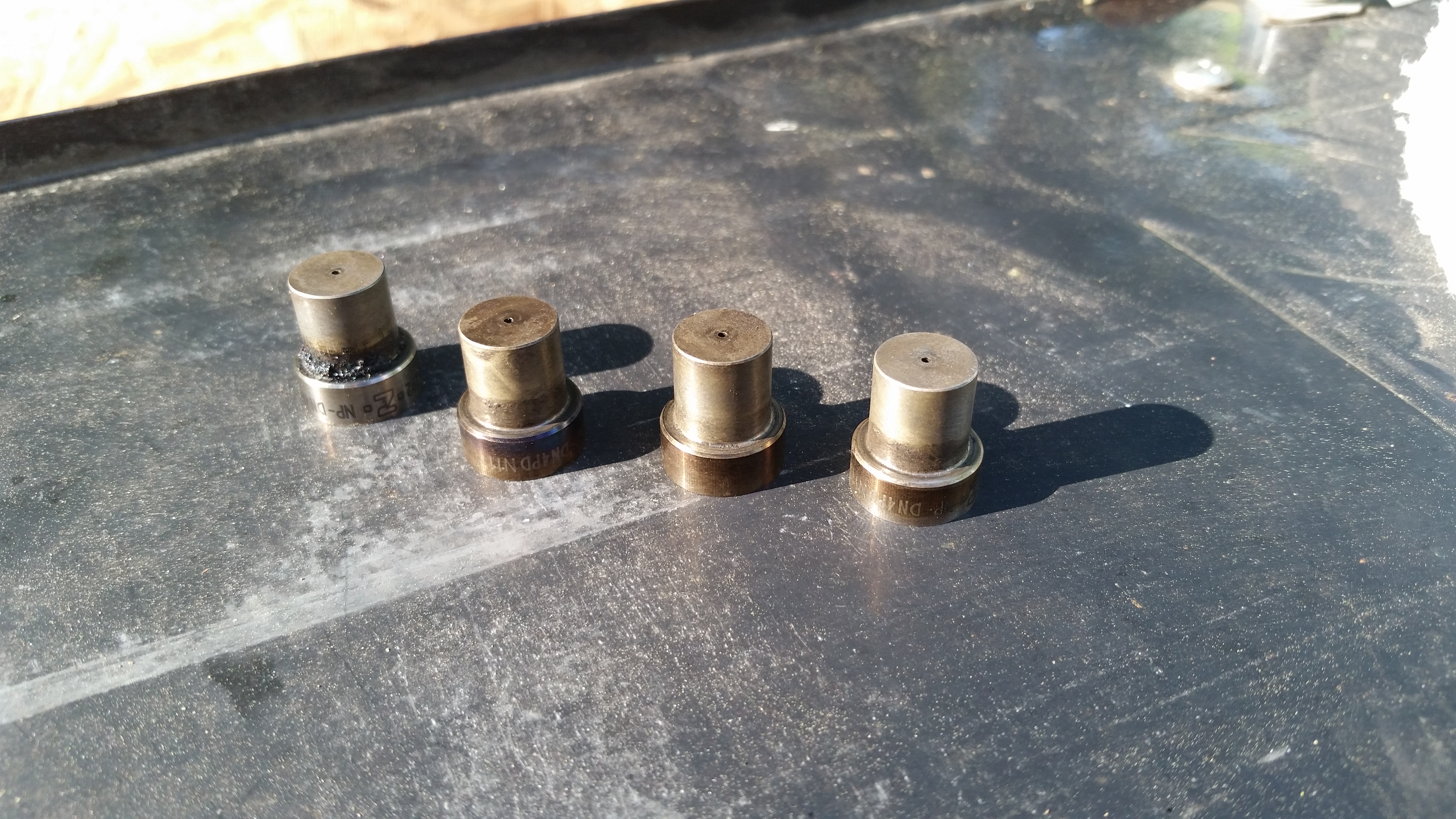

Have a NH TC40D here. Started having a little blueish smoke and an odd knocking sound. So I disconnected each injector to find which one may have fouled out. Cyl #2 when disconnected stopped the knocking sound.
So I ended up taking all the injectors out as when I disconnected the fuel rail it broke due to corrosion. So I wanted to make sure they were all cleaned and all signs of corrosion or buildup were all removed from all connected pieces.
Disassembled the injectors and cleaned them all out. Used a copper brush to remove any problem spots. Reassembled the injectors and cleaned all threads of every connection; injector, fuel lines, ports. I did notice that a couple of the injector nozzles were discolored (included pics)
After getting everything put back together and primed, the tractor cranked up and ran fairly smoothly, like it had before. However, there is still a slight blueish smoke coming out. I also noticed that there was wetness around the injectors; so I super cleaned around them, checked the connections again, wiped everything down dry on the block, injectors, lines. Starting the engine, within seconds, between the block and head there starts to be a wet line the length of the parts.
I recorded the dry gap getting wet while running.
Any idea how it's getting wet or what it is? I can't tell right now if it's oil, diesel, or water. When I wipe it down, it is dark; but I dont know if that's from some grease/dirt from the block.
Could it be a failing head gasket?

Update on work:
I checked each cylinder by disconnecting the pressure line one by one. The same cylinder was having issues as before. I am not sure that I got the injectors back in the same cylinders as they were before; most likely not.
But, when I disconnected cylinder 2, the smoking went away. As did the slight popping at idle.
Also, when I took cylinder 2 injector out, I noticed the nozzle had some oil residue build up on it. Now, the engine had only ran for maybe 10-15 minutes tops after having put everything back together. It wasn't driven, and wasn't ran much higher than idle (the cable is currently disconnected and hand revving). I didn't pull any other injector out as I was testing to see if maybe I had by chance put the same injector in cylinder 2 as was already in there and it was still fouling. After putting the replacement injector in, cylinder 2 was still acting the same way.

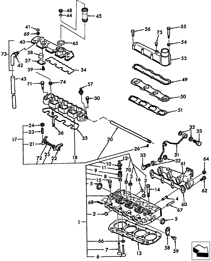

I'm confused- your video shows the injector and the "cylinder head" leak ABOVE it. But all the tractors I've owned or looked at had the injectors in the head. They kind of have to be as the injector fires at about TDC. (ok I could come up with a stepped piston that would allow the injector to be on the cylinder wall but it'd result in a poor combustion chamber shape. Or the head could be one piece like on a chain saw or early gas engines but that's hard to manufacture).
That joint doesn't look like the valve cover though I could be mistaken about that. Could the head be one of those two piece ones? Seems unlikely as that's normally done on DOHC heads not simple pushrod two valve ones.

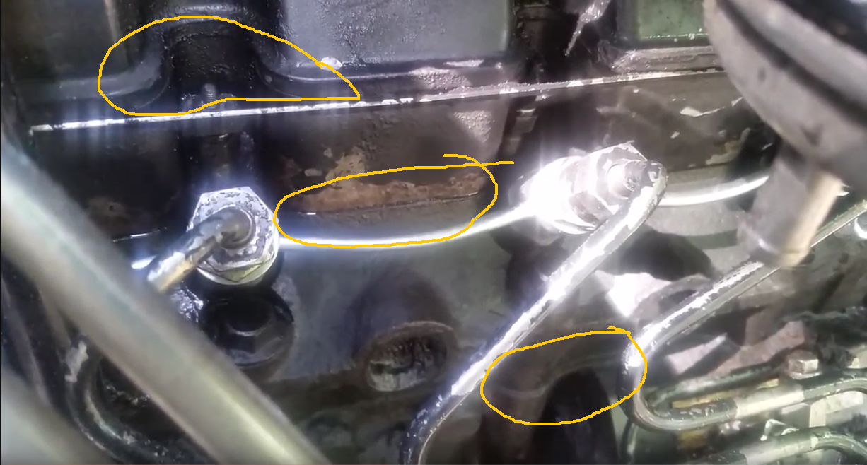

I hadn't looked at it, and didn't think about it, but I think it is a split head. *was tryin to explain it, but I think a picture is better served here :p *
I circled the sections of the motor from block-head, head-head, head-cover. I also included a picture of the head parts assembly. As you can see it is in 3 parts total for the head section.

eric: I'm actually glad you asked this question. I didn't realize the head was 2 sections. After thinking about it, the problem is probably not quite as severe as I had originally thought it might be. So, it's not a head gasket, in the traditional sense from a more familiar block-head gasket. It's between the two sections of the head.
So, with that enlightenment, could it be that the upper gasket is leaking oil down into the chamber through the valve or some other means? I'd like to try to figure out what I might be needing to look for before I start pulling the top of the motor apart. As the tractor is usable right now; so I don't want to shut it down and find something else is possibly wrong and have to wait longer to get it back up.
Thanks for the input,
Kori
/ Leaking head?? #19
Dang, it is a two piece. The upper part is the rocker box. Your problem gasket is #35. It's just leaking to the outside, not the combustion chamber. The valves are already operating in oil. Often there's an oil seal on top of the valve guide (possibly its #8, it looks too short for a guide). Sometimes the tight clearance between the valve and valve guide is enough to keep most oil out of the combustion chamber. The oil in the rocker box is not under pressure and there's not a huge amount of it. I'd be leery of oil additives that plug leaks. What else do they plug?
It should be pretty easy to replace the #35 gasket though you'll need to loosen the valve adjusters before removing the rocker box and adjust the valves afterwards. You'll probably want to replace #34 too.
In any case I don't think the gasket weeping is causing the rough running problem.
