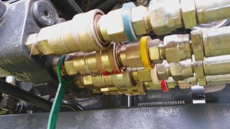

OK, I've got a hydraulic line leaking and could use a little guidance.
This pic is under the tractor, just behind the right-side step. The leak is on the 2nd line, the one with the yellow color code.
It appears to be leaking from the actual connection of the 2 lines, and not from the line side of either connector.
I've tried disconnecting and reconnecting the line - still leaks.
   / Leaking Connection .. What to do? #2
Replace the coupler and connector on the hose
   / Leaking Connection .. What to do? #3
If you look inside the female coupler when the male is removed you should be able to see an o-ring. It maybe by itself or there may be a nylon backing ring in there too. Replace them both and you should be good to go again. Make sure you install the new rings the same way the old ones came out. If in doubt look inside one of the non leaking couplers.

That is what I was hoping to hear, before I had to resort to Boomer's suggestion of replacing the hardware. This is my first tractor and I'm still on a uphill learning curve :)

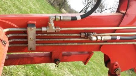

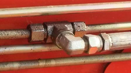

I've got one other leaking issue - pic below - that I could also use some info. This one is a line on the FEL. The lines are close together and there is NO getting a wrench in there to tighten the fitting. I suspect I need to open the mounting bracket in order to spread the lines. My question really is about torque. Just how tight should these fittings be, as I don't want to strip them or kink the lines?

Your ideas are all on track. I would take the hose off of the elbow to give yourself some more room. As to how tight... I just know by feel as you need special tools to get a torque wrench in there so I would tighten it up until it quits leaking. If the line has a crack in it tightening is only going to make the leak worse and then you know that you need to either replace the line or take it to a shop where they can put a new crimp or flare on the end that leaks. Good luck
   / Leaking Connection .. What to do? #6
I would think that those lines are flared, either single or double, and not compression fittings. I'd take them all the way apart and inspect the flare. Maybe somebody has already tightened them to hard and cracked the flare. If cracked, a new line or if enough line left, cut and do another flare. As mentioned, how tight is more than snug but not as hard as you can tighten with the standard length wrench that would fit those. It is a feel thing.

I agree to try the O-ring replacement before the fittings replacement.
Release any pressure in the lines by moving the FEL lever in all directions before disconnecting any lines/hyd hoses. Hyd fluid under pressure will penetrate your skin and can be deadly when in the bloodstream.
If the O-ring thing doesn't do the trick I'd swap out the male fitting with hose to the next position to see if it is the male or female QD that has failed. Warning, swapping out the hose with fitting to the female on the valve body may make a particular function in the opposite direction on the FEL lever while you perform the test. That area of the tractor is pretty vulnerable to branches attacking it and rendering the fitting(s) disconnected without notice. Some TBNers designed a skid plate to stop that from occurring, but the plate is different for different frame configurations, so it never really caught on. I may venture into a design of a different approach to this issue, but can't say when I'll have time to do so.
On the FEL fitting I would first wrench loose the hose connection and plug it so you don't get dirt in it. Then see if the T connector fittings are loose where they attach to the T along the FEL arm. You can possibly get a wrench or a small crescent wrench in between the lines enough to determine if something is loose. If you can't determine if the caps on each of the hard lines are loose then you may have to detach the blocks and crossover tube's metal shield to possibly allow enough slack in the hard line to pull it carefully away from the FEL arm to allow enough room to wrench it tight if it's loose, or remove it to inspect the entire fitting for damage/cross threading/cracked fitting or hard line.

The coupling under the cab has a definite leak ... drip drip drip.
The FEL connector is not so obvious. You will note the fitting, the lines, the FEL arm are coated with an oil film. The film actually runs down the arm all the way to the bucket. I believe, while under pressure, it is worse but I still see only the results - with oil spots across the tractor hood. And, while I never see actual fluid ... it does create a small oil pool on the floor over time.
