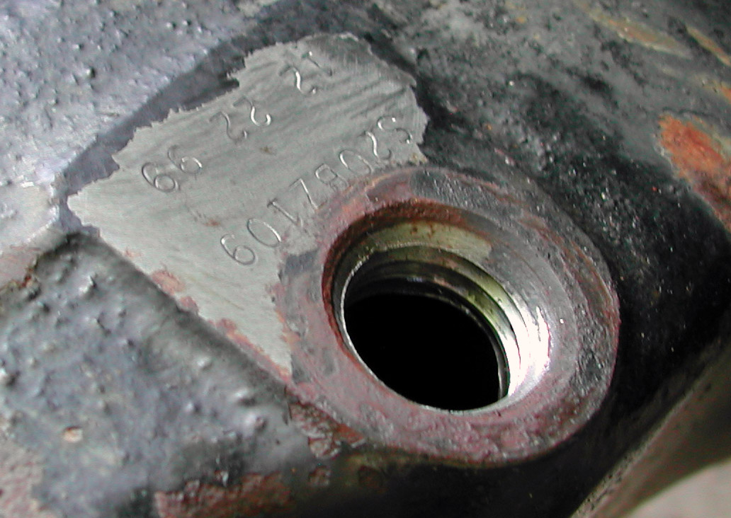

I am placing an order for some JD parts, including the 2 axle seals,
kingpin pivot, and wheel. Like you saw GRAF, the stamped number on the
axle casting (12 22 99) is nothing like the choices listed in the parts
book, e.g. "S20BZ105-1". So I am not sure what to order. There are
several different seal part #s....

I found the Axle ID....it was buried under paint and the axle oil dipstick
had to be removed. The JD dealer I am using for parts presently had
some additional info on how to find the stamping. All I could see before
removing the paint was "12 22 99".
There are several differrent axles used on these Deeres, so you must have
this # before ordering seals.
