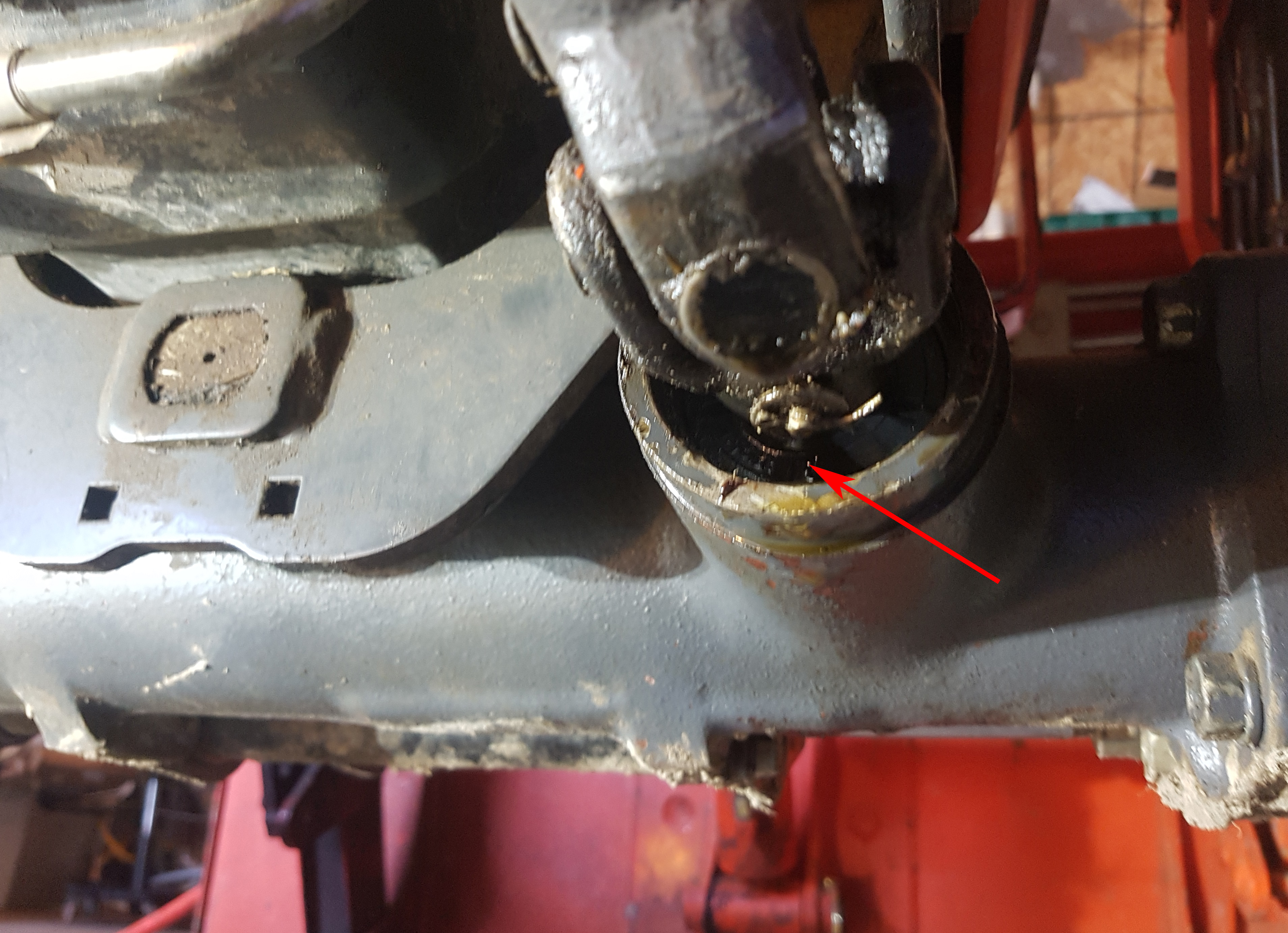

Recently i have big leak from front axle propeller ( I am not sure is this proper name). It under front axle cover by plastic tube.
How can it be fixt . Anybody can give me a few advices.

From the look of it you may just need a new seal. If you can drop the shaft you may be able to pull the old seal and drive a new one into place. Check the parts breakdown for that model to see for sure how it goes together. You can get the part number there though seals are pretty universal. If you can read the number on the old seal you can purchase the same seal almost anywhere.

Might help if we knew what tractor you had. Take some more pictures and post them too.

Is that oil from the housing or grease being slung from the U-joint? :confused:

From that pict., looks like a new seal will do the trick...
Like was said, drop the drive shaft, pull the old seal, clean everything up and tap in a new one...

I have found with these exposed seal designs grass and debris can be wound up on the pinion (or axle shaft) and take out a seal. Does the differential still have reasonable fluid in it?
