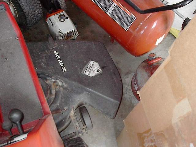

I've wondered about these. How do they hook up to the mower deck? The reason I ask is my Toro has a big metal chute instead of a plastic affair I see on most mowers.

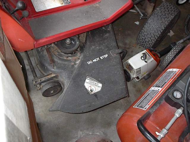

The discharge chute on the deck is all metal and takes up the entire side of the deck. It's shaped to spray the clippings in a fan pattern. I'll try and get a pic tomorrow in the daylight.
Most mowers I've seen lately just have a hole in the side with a rubber chute to deflect debris and clog with grass.
   / leaf vacuum agri-fab #6
Here we go... Pardon the mess, Still recovering after the move.

   / leaf vacuum agri-fab #7
another...

   / leaf vacuum agri-fab #8
Scott,
Instead of mounting the vacuum chute right on the end of the deck It looks like you could cut the hole in the chute so it would slide over the end of the deck. It would slide over the deck maybe 1" -2", just enough so you would not get blowby on the rear edge of the deck exhaust chute. Once you get it lined up, then set your mounting hardware in place.

   / leaf vacuum agri-fab #9
Scott,
I went to the agri-fab web site and found the manual for the leaf vacuum. It has a basic picture of the chute and the various hardware for mounting.
http://www.agri-fab.com/vac502492.html
When you get to the page, click on...download for parts manual.
Don
   / leaf vacuum agri-fab #10
Thanks! I think I could make somthing work. So much to do... so little time...
