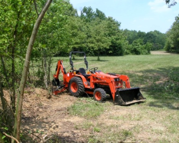

I was recently faced with exactly the same choice and being new to tractors had no prior knowledge on such things as Shuttle Shifts and HST. I started my search on a Chinese tractor, moving to Kioti for the quality comparing the CK20 and LB1914 and opting in the end for the LB1914 for such reasons as the size, weight, which helps keep the feet on the ground for the heavy jobs, and just a touch little more PTO horsepower, which I probably can not notice, and, of course, cost.
My tight clearances ruled out bigger machines and the LB1914 has proven to be extremely happy heading up and down my hills and valleys pulling a rotary cutter or mower, moving whatever I ask from once place to another with the loader over which I think the visibility is just fine, and digging out trees, such as the attached photograph, even stumps.
Of course a bigger tractor would mean bigger attachments but using a five-foot mower may mean that I have to take a couple or three more turns around the fields than with a six foot mower to get the job done, but it is seat time, which is supposed to be enjoyable, so that is certainly not a problem.
KRK
