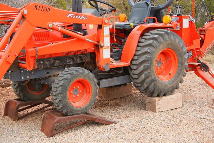

You need a Graham Portable Inspection Pit (Pat. Pending; see photo) to find whatever IS there! Comes with free red flag (illustrated) to attach to steering wheel to indicate tractor should not be operated (lest we forget).
Pit available by email delivery, $99.99, money orders only!
