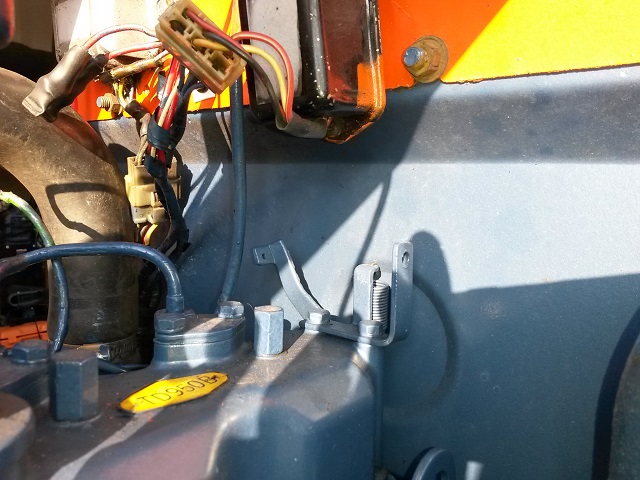

Lever and bracket are there on the rear of the engine, just no cable assembly running to the dash:
1) How useful is decomp? Should I bother pursuing the cable?
2) Any idea of part number / availability of the cable assembly? I looked through the entire engine and chassis sections of the parts diagrams and didn't see it.

Okay, just found it. In electrical for some reason (Electrical --> Electricity System 1 Group). 35240-34701 WIRE, DECOMPRESS ~$11. Any feedback on the usefulness of decompression on the 1914's engine or similar still appreciated.
   / LB1914 decomp cable #3
This decompression lever holds some of the valves open so it's easier to spin the engine to start it. With a functioning electrical starter, decomp is totally unnecessary and may cause additional wear. Small sailboat engines (like under 20 hp) frequently have a decomp lever for manual starting, if you have a dead battery, for example. The technique is to spin the engine as fast as possible with a hand crank (decompression open) and then snap the decomp closed; hopefully spinning momentum is enough to carry through the next compression stroke and the engine will "catch." Personally, I never succeeded in starting a cold engine this way without an extra pair of hands. With a tractor on land, you should always have better options than hand cranking (like a charger or jumpers). A cruising sailboat in a remote anchorage with dead batteries may have no other options. I assume that engine was sold for other applications where that lever made more sense.

Injecting, yes. The IP and injectors work the same regardless of the decpomp lever position. I could hear the injectors fire when when I hand-cranked my old boat. Don't know what happens to to the fuel, exactly, but I suspect most of it exits through a manifold. You won't hand crank many revs, so there isn't much fuel involved.

I guess I'll forgo the decomp cable for now. Could always rig up something temporary with string if I really needed it.
   / LB1914 decomp cable #7
Id get the cable and set it up. Might come in handy. I cant see it hurting the engine.
   / LB1914 decomp cable #8
I'd leave it as is. Why spend money on and clutter things up with something you'll never use? This is a left-over from some other application for that motor. Even when I used a decomp lever, I never had a cable, I just flipped it with my hand.

Skipping it for now since I haven't needed it yet and since it's rig-able in a pinch. I've got the part number and an idea of cost if I ever need it.
