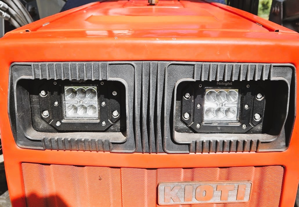

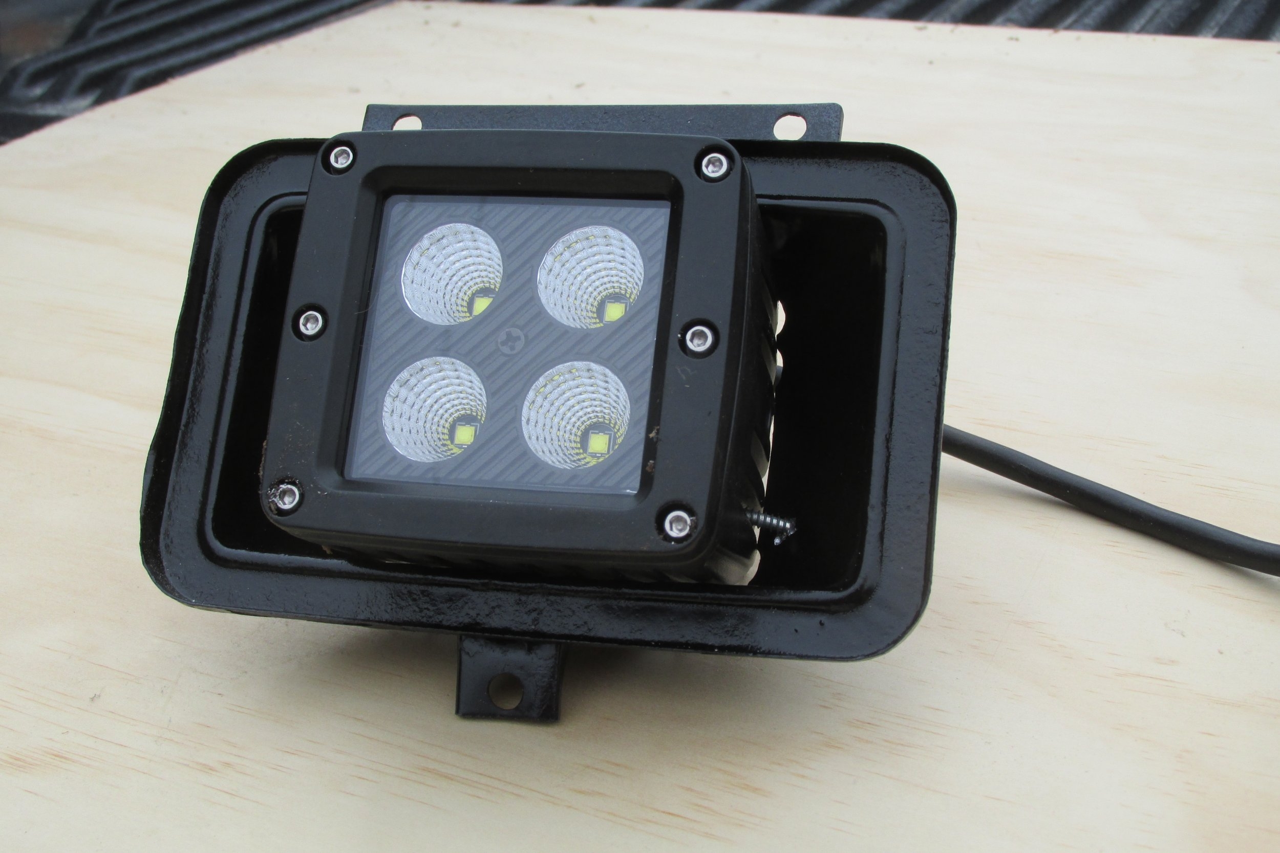

Parts for my tractor are starting to be in short supply. When I discovered that the headlights assembly needed replacement, I could find only one, so I fabricated an assembly to house a pair of LED lights. Initially, I wired the new lights through an addon switch with an inline fuse. Checking every wire in the harness I found that factory switch's two ON settings resulted in only 9 to 11 volts at the headlight end of the harness so I could not use that switch. One wire in the harness has 12.7 VDC at all times. Not being an EE, I fail to understand why the voltage is stepped down. Last night when turning off the replacement switch, it felt warm. Since this is a switch that I simply found in my workshop, it may need to be replaced.

This is the replacement headlights

Did you just mount these lights to a plate, or did you build some sort of housing? Have been thinking of doing something similar on my LK for a while now.
   / LB1914 Corroded Headlights
Yes, I mounted the lights to a board which I painted flat black. This pair of LED lights cost $18 and the output is at least equal to the original.

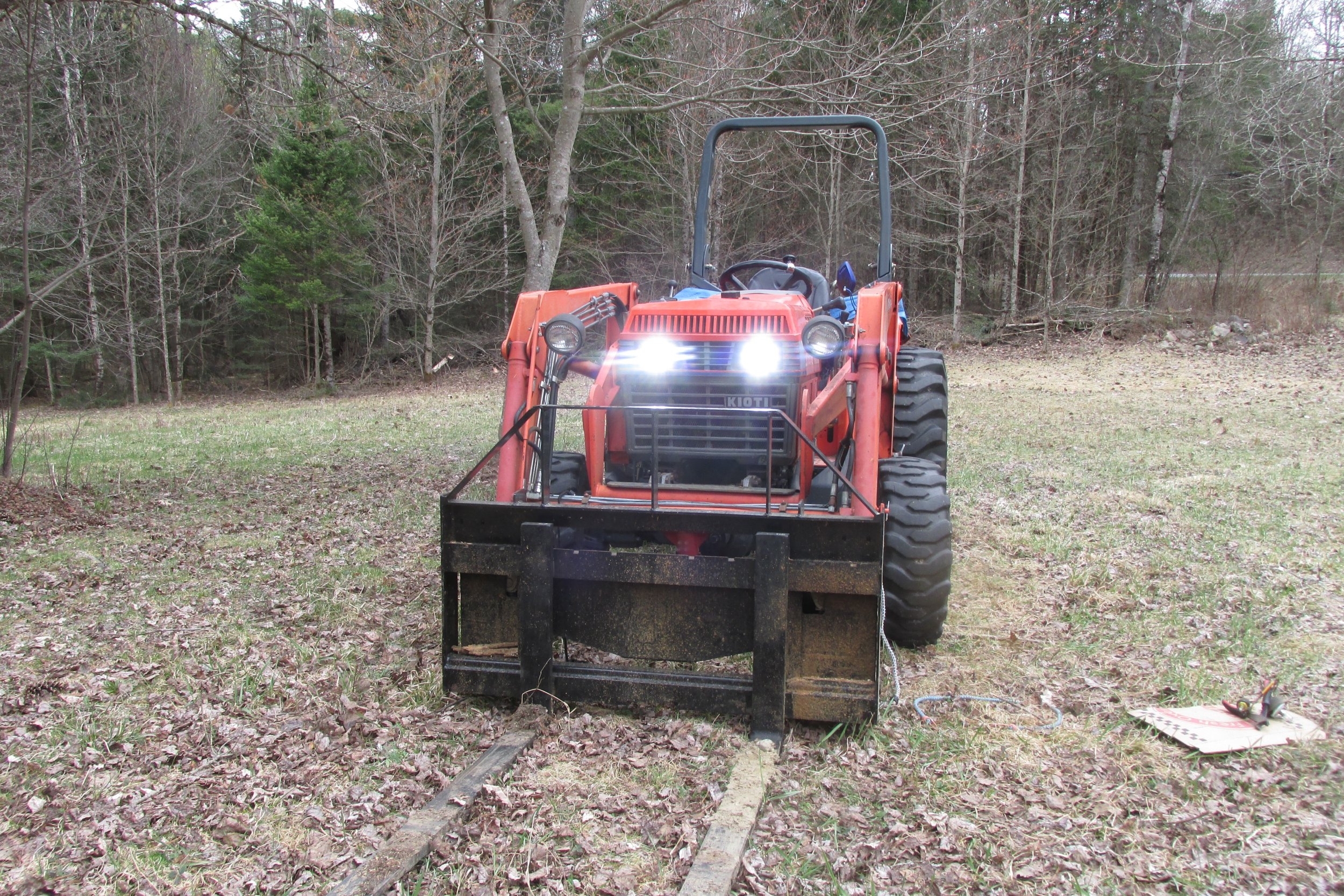

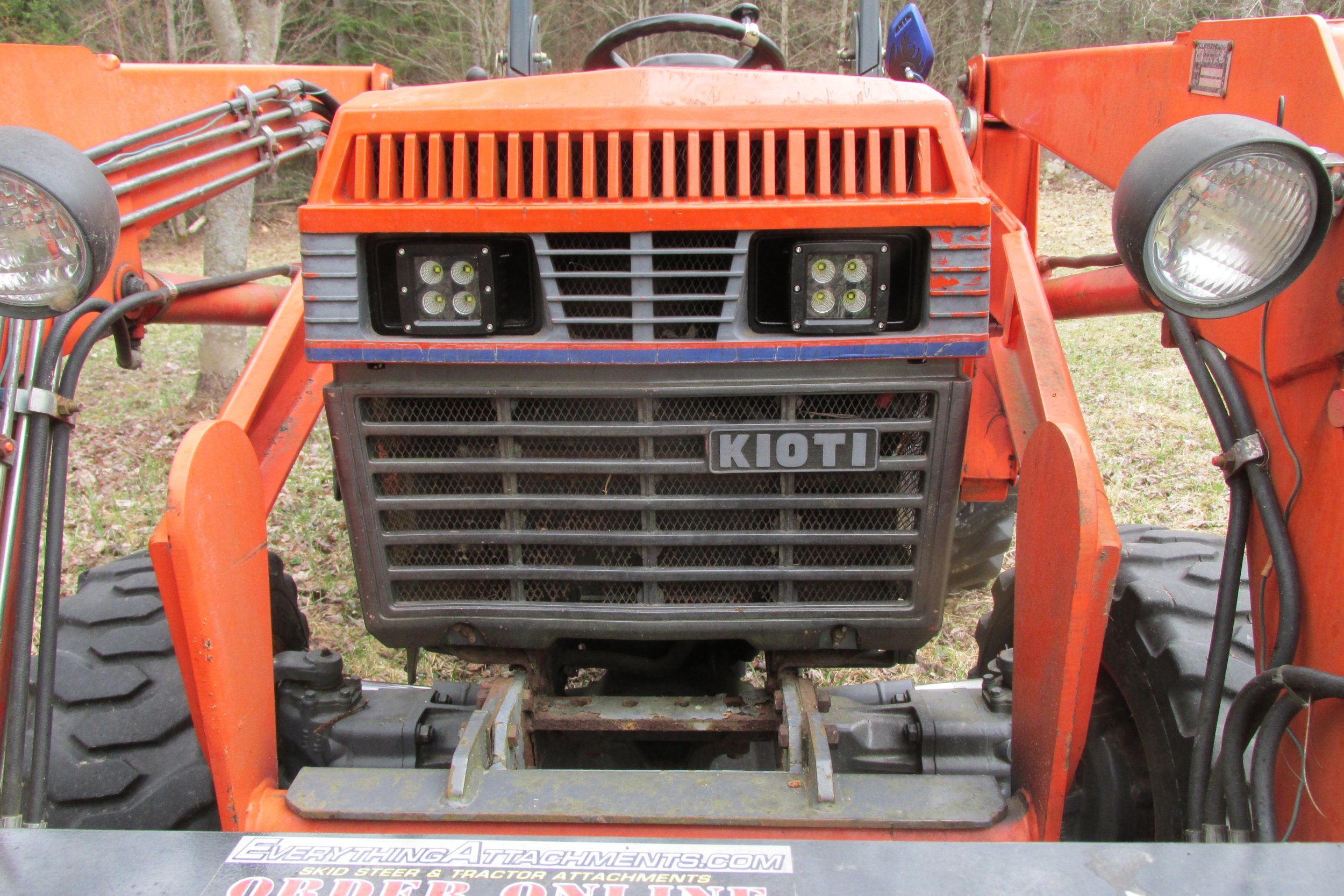

Thanks for the inspiration, just finished upgrading the lights on my LK3054 (well, for further inspiration the lens broke this past winter on one of them). I took the old lights, and modified them to mount a HF LED flood. Way brighter than those old halogens!
Thinking of replacing the ones on the loader arms with LED spots.
