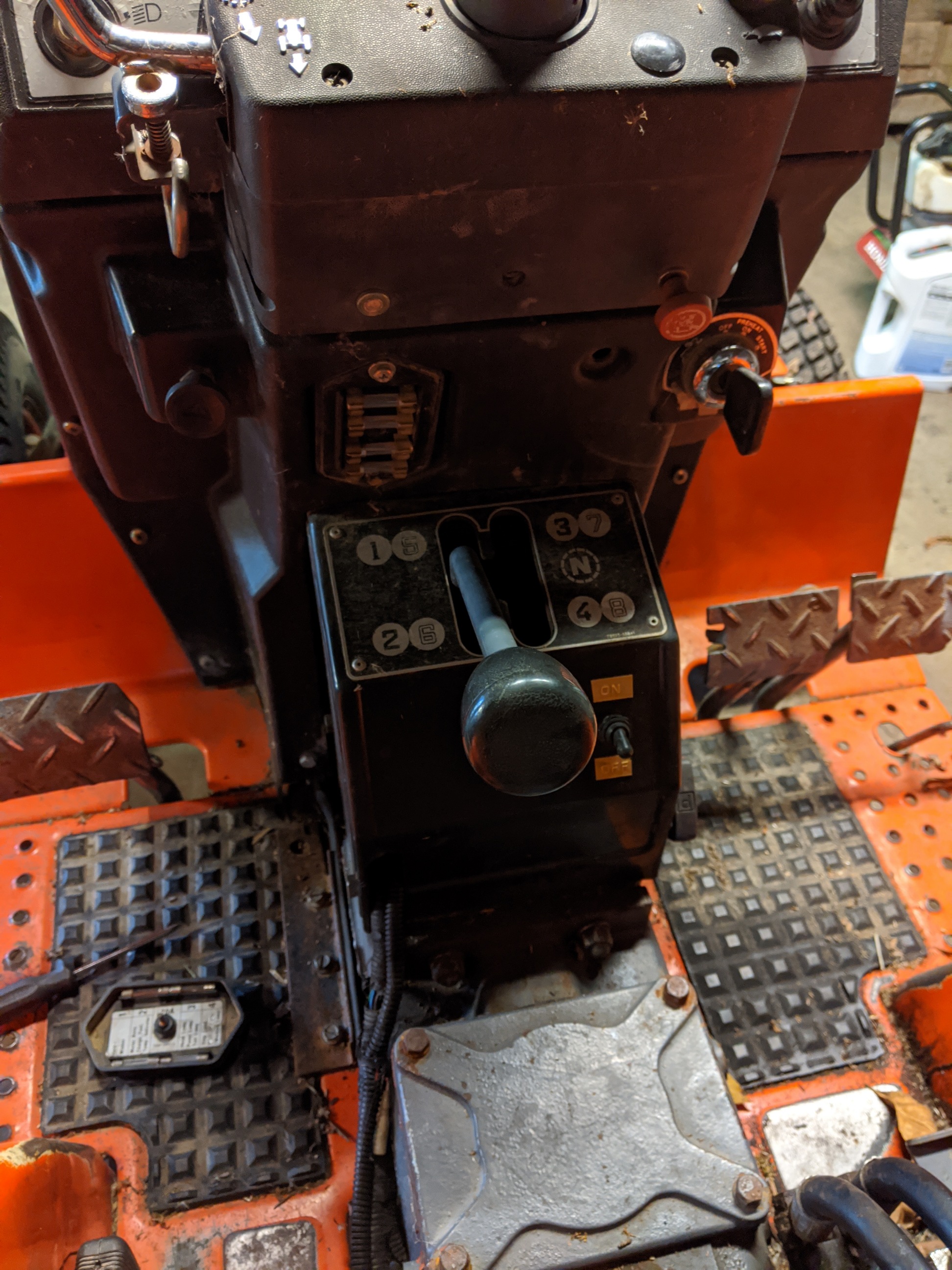

I went into the barn yesterday and my LB1914 was making a clicking noise. It sounds like it is coming from behind the dash area and sounds like a relay or turn signal clicking. Two day ago it was not making this noise, so not sure when it started. I checked all the light switches and nothing had been moved. All systems seem to be functioning properly. The only way to get the clicking to stop was to disconnect the battery. To shut down this tractor you have to manually pull a knob, nothing electronic. If a relay fails, would it start clicking like this? Maybe a mouse chewed through a wire? I am going to have to remove the plastic below the dash area to get to the noise. I was hoping maybe someone had a similar problem and could tell me what is going on. Thanks.

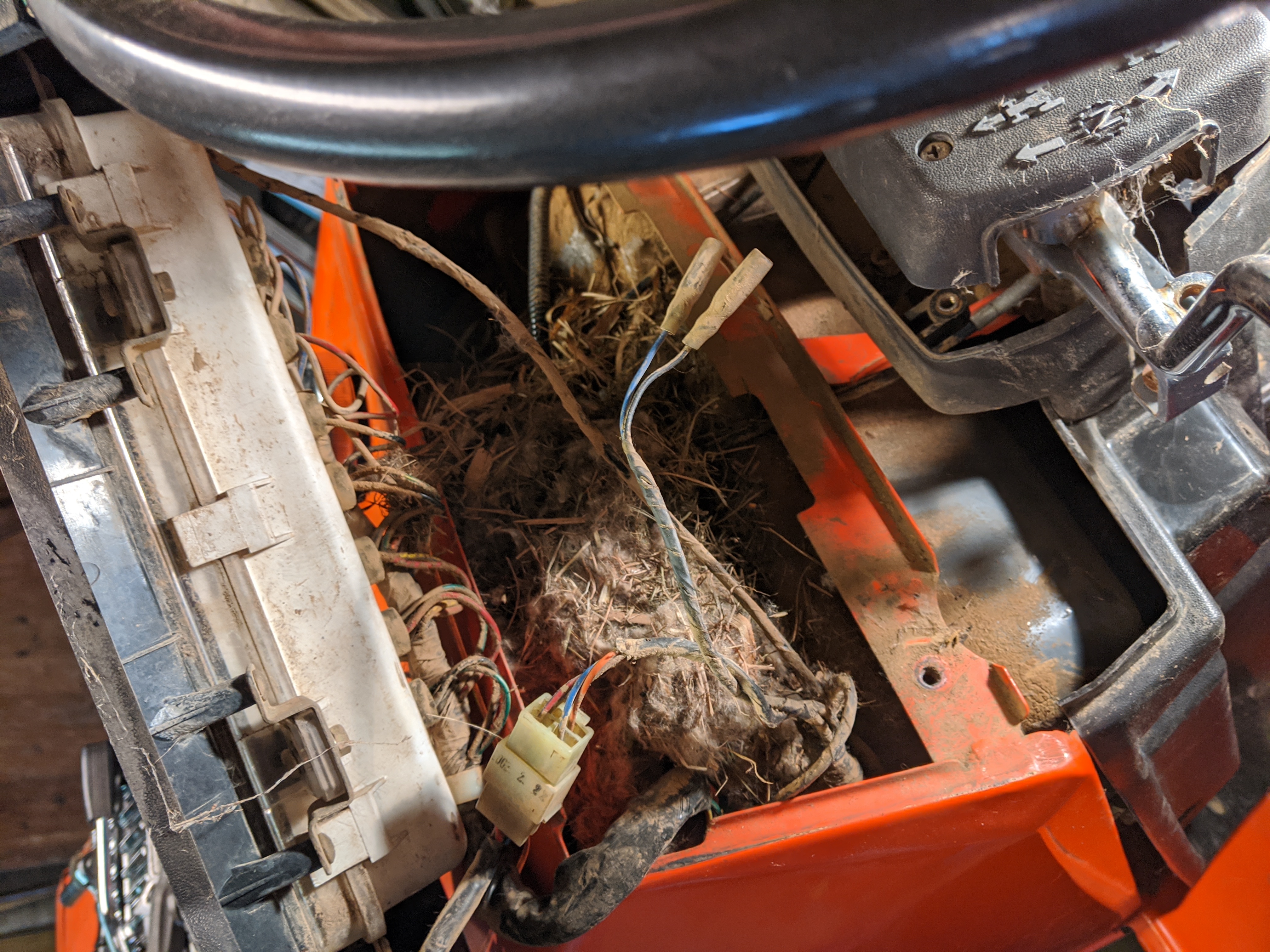

If you suspect rodents, it's real easy to remove the dash cluster (4 screws?). There's a nice void back there full of wires. There also access for the rodents on the gap between the fuel tank and side sheet metal. To take it all the way off unhook the tach cable and maybe 4-5 connectors. I had to do this all the time on my old LB1914 due to rodent damage.

I finally got into the dash today. Huge mouse nest is what I found. Not sure if that was responsible for the clicking sound. Didn't see any exposed wires but it could be anywhere. I still have the fuse pulled, will need to put that back in and see what happens.

I am surprised you did not see any chewed wires. Thanks for the update!

Get more aggressive on rodent control. I would be away from my old LB1914 for weeks and a rat chewed through many of those wires. They have access going up either side of the gas tank. This old shed had pony biscuits from the previous owner who kept a few horses. The rat took them during the winter and piled them above that area I kid you not. I had to repair a bunch of wires twice until I finally traded it. I would take the dash out every time I would leave the property.
