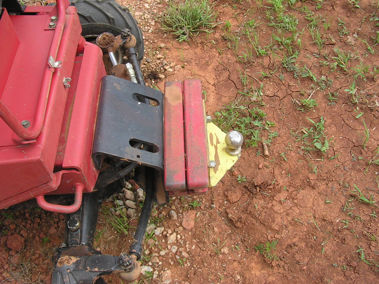

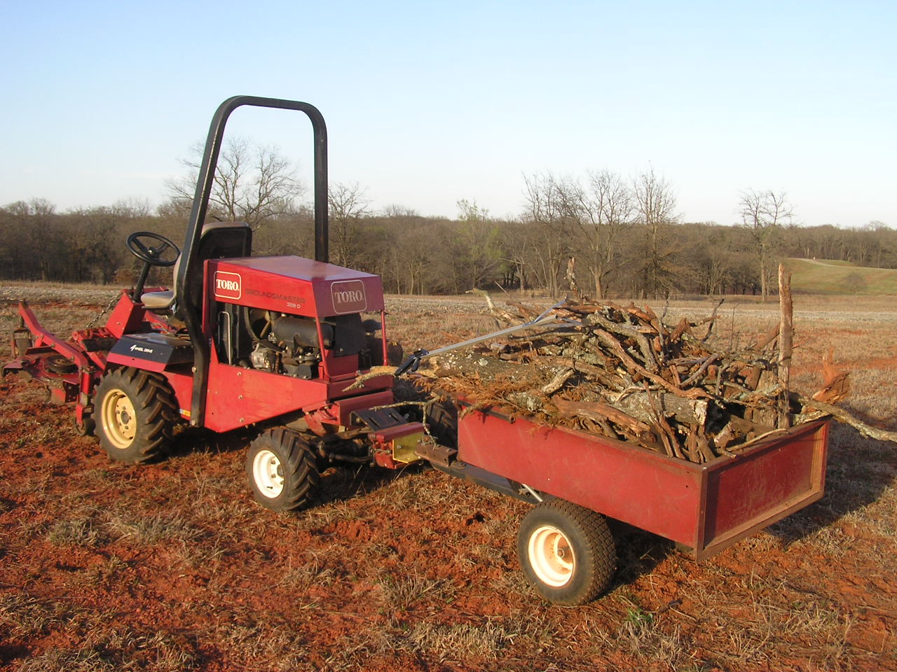

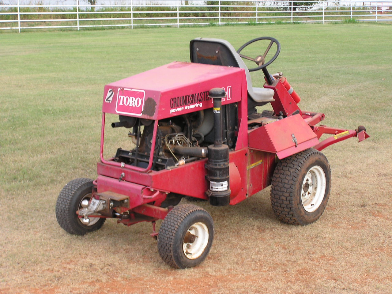

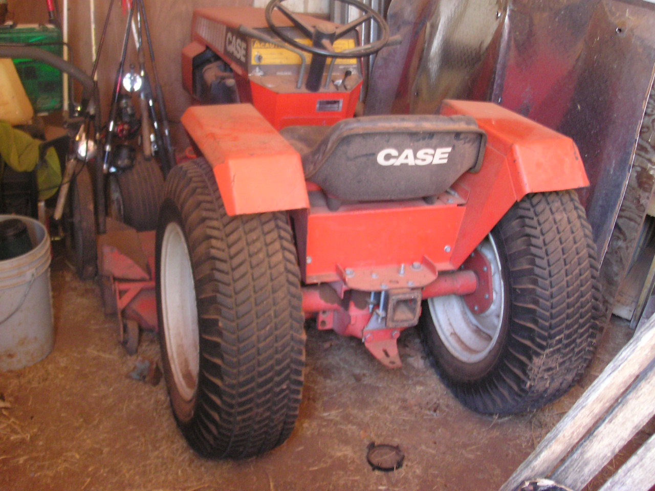

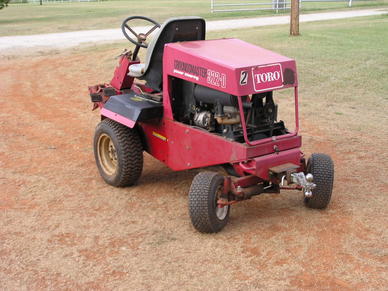

I always added a ball or receiver to the ones I owned over the years.
This receiver is just clamped on after drilling 4 holes in that plate:
This is what I have now, angle iron bolted to the weights:
This is before I put the loader on the 322D:
