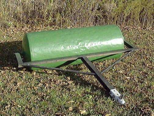

check out this photo, I made this roller up using an old water tank. It is 5'x2' and weighs in at 1200lbs when full. Really does a nice job pushing the rocks back down in the spring.

Nice job, Von. What do you fill it with, plain water? I've got an old pressure tank lying around; maybe this will turn out to be a good use for it.
mark

Yeh, just water. I have a neighbor who has one filled with old motor oil. It came with his old house. Must have been a ***** to move. I would like to redo mine with a 2'x5'x1/4" pipe and just use the ends from the tank. I don't know where to get any pipe that size, if you see any let me know!
