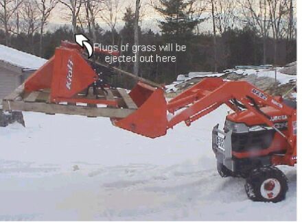

Do the areators eject the soil plugs ?

   / Lawn Plug Areator... #10
<font color="blue">Do the areators eject the soil plugs ? </font>
Each time the aerator tine goes around it picks up a plug. Each time a new plug is picked up the previous plug is ejected and the process starts all over.

<font color="blue">I purchased one from Ken in Kubota Orange and it works excellently. It works much better than a Kioti Orange one, that is for certain. </font>
Picture is credited to the junkman. (Aerator look familiar? Busted!) /forums/images/graemlins/grin.gif /forums/images/graemlins/shocked.gif /forums/images/graemlins/grin.gif /forums/images/graemlins/shocked.gif /forums/images/graemlins/grin.gif
