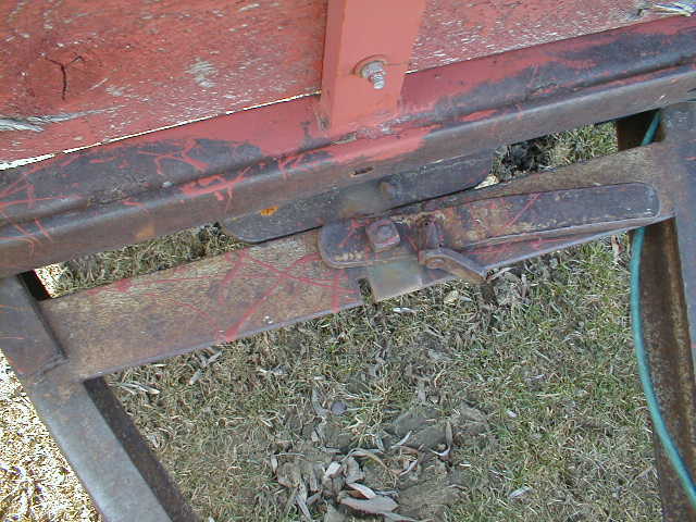

Here's a couple pics of my tilt bed latch. Sorry about all the dirt. We're in the mud season now as the snow melts.

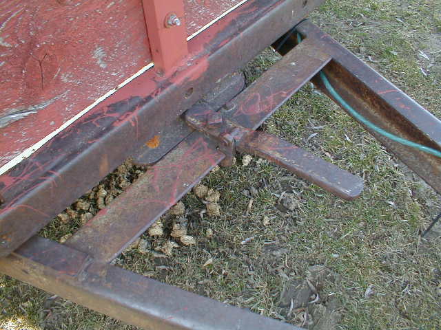

Here are two pictures. The first one shows the latch closed. You'll notice that the catch that holds the latch in place is held in place only by gravity.
The second picture show the latch open ready to tilt the bed.
I'm looking for a quick, easy way to keep the latch more secure when I'm going down the road.

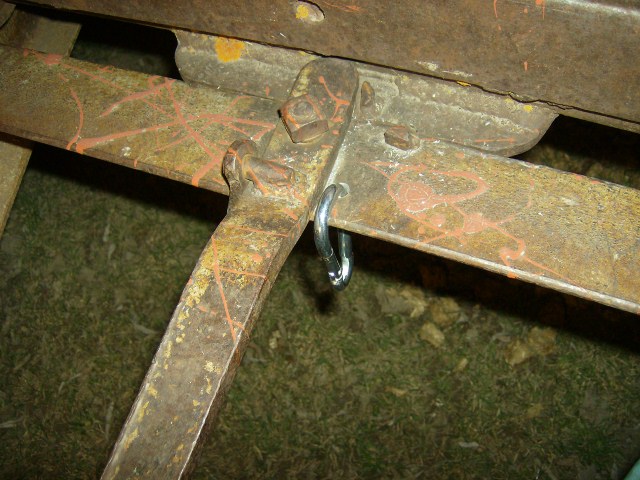

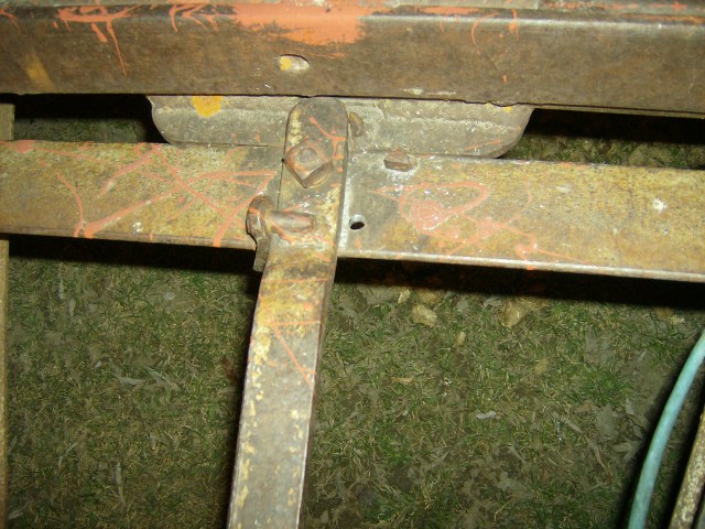

Drill a hole, in the angle iron, opposite side of the slot that the gravity latch drops into on that same angle iron. If 3/8" hole, you could use a padlock, hitch pin or a bolt/nut assembly that would keep the latch handle from rotating open. This would be very, very simple and easy. If one looks at it like a clock, and the pivot point of the latch is the center on the hour hand, then your gravity latch is at 7:00 and my suggestion for the hole would be at the 4:30-5:00 position. Hope this helps the visual picture I have in my head.
I did just as you suggested. The best solutions are often the simplest, aren't they.
Thanks
I've attached some pictures.

Hey, that looks good. I like your spring loaded clip, too.
I wanted something that could be put on or taken off with one hand.
The lock or bolt idea was a good one, but with my luck I'd lose the key to the lock or forget the wrenches for the bolt when I get to where I'm going. The spring clip seems to be every bit as secure as the other options.

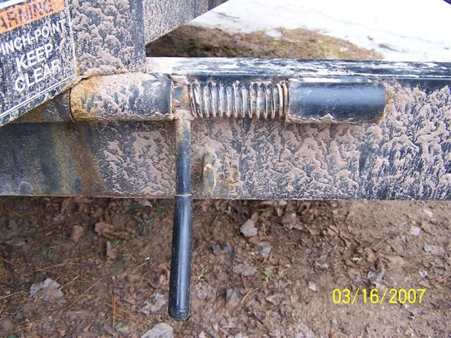

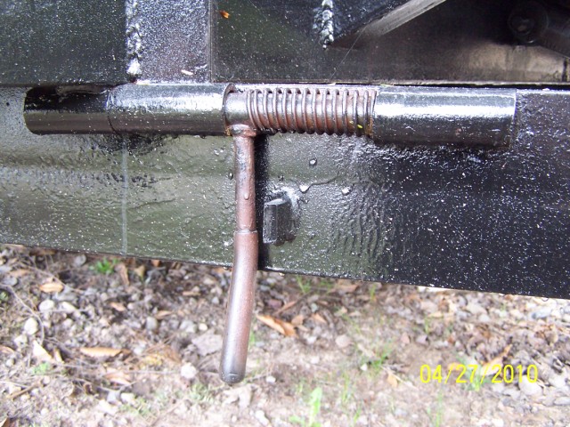

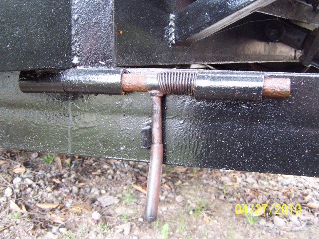

   / Latching a tilt trailer? #10
Hey hey, a 3 year old thread gets a revival! I like George's Tilt latch. Anyone know where I can buy one prefabricated?
